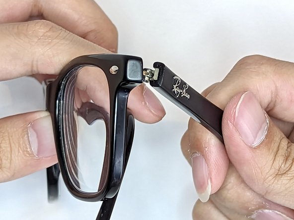

    • Remove the screw holding the broken arm by turning it counterclockwise.
  2. How to Replace the Arm of Standard Hinge Eyeglasses: crwdns2935265:02crwdnd2935265:01crwdnd2935265:01crwdne2935265:0
    • Carefully set the screw aside and discard the broken arm.

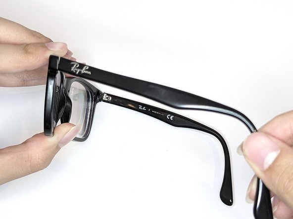

    • Align the joints of the new arm with the joint connected to the frame.
    • The frame joint should be in between the two joints of the arm.

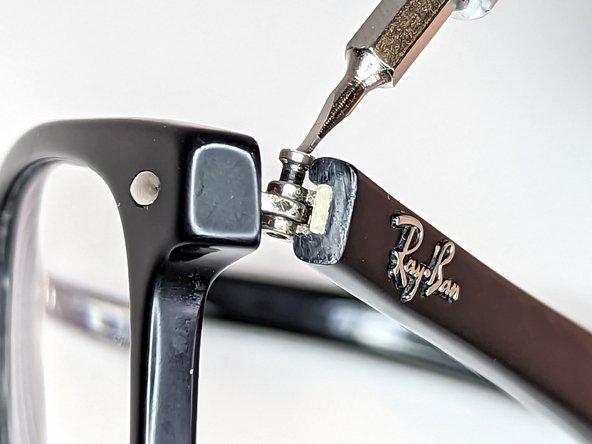

  5. How to Replace the Arm of Standard Hinge Eyeglasses: crwdns2935265:05crwdnd2935265:01crwdnd2935265:03crwdne2935265:0 How to Replace the Arm of Standard Hinge Eyeglasses: crwdns2935265:05crwdnd2935265:02crwdnd2935265:03crwdne2935265:0 How to Replace the Arm of Standard Hinge Eyeglasses: crwdns2935265:05crwdnd2935265:03crwdnd2935265:03crwdne2935265:0
    • Insert the screw in the hinge and lightly tighten by turning the screw clockwise.
    • Make sure all parts are aligned and that the new arm is not angled.
    • You may want to put the glasses on to make sure the arm is positioned properly.
