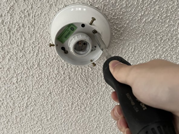

  3. How to Replace and Install Ceiling Light Fixtures: crwdns2935265:03crwdnd2935265:01crwdnd2935265:03crwdne2935265:0 How to Replace and Install Ceiling Light Fixtures: crwdns2935265:03crwdnd2935265:02crwdnd2935265:03crwdne2935265:0 How to Replace and Install Ceiling Light Fixtures: crwdns2935265:03crwdnd2935265:03crwdnd2935265:03crwdne2935265:0

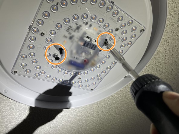

    • Remove the screws holding the old light fixture's housing with a screwdriver
    • Carefully pull the old light fixture and its wiring down.
    • Without the screws, the housing will no longer be attached to the ceiling. Hold the housing until it hangs gently to avoid injury.

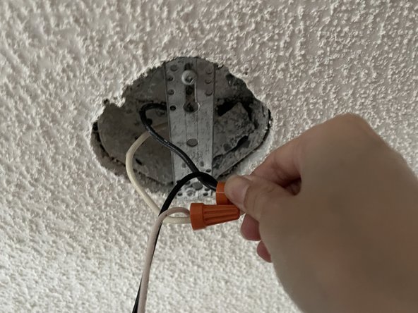

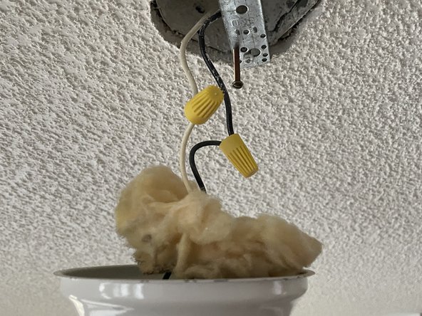

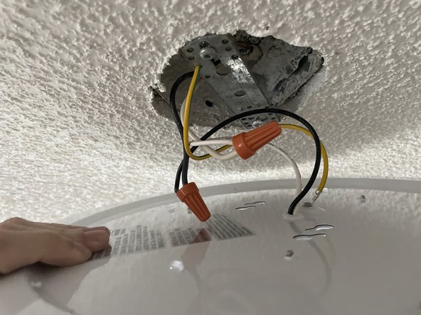

  4. How to Replace and Install Ceiling Light Fixtures: crwdns2935265:04crwdnd2935265:01crwdnd2935265:03crwdne2935265:0 How to Replace and Install Ceiling Light Fixtures: crwdns2935265:04crwdnd2935265:02crwdnd2935265:03crwdne2935265:0 How to Replace and Install Ceiling Light Fixtures: crwdns2935265:04crwdnd2935265:03crwdnd2935265:03crwdne2935265:0
    • Remove the old wire connectors and untwist the wires.
    • The old light fixture will completely detach. Prevent it from falling by holding onto the housing.

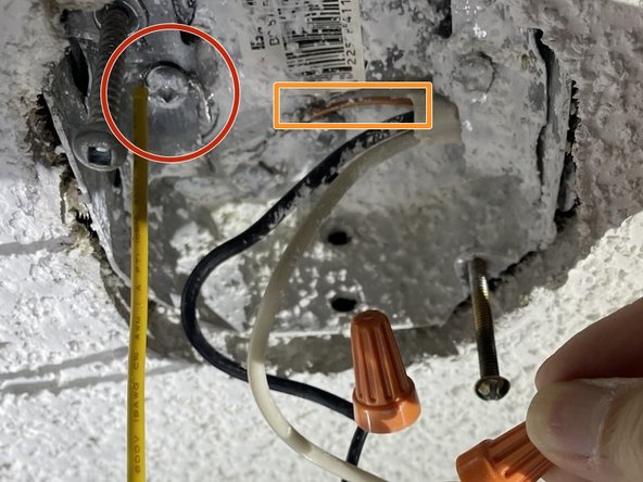

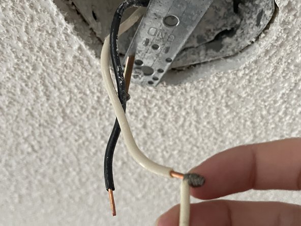

  5. How to Replace and Install Ceiling Light Fixtures: crwdns2935265:05crwdnd2935265:01crwdnd2935265:03crwdne2935265:0 How to Replace and Install Ceiling Light Fixtures: crwdns2935265:05crwdnd2935265:02crwdnd2935265:03crwdne2935265:0 How to Replace and Install Ceiling Light Fixtures: crwdns2935265:05crwdnd2935265:03crwdnd2935265:03crwdne2935265:0
    • Match the new ceiling light wiring to your home’s existing wires.
    • Link each pair with wire connectors by placing the exposed ends inside, and twisting down until tight.
    • If your home does not have a corresponding grounding wire to connect to:
    • You must connect the fixture ground wire to the ground screw of the ceiling crossbar.
    • Or you must connect the fixture ground wire to the house ground wire (the bare copper wire without any insulation)

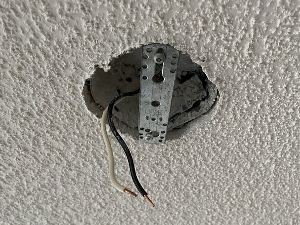

  6. How to Replace and Install Ceiling Light Fixtures: crwdns2935265:06crwdnd2935265:01crwdnd2935265:03crwdne2935265:0 How to Replace and Install Ceiling Light Fixtures: crwdns2935265:06crwdnd2935265:02crwdnd2935265:03crwdne2935265:0 How to Replace and Install Ceiling Light Fixtures: crwdns2935265:06crwdnd2935265:03crwdnd2935265:03crwdne2935265:0
    • Find the proper alignment for the holes of the new housing with the ceiling's mounting bar.
    • Carefully place all wiring into the electrical box or empty space within the ceiling.
    • Secure the housing to the ceiling with two screws, tightening them firmly with a screwdriver.

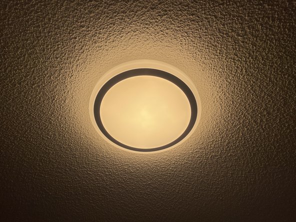

  8. How to Replace and Install Ceiling Light Fixtures: crwdns2935265:08crwdnd2935265:01crwdnd2935265:02crwdne2935265:0 How to Replace and Install Ceiling Light Fixtures: crwdns2935265:08crwdnd2935265:02crwdnd2935265:02crwdne2935265:0
    • Turn the main power back on and watch as your handiwork lights up the room!
