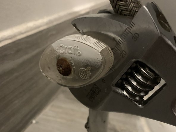

  4. How to Replace a Toilet's Shut-Off Valve: crwdns2935265:04crwdnd2935265:01crwdnd2935265:02crwdne2935265:0 How to Replace a Toilet's Shut-Off Valve: crwdns2935265:04crwdnd2935265:02crwdnd2935265:02crwdne2935265:0
    • Turn the toilet shut off valve counter clockwise.
  5. How to Replace a Toilet's Shut-Off Valve: crwdns2935265:05crwdnd2935265:01crwdnd2935265:02crwdne2935265:0 How to Replace a Toilet's Shut-Off Valve: crwdns2935265:05crwdnd2935265:02crwdnd2935265:02crwdne2935265:0
    • Using the wrench, disconnect the tank hose from the pipe by turning the wrench clockwise until the hose is completely disconnected from the pipe.
  6. How to Replace a Toilet's Shut-Off Valve: crwdns2935265:06crwdnd2935265:01crwdnd2935265:02crwdne2935265:0 How to Replace a Toilet's Shut-Off Valve: crwdns2935265:06crwdnd2935265:02crwdnd2935265:02crwdne2935265:0
    • Rotate the toilet shut-off valve clockwise with the wrench until the valve comes off from the pipe.
    • Slide the new valve onto the pipe and tighten the valve onto the pipe with the wrench.
    • Using the wrench reconnect the hose to the pipe by rotating the wrench counter clockwise.
