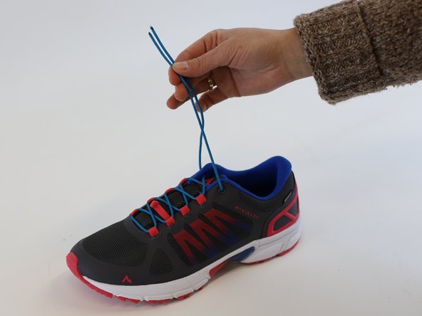

    • Locate the damaged part of the old draw cord in your shoe.
    • Prepare for removing the plastic stopper, by cutting the lace behind the stopper.
    • Tip: If the cord is tangled or stuck, use a safety pin or needle to carefully guide it out.

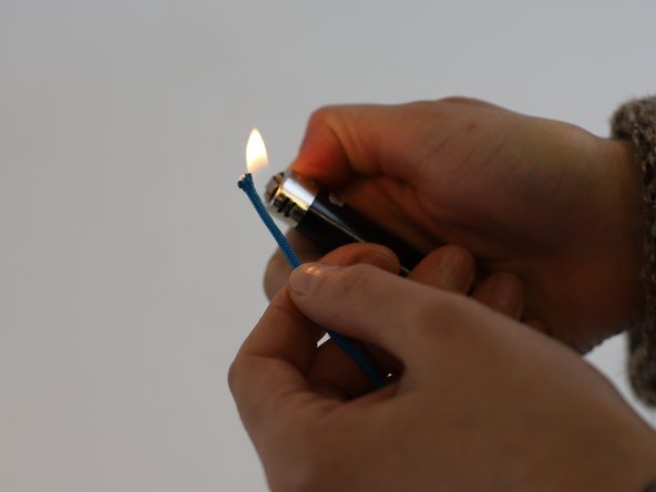

  3. How to Replace a Speedlace With a Stopper, Seal the new lace tips: crwdns2935265:03crwdnd2935265:01crwdnd2935265:03crwdne2935265:0 How to Replace a Speedlace With a Stopper, Seal the new lace tips: crwdns2935265:03crwdnd2935265:02crwdnd2935265:03crwdne2935265:0 How to Replace a Speedlace With a Stopper, Seal the new lace tips: crwdns2935265:03crwdnd2935265:03crwdnd2935265:03crwdne2935265:0
    • If you use a replacement lace cord, which doesn't have lace tips or where the lace tips are too big, you will need to seal (melt) the tips before threading them through the stopper.
    • TAKE CARE!: Use a lighter to slightly melt the material of the lace tip. The flame does not need to touch the lace directly, only to melt the fibres through indirect heat. Only do this in a safe environment and under supervision if needed.
    • While the lace tips are still semi-melted, press each tip together with your fingers while twisting gently to create a thin, rounded ending.

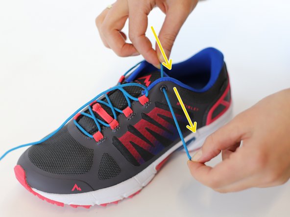

  4. How to Replace a Speedlace With a Stopper, Re-lace the shoe: crwdns2935265:04crwdnd2935265:01crwdnd2935265:03crwdne2935265:0 How to Replace a Speedlace With a Stopper, Re-lace the shoe: crwdns2935265:04crwdnd2935265:02crwdnd2935265:03crwdne2935265:0 How to Replace a Speedlace With a Stopper, Re-lace the shoe: crwdns2935265:04crwdnd2935265:03crwdnd2935265:03crwdne2935265:0
    • Insert the replacement lace into the first laceholder.
    • Check that you've got the same length on both sides before continuing - do this by holding both ends together and pulling up high.
    • Continue threading the next laceholder pair, and then the next, until the top and check whether the lace has been threaded correctly.
    • Tip: Make a final check if the lace length is similar on both sides.

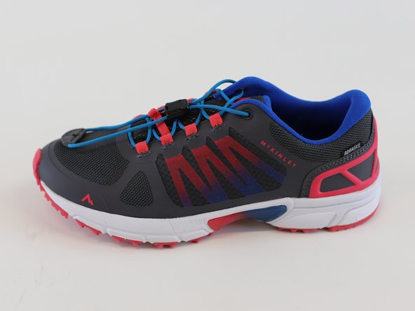

  5. How to Replace a Speedlace With a Stopper, Re-thread the lace stopper: crwdns2935265:05crwdnd2935265:01crwdnd2935265:03crwdne2935265:0 How to Replace a Speedlace With a Stopper, Re-thread the lace stopper: crwdns2935265:05crwdnd2935265:02crwdnd2935265:03crwdne2935265:0 How to Replace a Speedlace With a Stopper, Re-thread the lace stopper: crwdns2935265:05crwdnd2935265:03crwdnd2935265:03crwdne2935265:0
    • The next step is to re-thread the stopper onto the lace; but this can be challenging since the stopper is probably spring-loaded, and different brands use different stopper designs.
    • For this example, we used the needle of a safety pin to keep the stopper open, while threading the lace.
    • Thread in the lace tip through the opened stopper and then push the rest of the lace through.
    • Tip: If you've got issues, pushing the lace tip through the stopper, you can use a safety pin or a seam ripper for support.

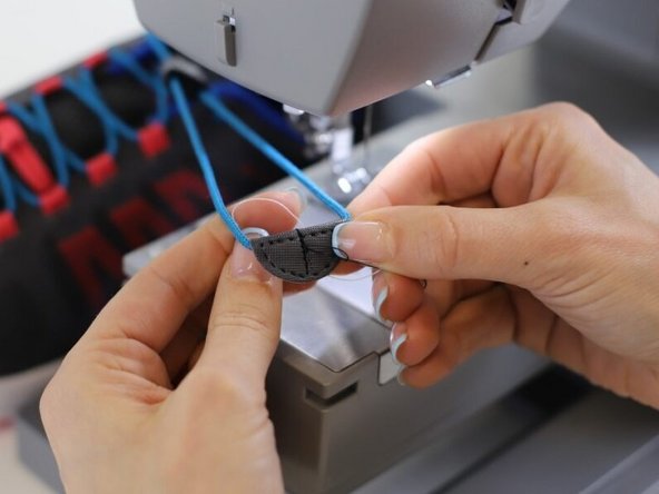

  7. How to Replace a Speedlace With a Stopper, Second fix: replacing the speedlace puller: crwdns2935265:07crwdnd2935265:01crwdnd2935265:01crwdne2935265:0
    • Use a "seam ripper" tool to remove the original stitching and open the folded fabric patch (red circle).

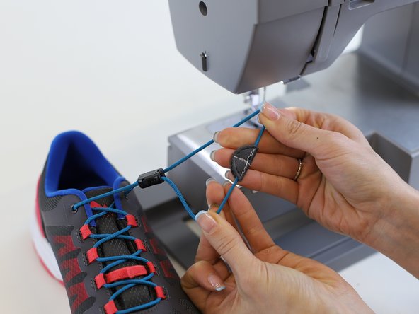

  8. How to Replace a Speedlace With a Stopper, Reattach the lace to the patch: crwdns2935265:08crwdnd2935265:01crwdnd2935265:03crwdne2935265:0 How to Replace a Speedlace With a Stopper, Reattach the lace to the patch: crwdns2935265:08crwdnd2935265:02crwdnd2935265:03crwdne2935265:0 How to Replace a Speedlace With a Stopper, Reattach the lace to the patch: crwdns2935265:08crwdnd2935265:03crwdnd2935265:03crwdne2935265:0
    • In our example, the original speedlace was connected at the ends with a fabric pulling patch. We will re-attach it in now, using the sewing machine.
    • Wrap the patch around the lace endings and place it onto the sewing machine. The open side (red circle) should point towards you.
    • Push lace endings against each other in the middle of the patch, so that there is no gap.
    • Sew along the middle of the patch with a single straight stitch. The goal is to sew through both laces at the same time, and "tack" everything in place for the next step.
