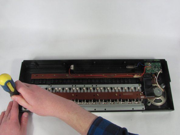

    • Remove the battery cover.
    • Remove all twelve of the 9.0 mm screws on the back cover of the device's casing using a Phillips #1 screwdriver.

    • Place your fingers in the battery compartment, and place your thumb on the back of the keyboard.
    • Grip inside battery cover and push on the back of the keyboard with your thumb.
  3. How to Replace a Speaker on a Yamaha PSS-130 Keyboard: crwdns2935265:03crwdnd2935265:01crwdnd2935265:02crwdne2935265:0 How to Replace a Speaker on a Yamaha PSS-130 Keyboard: crwdns2935265:03crwdnd2935265:02crwdnd2935265:02crwdne2935265:0
    • Replace two 9.0 mm Phillips screws to keep the keys from falling out while working on this device.
  4. How to Replace a Speaker on a Yamaha PSS-130 Keyboard: crwdns2935265:04crwdnd2935265:01crwdnd2935265:03crwdne2935265:0 How to Replace a Speaker on a Yamaha PSS-130 Keyboard: crwdns2935265:04crwdnd2935265:02crwdnd2935265:03crwdne2935265:0 How to Replace a Speaker on a Yamaha PSS-130 Keyboard: crwdns2935265:04crwdnd2935265:03crwdnd2935265:03crwdne2935265:0
