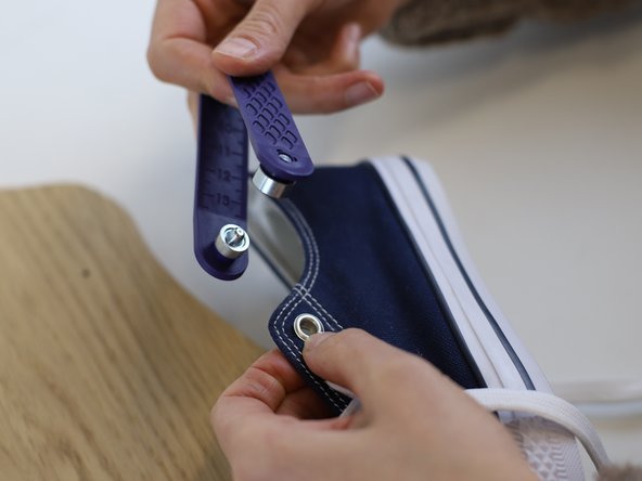

    • Prepare the eyelet, the hammer and the "punch" tool.
    • Note: Take time to understand the punch tool and match the appropriate halves of the new eyelet to the matching sides of the punch tool. One half is for the inside; the other is for the outside.
    • On the sample shown here, the yellow arrow shows the inside half; and the green arrow shows the outside half.
    • Insert the replacement eyelet to the lace hole using your fingers. Take care to insert the outside half from the outside, and the inside half from the inside.

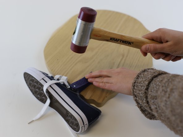

    • Tip: For the next step, we advise protecting your work surface during hammering. A wooden/plastic chopping board, or an old piece of wood will work well for this.

    • Next, position the backside eyelet half onto the punch tool, and carefully lift the tool to the eyelet hole.
    • This can be fiddly! Take your time and if the eyelet halves fall out, take care to re-install them back onto the correct sides.

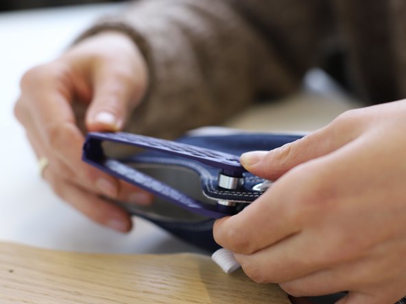

    • Close the punch tool, to keep the two halves securely together. Make sure this is in a comfortable orientation, to allow hammering onto the wooden block in the next step.

    • Start hammering! The goal is to connect the two halves together securely, but it isn't normally needed to apply lots of force. Use a soft tapping motion with the hammer and after a few taps the two halves should be connected.
    • Gently open the punch tool and check whether the two halves have connected correctly. If not: close the tool and tap a few more times, until completed.

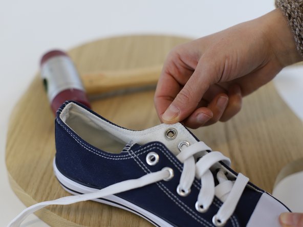

    • A correctly installed eyelet will be secure with no loose parts and no defects. Check the other eyelets for reference.
