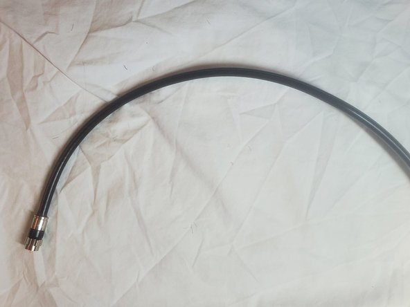

    • Use a cable cutter to cut your desired length of cable.
    • Cut both ends of the cable at 90 degrees, meaning the cutter and the cable should be positioned at 90 degree of one another.

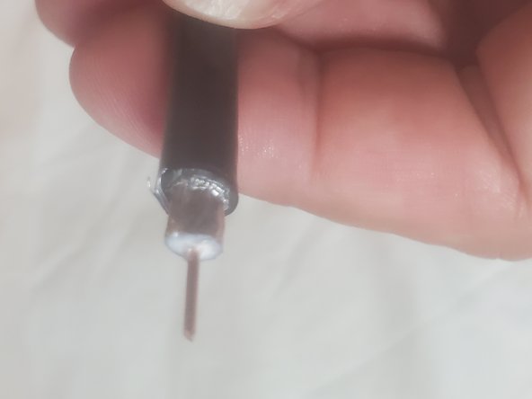

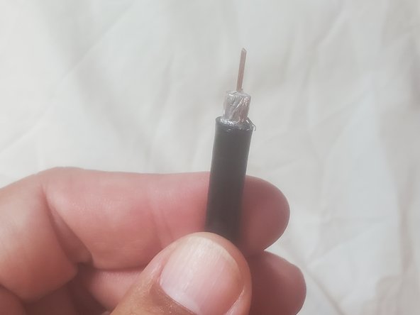

    • Use a RG-6 coaxial cable stripper to strip each end of the cable.
    • Position the end of cable inside the stripper and rotate it around the cable in a clockwise motion three times. Then, do one full turn counterclockwise.
    • Repeat this on the other end of the cable.
    • After stripping the ends, remove the two pieces of shield cable from the cable.
  3. How to Replace a RG-6 Coaxial Cable Connector: crwdns2935265:03crwdnd2935265:01crwdnd2935265:03crwdne2935265:0 How to Replace a RG-6 Coaxial Cable Connector: crwdns2935265:03crwdnd2935265:02crwdnd2935265:03crwdne2935265:0 How to Replace a RG-6 Coaxial Cable Connector: crwdns2935265:03crwdnd2935265:03crwdnd2935265:03crwdne2935265:0
    • Using your fingers, fan the internal wires out.
    • Mold the braided wires into a flower shape.
    • Remove any excess braid from the core side of the cable (the gold color part).

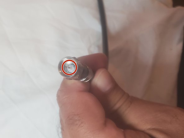

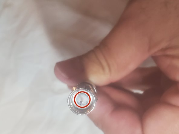

    • Insert the cable into the thin part of the RG-6 connector.
    • Gently push the cable into the connector. Do not bend or fold the gold portion of the cable.
    • Make sure that the cable's insulator (white portion) and the inside of the connector are flush.

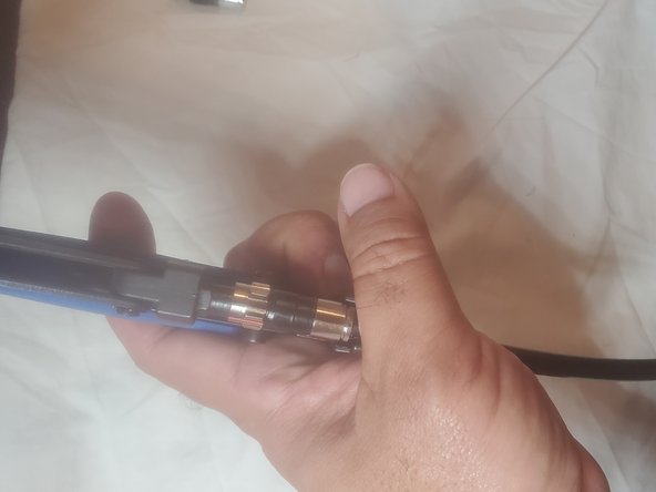

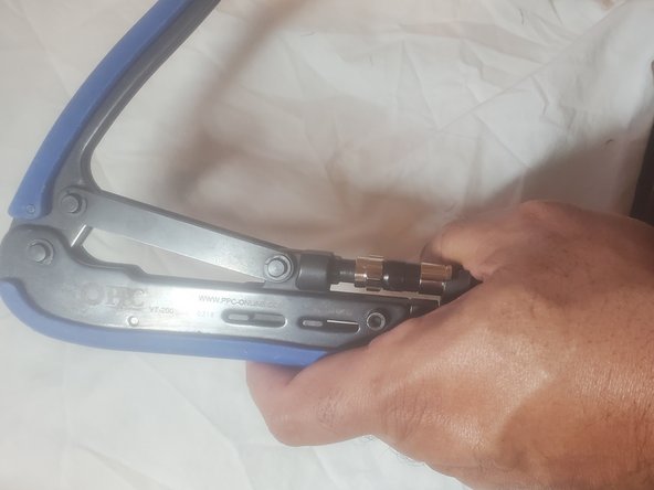

    • To crimp the end of the cable, place one end of the cable into the cable slot of the crimper.
    • Insert one cable end into the appropriate slot for the connector in the crimper.
    • With your thumb, hold down the cable so it will not come out of the cable slot.
  6. How to Replace a RG-6 Coaxial Cable Connector: crwdns2935265:06crwdnd2935265:01crwdnd2935265:01crwdne2935265:0

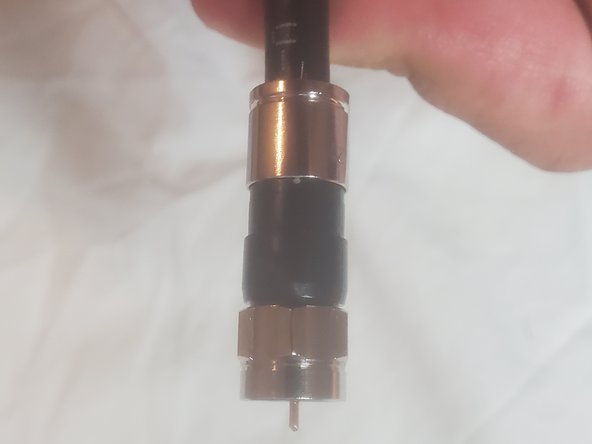

    • To crimp the connector to the cable, gently pull down the crimper's lever.
    • There is no need to do it multiple times.
    • Secure the connector to both ends of the cable.
  7. How to Replace a RG-6 Coaxial Cable Connector: crwdns2935265:07crwdnd2935265:01crwdnd2935265:03crwdne2935265:0 How to Replace a RG-6 Coaxial Cable Connector: crwdns2935265:07crwdnd2935265:02crwdnd2935265:03crwdne2935265:0 How to Replace a RG-6 Coaxial Cable Connector: crwdns2935265:07crwdnd2935265:03crwdnd2935265:03crwdne2935265:0
    • Check that there is no braid hanging outside of the connector.
    • Loose braids can cause problems with signals.
    • Check that the cables insulation is flush with the connector.
    • If there is loose braid, you'll have to start over from Step 1.
