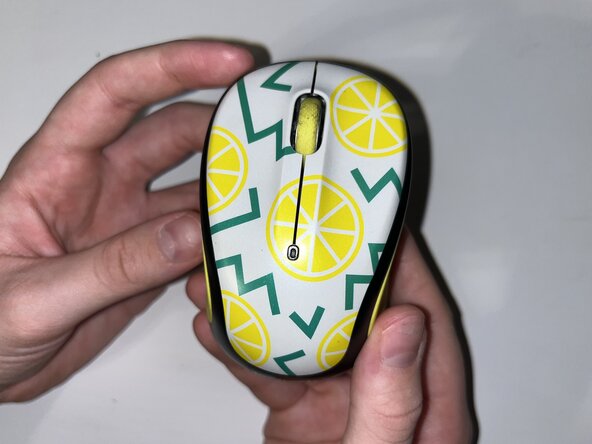

How to Replace a Logitech M325c Scroll Wheel
  1. How to Replace a Logitech M325c Scroll Wheel, Scroll Wheel: crwdns2935265:01crwdnd2935265:01crwdnd2935265:01crwdne2935265:0

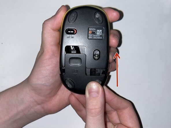

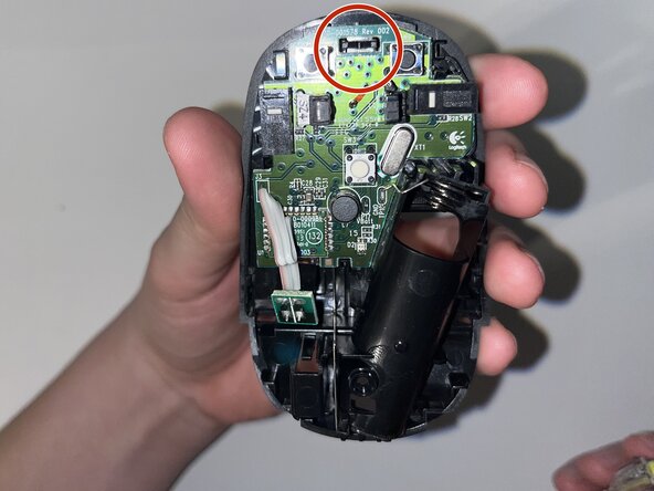

    • Slide the mouse’s case open to reveal the battery compartment.
  2. How to Replace a Logitech M325c Scroll Wheel: crwdns2935265:02crwdnd2935265:01crwdnd2935265:03crwdne2935265:0 How to Replace a Logitech M325c Scroll Wheel: crwdns2935265:02crwdnd2935265:02crwdnd2935265:03crwdne2935265:0 How to Replace a Logitech M325c Scroll Wheel: crwdns2935265:02crwdnd2935265:03crwdnd2935265:03crwdne2935265:0
    • Remove the AA battery.

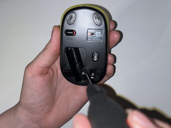

    • Peel off the sticker at the bottom of the compartment.
    • Remove the single Phillips screw.

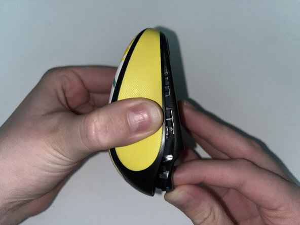

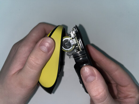

  3. How to Replace a Logitech M325c Scroll Wheel: crwdns2935265:03crwdnd2935265:01crwdnd2935265:03crwdne2935265:0 How to Replace a Logitech M325c Scroll Wheel: crwdns2935265:03crwdnd2935265:02crwdnd2935265:03crwdne2935265:0 How to Replace a Logitech M325c Scroll Wheel: crwdns2935265:03crwdnd2935265:03crwdnd2935265:03crwdne2935265:0
    • Pinch the lower case and carefully pull it to reveal the internal parts and scroll wheel.

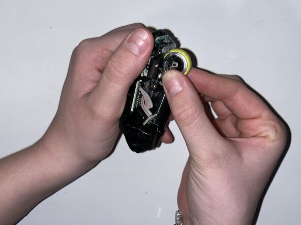

  4. How to Replace a Logitech M325c Scroll Wheel: crwdns2935265:04crwdnd2935265:01crwdnd2935265:03crwdne2935265:0 How to Replace a Logitech M325c Scroll Wheel: crwdns2935265:04crwdnd2935265:02crwdnd2935265:03crwdne2935265:0 How to Replace a Logitech M325c Scroll Wheel: crwdns2935265:04crwdnd2935265:03crwdnd2935265:03crwdne2935265:0
    • Carefully pop the scroll wheel out and replace it with the new wheel.
  5. How to Replace a Logitech M325c Scroll Wheel: crwdns2935265:05crwdnd2935265:01crwdnd2935265:02crwdne2935265:0 How to Replace a Logitech M325c Scroll Wheel: crwdns2935265:05crwdnd2935265:02crwdnd2935265:02crwdne2935265:0
    • Reattach the bottom of the mouse and fasten the single Phillips screw in the battery compartment.
  6. How to Replace a Logitech M325c Scroll Wheel: crwdns2935265:06crwdnd2935265:01crwdnd2935265:03crwdne2935265:0 How to Replace a Logitech M325c Scroll Wheel: crwdns2935265:06crwdnd2935265:02crwdnd2935265:03crwdne2935265:0 How to Replace a Logitech M325c Scroll Wheel: crwdns2935265:06crwdnd2935265:03crwdnd2935265:03crwdne2935265:0
    • Replace the AA battery and reinstall the battery compartment cover.
