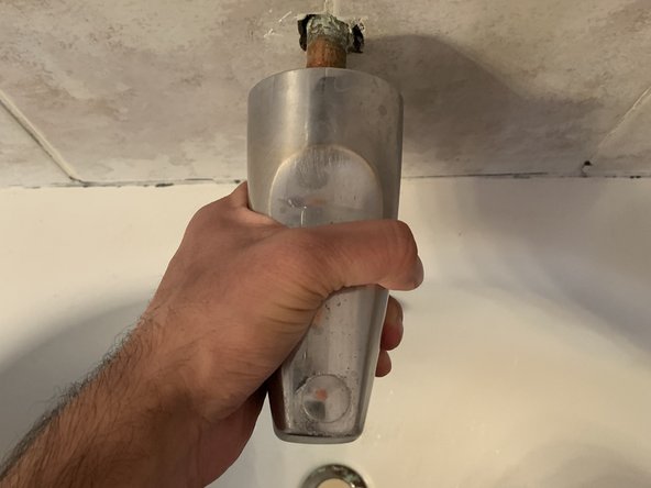

    • Gently pull out the spout using your hand and set it aside somewhere.
    • Protip: Wiggle the spout side to side to help pull it out.

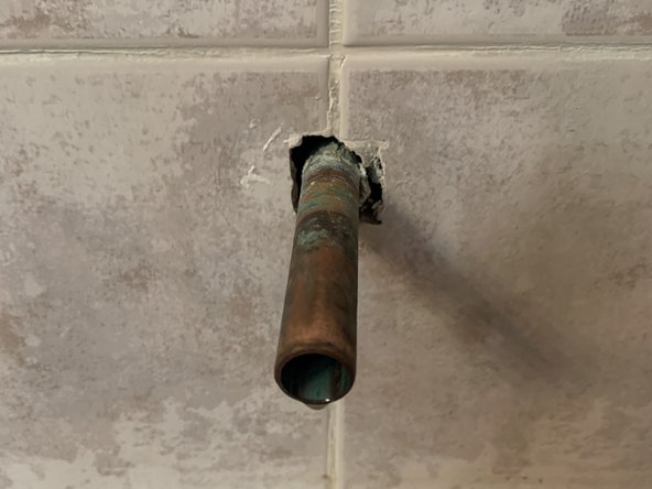

  4. How to Replace a Leaking Set Screw Tub Spout: crwdns2935265:04crwdnd2935265:01crwdnd2935265:03crwdne2935265:0 How to Replace a Leaking Set Screw Tub Spout: crwdns2935265:04crwdnd2935265:02crwdnd2935265:03crwdne2935265:0 How to Replace a Leaking Set Screw Tub Spout: crwdns2935265:04crwdnd2935265:03crwdnd2935265:03crwdne2935265:0
    • Using sandpaper or a sponge, gently rub and clean the pipe.
    • This allows for the new set screw tub spout to easily slip on.
    • Once you have finished cleaning the pipe, wipe off the dust with a piece of cloth or paper towel.
