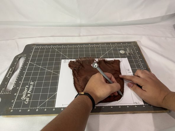

    • Trace the pocket to create a sewing pattern on a piece of paper with a pen.
    • Draw out the length and width of the pocket to the side as a reference for its size.

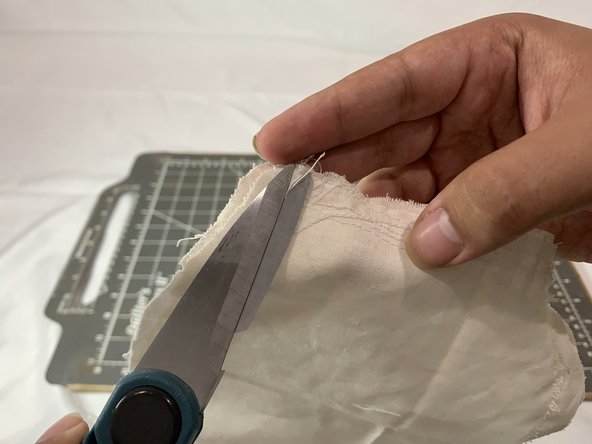

    • Use sewing scissors to cut the fabric along the pattern. These pieces will be sewn together to form the pocket.
    • Repeat the process for the other side of the pocket.

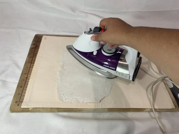

    • Iron out the new pocket with the steam iron.
    • Make sure to place the iron in an upright position when not in use. Pay attention to the fabric you are ironing to avoid burning, and don't touch the face of the iron as it will burn you.

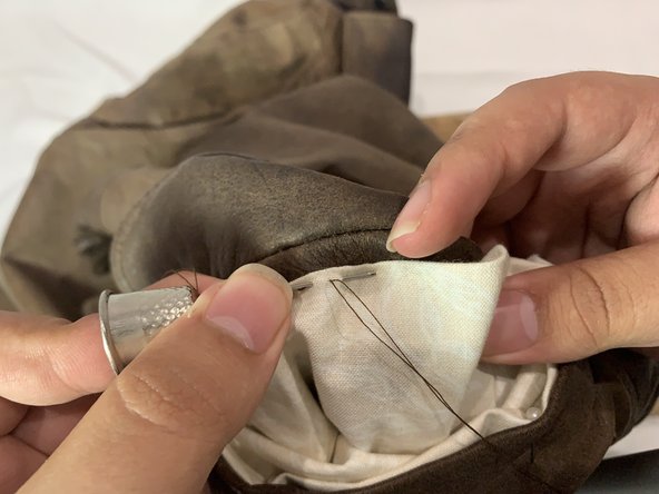

    • Pin the new pocket to the jacket.
    • Flip back the pocket opening flaps to create a fold for the pocket opening and conceal the raw cut edges.

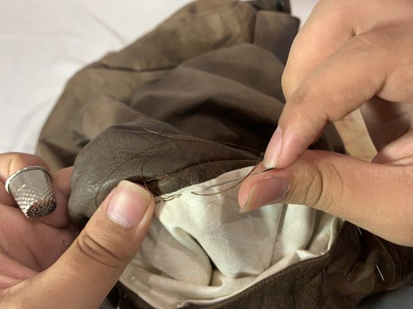

  13. How to Replace a Jacket Pocket: crwdns2935265:013crwdnd2935265:01crwdnd2935265:03crwdne2935265:0 How to Replace a Jacket Pocket: crwdns2935265:013crwdnd2935265:02crwdnd2935265:03crwdne2935265:0 How to Replace a Jacket Pocket: crwdns2935265:013crwdnd2935265:03crwdnd2935265:03crwdne2935265:0
    • Stitch the new pocket onto the jacket using a leather needle and polyester thread.
    • Use a thimble to help push the needle through the fabric and leather.
    • Be careful when the needle is interweaving between the fabrics, as the needle can prick you, causing bleeding.
