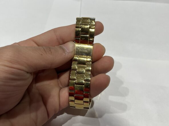

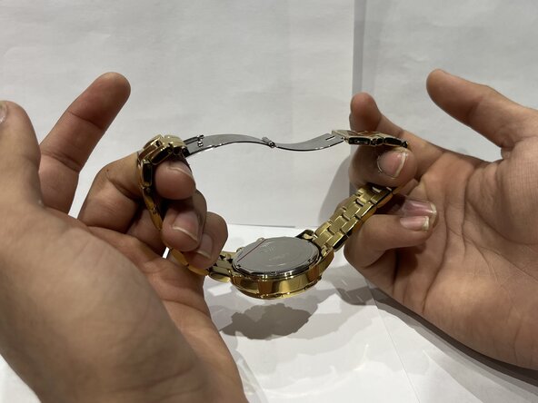

    • Press the buttons on the sides of the watch clasp to release the latch.
    • Open the watch clasp.

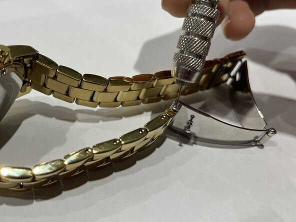

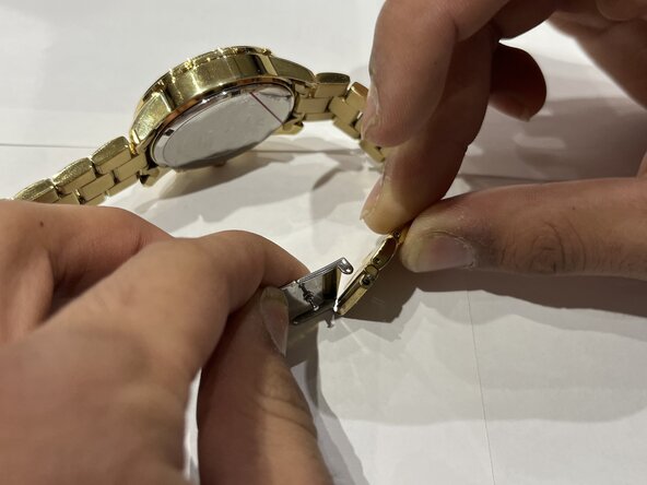

  2. How to Replace a Guess W0016L2 Watch Battery: crwdns2935265:02crwdnd2935265:01crwdnd2935265:03crwdne2935265:0 How to Replace a Guess W0016L2 Watch Battery: crwdns2935265:02crwdnd2935265:02crwdnd2935265:03crwdne2935265:0 How to Replace a Guess W0016L2 Watch Battery: crwdns2935265:02crwdnd2935265:03crwdnd2935265:03crwdne2935265:0
    • Place the watch on its side.
    • Use a pin tool to push the clasp pin out from the side and remove it.

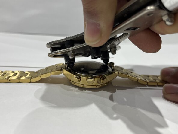

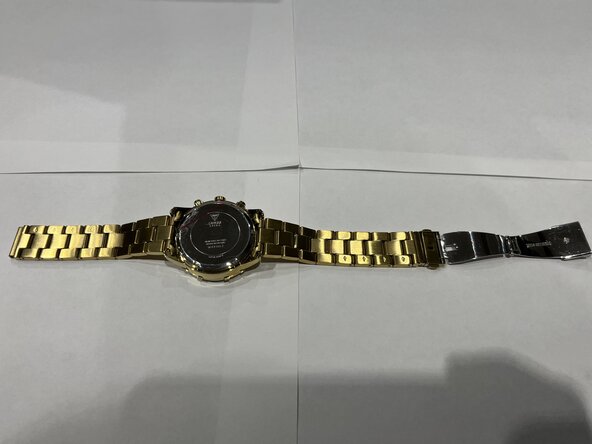

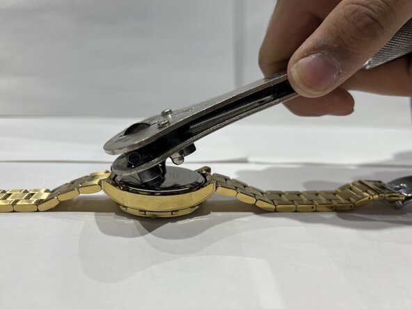

  3. How to Replace a Guess W0016L2 Watch Battery: crwdns2935265:03crwdnd2935265:01crwdnd2935265:03crwdne2935265:0 How to Replace a Guess W0016L2 Watch Battery: crwdns2935265:03crwdnd2935265:02crwdnd2935265:03crwdne2935265:0 How to Replace a Guess W0016L2 Watch Battery: crwdns2935265:03crwdnd2935265:03crwdnd2935265:03crwdne2935265:0
    • Align the tip of the huaxing tool with the notches on the back case of the watch.
    • Once the huaxing tool is aligned with the notches on the back of the watch, turn it counterclockwise to unscrew the back case.

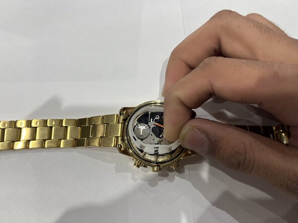

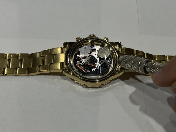

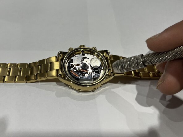

  4. How to Replace a Guess W0016L2 Watch Battery: crwdns2935265:04crwdnd2935265:01crwdnd2935265:02crwdne2935265:0 How to Replace a Guess W0016L2 Watch Battery: crwdns2935265:04crwdnd2935265:02crwdnd2935265:02crwdne2935265:0

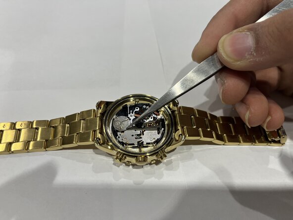

    • Use tweezers or a spudger to remove the plastic guard covering the battery.

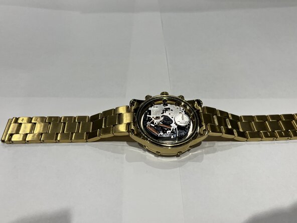

  5. How to Replace a Guess W0016L2 Watch Battery: crwdns2935265:05crwdnd2935265:01crwdnd2935265:03crwdne2935265:0 How to Replace a Guess W0016L2 Watch Battery: crwdns2935265:05crwdnd2935265:02crwdnd2935265:03crwdne2935265:0 How to Replace a Guess W0016L2 Watch Battery: crwdns2935265:05crwdnd2935265:03crwdnd2935265:03crwdne2935265:0
    • Use a spudger to gently lift the battery clip just enough to slide the battery out from the holder.
    • If you're using tweezers, simply remove the battery.

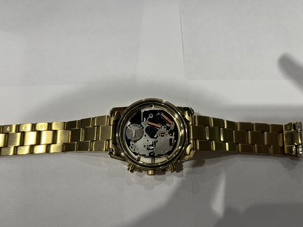

  6. How to Replace a Guess W0016L2 Watch Battery: crwdns2935265:06crwdnd2935265:01crwdnd2935265:03crwdne2935265:0 How to Replace a Guess W0016L2 Watch Battery: crwdns2935265:06crwdnd2935265:02crwdnd2935265:03crwdne2935265:0 How to Replace a Guess W0016L2 Watch Battery: crwdns2935265:06crwdnd2935265:03crwdnd2935265:03crwdne2935265:0
    • Use tweezers or your hands to place the new battery into the battery slot with the positive side facing upwards.

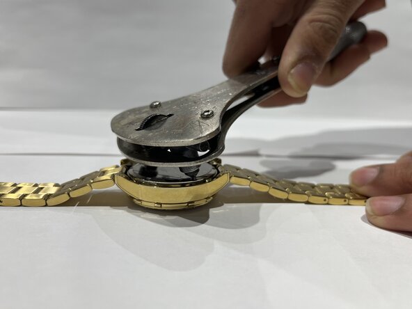

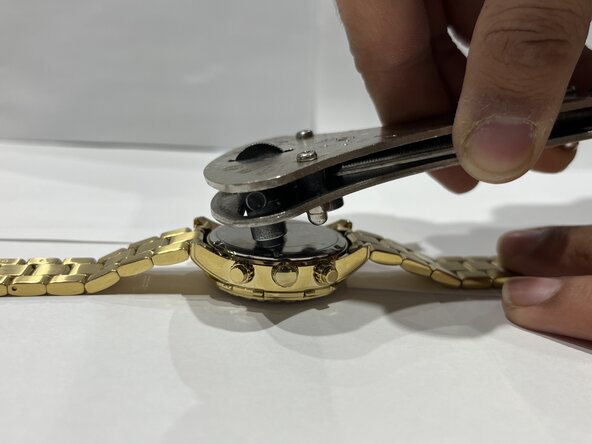

  8. How to Replace a Guess W0016L2 Watch Battery: crwdns2935265:08crwdnd2935265:01crwdnd2935265:03crwdne2935265:0 How to Replace a Guess W0016L2 Watch Battery: crwdns2935265:08crwdnd2935265:02crwdnd2935265:03crwdne2935265:0 How to Replace a Guess W0016L2 Watch Battery: crwdns2935265:08crwdnd2935265:03crwdnd2935265:03crwdne2935265:0
    • Replace the back case of the watch.
    • Align the watch case opener with the notches on the back case and turn it clockwise to tighten.

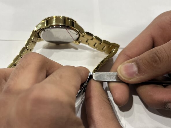

  9. How to Replace a Guess W0016L2 Watch Battery: crwdns2935265:09crwdnd2935265:01crwdnd2935265:03crwdne2935265:0 How to Replace a Guess W0016L2 Watch Battery: crwdns2935265:09crwdnd2935265:02crwdnd2935265:03crwdne2935265:0 How to Replace a Guess W0016L2 Watch Battery: crwdns2935265:09crwdnd2935265:03crwdnd2935265:03crwdne2935265:0
    • Insert the pin into the watch link.
    • Slide the pin into one of the holes of the clasp.
    • Push the pin down and place it under the second hole of the clasp.
