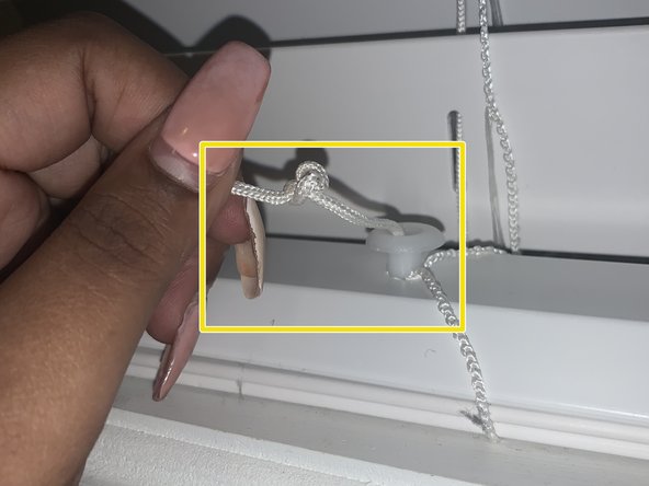

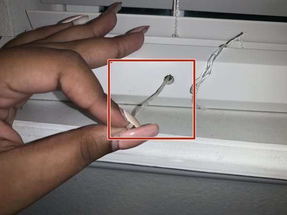

  2. How to Replace a Broken Blind Slat: crwdns2935265:02crwdnd2935265:01crwdnd2935265:02crwdne2935265:0 How to Replace a Broken Blind Slat: crwdns2935265:02crwdnd2935265:02crwdnd2935265:02crwdne2935265:0
    • Remove the bottom rail buttons to expose knots at the end of the lifting cords.
    • Untie the knots.

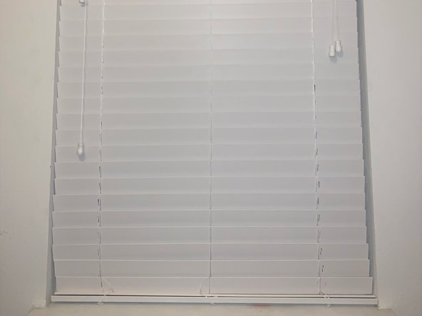

  7. How to Replace a Broken Blind Slat: crwdns2935265:07crwdnd2935265:01crwdnd2935265:03crwdne2935265:0 How to Replace a Broken Blind Slat: crwdns2935265:07crwdnd2935265:02crwdnd2935265:03crwdne2935265:0 How to Replace a Broken Blind Slat: crwdns2935265:07crwdnd2935265:03crwdnd2935265:03crwdne2935265:0
    • Once you reach the bottom slat, thread the lifting cords back through the bottom rail.
    • Make sure the lifting cords are even in length and the bottom rail is aligned straight horizontally.

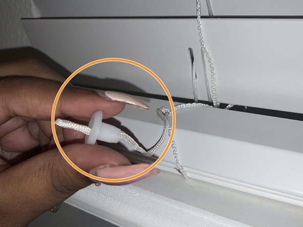

  8. How to Replace a Broken Blind Slat: crwdns2935265:08crwdnd2935265:01crwdnd2935265:03crwdne2935265:0 How to Replace a Broken Blind Slat: crwdns2935265:08crwdnd2935265:02crwdnd2935265:03crwdne2935265:0 How to Replace a Broken Blind Slat: crwdns2935265:08crwdnd2935265:03crwdnd2935265:03crwdne2935265:0
    • Use the 7/32" flathead screwdriver to push the excess lifting cords into the bottom rail holes.
    • Slide the buttons back over the ends of the cords.
    • At each bottom rail button, double knot the lifting cords.
