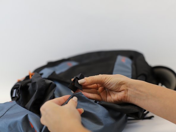

  2. How to Replace a Backpack Buckle (with sewing), Clean the area: crwdns2935265:02crwdnd2935265:01crwdnd2935265:03crwdne2935265:0 How to Replace a Backpack Buckle (with sewing), Clean the area: crwdns2935265:02crwdnd2935265:02crwdnd2935265:03crwdne2935265:0 How to Replace a Backpack Buckle (with sewing), Clean the area: crwdns2935265:02crwdnd2935265:03crwdnd2935265:03crwdne2935265:0
    • Use a seam ripper to unstitch the strap.
    • Remove the broken buckle and check that it is compatible with the replacement part.
    • Tip: The new buckle size must match the strap width.

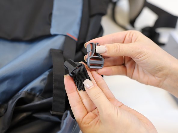

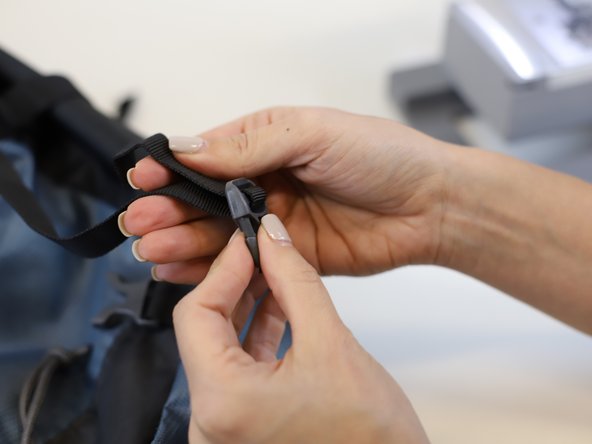

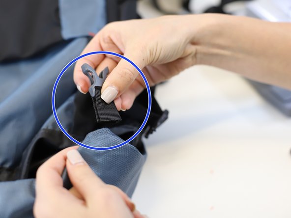

  3. How to Replace a Backpack Buckle (with sewing), Test the replacement part: crwdns2935265:03crwdnd2935265:01crwdnd2935265:03crwdne2935265:0 How to Replace a Backpack Buckle (with sewing), Test the replacement part: crwdns2935265:03crwdnd2935265:02crwdnd2935265:03crwdne2935265:0 How to Replace a Backpack Buckle (with sewing), Test the replacement part: crwdns2935265:03crwdnd2935265:03crwdnd2935265:03crwdne2935265:0
    • Set the top part of the buckle aside (green circle).
    • Take the bottom part of the buckle (blue circle) and put it into the strap.
    • Hold it together with both hands and then insert it into the seam of the backpack.

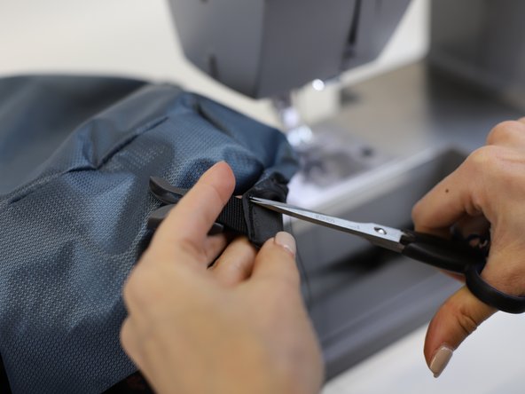

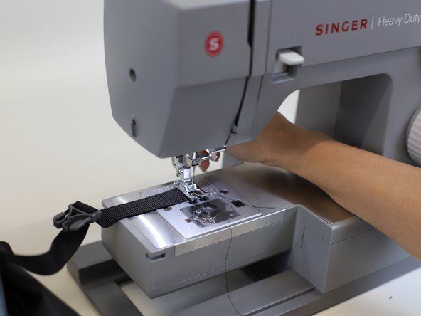

  4. How to Replace a Backpack Buckle (with sewing), Stitch the bottom buckle in place: crwdns2935265:04crwdnd2935265:01crwdnd2935265:02crwdne2935265:0 How to Replace a Backpack Buckle (with sewing), Stitch the bottom buckle in place: crwdns2935265:04crwdnd2935265:02crwdnd2935265:02crwdne2935265:0
    • Following the last step, keep holding together the strap with the bottom buckle with both hands and gently place it on the sewing machine.
    • Once the strap is set in place, start stitching the area.
    • Use a pair of scissors to cut any loose threads.

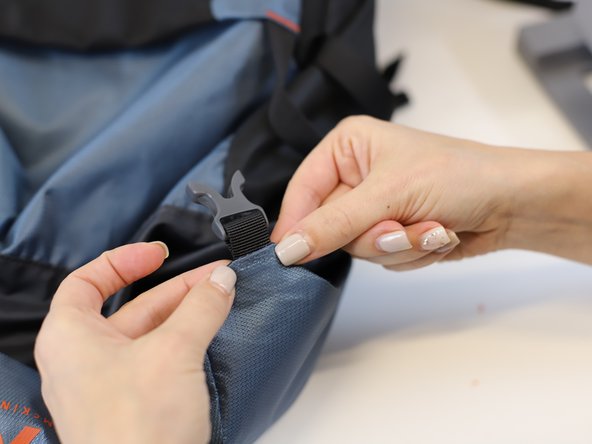

  5. How to Replace a Backpack Buckle (with sewing), Stitch the top buckle piece: crwdns2935265:05crwdnd2935265:01crwdnd2935265:03crwdne2935265:0 How to Replace a Backpack Buckle (with sewing), Stitch the top buckle piece: crwdns2935265:05crwdnd2935265:02crwdnd2935265:03crwdne2935265:0 How to Replace a Backpack Buckle (with sewing), Stitch the top buckle piece: crwdns2935265:05crwdnd2935265:03crwdnd2935265:03crwdne2935265:0
    • Repeat the previous steps to stitch the top buckle piece.

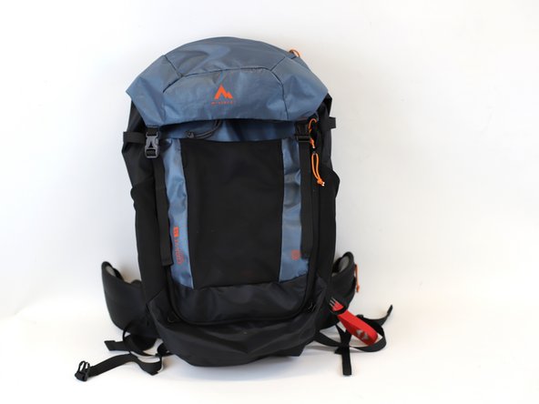

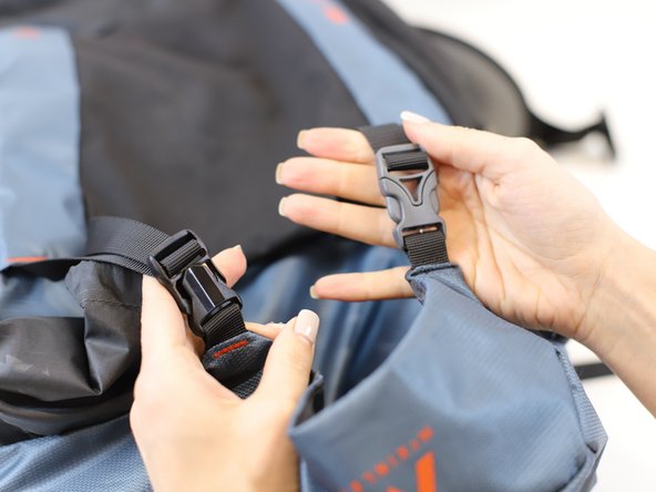

  6. How to Replace a Backpack Buckle (with sewing), Finished and ready!: crwdns2935265:06crwdnd2935265:01crwdnd2935265:03crwdne2935265:0 How to Replace a Backpack Buckle (with sewing), Finished and ready!: crwdns2935265:06crwdnd2935265:02crwdnd2935265:03crwdne2935265:0 How to Replace a Backpack Buckle (with sewing), Finished and ready!: crwdns2935265:06crwdnd2935265:03crwdnd2935265:03crwdne2935265:0
    • 🛠️🏆👏 Congratulations! The repair is complete, and you're ready to go!
