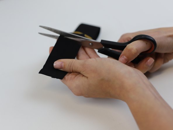

    • Using a fabric pencil, mark the length calculated on the previous step. In this example, we are marking 7cm (green line).
    • Note: We are using an elastic band that will serve as the new "strap keeper". For this example, we chose the color black in order to make it stand out.
    • Cut along the marked length and then fold the elastic band around the strap.

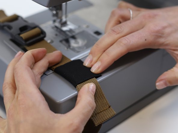

    • Before stitching remove the strap and align the elastic in the correct position.
    • Tip: For tips on setting up the machine take a look at this iFixit guide.

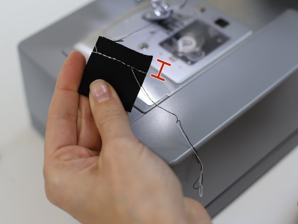

    • Make sure you leave 1 cm away from the edge (red line).

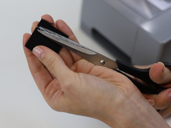

    • Clean the remaining loose threads.

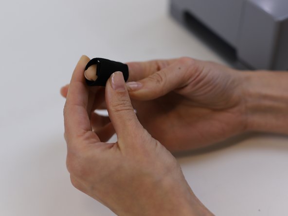

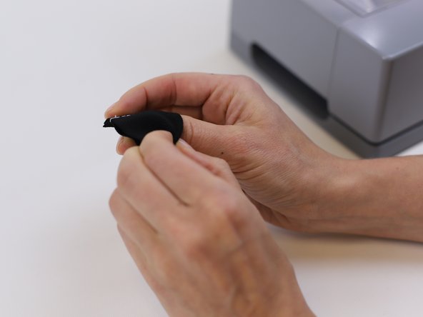

  5. How to Replace a "Strap Keeper" in a Backpack, Turn the "strap keeper" inside out: crwdns2935265:05crwdnd2935265:01crwdnd2935265:03crwdne2935265:0 How to Replace a "Strap Keeper" in a Backpack, Turn the "strap keeper" inside out: crwdns2935265:05crwdnd2935265:02crwdnd2935265:03crwdne2935265:0 How to Replace a "Strap Keeper" in a Backpack, Turn the "strap keeper" inside out: crwdns2935265:05crwdnd2935265:03crwdnd2935265:03crwdne2935265:0
    • Turn the "strap keeper" so that the sewn part is facing inwards.

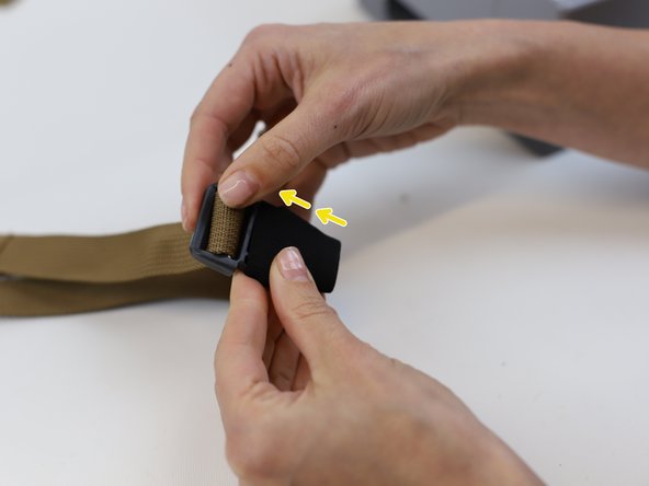

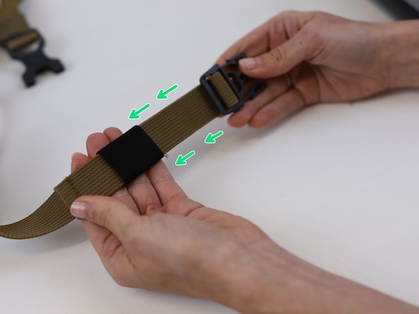

  6. How to Replace a "Strap Keeper" in a Backpack, Insert the "strap keeper": crwdns2935265:06crwdnd2935265:01crwdnd2935265:03crwdne2935265:0 How to Replace a "Strap Keeper" in a Backpack, Insert the "strap keeper": crwdns2935265:06crwdnd2935265:02crwdnd2935265:03crwdne2935265:0 How to Replace a "Strap Keeper" in a Backpack, Insert the "strap keeper": crwdns2935265:06crwdnd2935265:03crwdnd2935265:03crwdne2935265:0
    • Following the red arrows, insert the "strap keeper" into the strap with the buckle.
    • Once it has been inserted into the buckle, follow the direction of the yellow arrows.
    • Keep going forward and gently slide the "strap keeper" in the direction of the green arrows till it is holding the "loose" strap in place.
