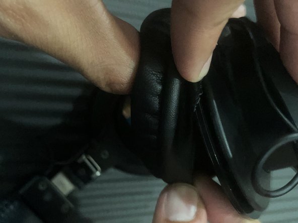

    • CAUTION: For safe-handling (preventing damage or dislocation of the wires or other components) rotate the earcups to their inverse position about ~ 180° degrees from resting position.
  2. How to Replace Sony MDR-7506 Ear Pads: crwdns2935265:02crwdnd2935265:01crwdnd2935265:03crwdne2935265:0 How to Replace Sony MDR-7506 Ear Pads: crwdns2935265:02crwdnd2935265:02crwdnd2935265:03crwdne2935265:0 How to Replace Sony MDR-7506 Ear Pads: crwdns2935265:02crwdnd2935265:03crwdnd2935265:03crwdne2935265:0
    • Carefully peel the cushions off, closer to the seams, along the speaker's outer edge.
    • Fully remove the ear pads without any yanking or excessive jerking motions.
    • Repeat for the other side's ear pad.

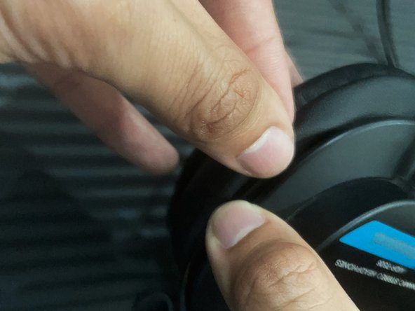

  5. How to Replace Sony MDR-7506 Ear Pads: crwdns2935265:05crwdnd2935265:01crwdnd2935265:03crwdne2935265:0 How to Replace Sony MDR-7506 Ear Pads: crwdns2935265:05crwdnd2935265:02crwdnd2935265:03crwdne2935265:0 How to Replace Sony MDR-7506 Ear Pads: crwdns2935265:05crwdnd2935265:03crwdnd2935265:03crwdne2935265:0
    • Begin wrapping the ear cushions by securing the leather around the edges of each speaker. Insert the non-cushion side flaps into the allotted crevice.
    • Work around the edges of each speaker until complete.
    • Initial stretching for proper fitment may be required; however, carefully hold down the wrapped parts in place while pulling the free lip over the speaker edges - as shown in the second image.
