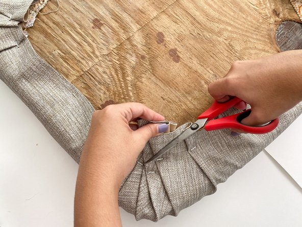

  5. How to Replace Seat Fabric/Cushioning: crwdns2935265:05crwdnd2935265:01crwdnd2935265:02crwdne2935265:0 How to Replace Seat Fabric/Cushioning: crwdns2935265:05crwdnd2935265:02crwdnd2935265:02crwdne2935265:0
    • Staple the fabric to the seat, around the entire perimeter.
    • It helps to have a friend hold the fabric taut while you staple.
    • After everything is stapled, cut excess fabric (if necessary) using a pair of scissors.
