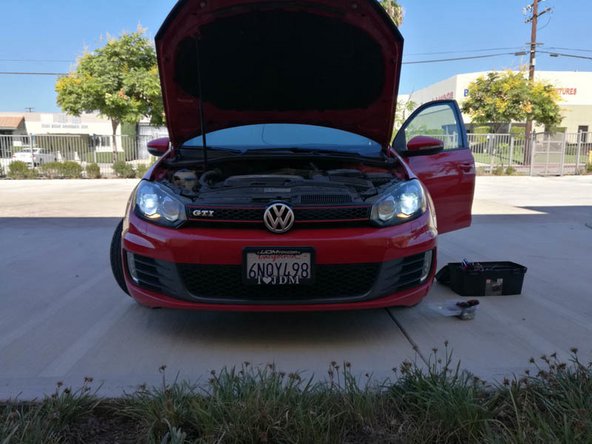

    • Open the hood and then locate the back of the headlights.
