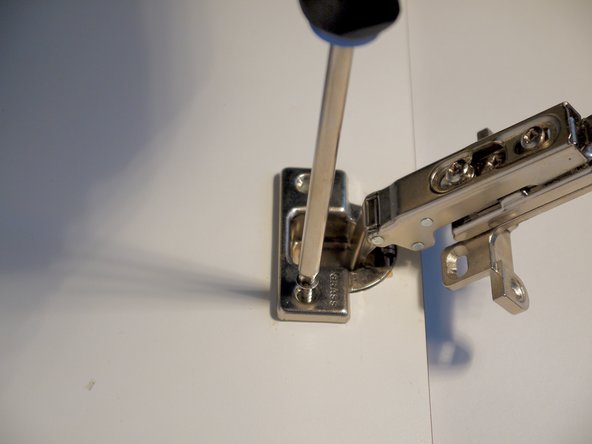

    • Remove the screws that are attached to the cabinet door.
    • Unscrew the top and bottom hinges even if you are only replacing one hinge.
    • Remove the cabinet door from the hinge.
    • You may need to wiggle or pry the door off.
  2. How to Replace Concealed Cabinet Hinges: crwdns2935265:02crwdnd2935265:01crwdnd2935265:02crwdne2935265:0 How to Replace Concealed Cabinet Hinges: crwdns2935265:02crwdnd2935265:02crwdnd2935265:02crwdne2935265:0
    • Remove the screws that go into the cabinet frame from the hinge, then remove the hinge.
    • Only the hinge being replaced needs to be removed.
  3. How to Replace Concealed Cabinet Hinges: crwdns2935265:03crwdnd2935265:01crwdnd2935265:03crwdne2935265:0 How to Replace Concealed Cabinet Hinges: crwdns2935265:03crwdnd2935265:02crwdnd2935265:03crwdne2935265:0 How to Replace Concealed Cabinet Hinges: crwdns2935265:03crwdnd2935265:03crwdnd2935265:03crwdne2935265:0
    • Insert the new hinge into the cabinet door's pre-cut hole.
    • Attach the hinge with the provided screws.
    • To avoid striping the screws, do not over tighten.
  4. How to Replace Concealed Cabinet Hinges: crwdns2935265:04crwdnd2935265:01crwdnd2935265:01crwdne2935265:0
    • Reattach the cabinet door to the cabinet frame.
    • Do not tighten the screws all the way. You will need to align the door later.
    • You may need a friend to hold the door while you screw it back into place.
  5. How to Replace Concealed Cabinet Hinges: crwdns2935265:05crwdnd2935265:01crwdnd2935265:02crwdne2935265:0 How to Replace Concealed Cabinet Hinges: crwdns2935265:05crwdnd2935265:02crwdnd2935265:02crwdne2935265:0
    • Lift or lower the cabinet door to align the hinges with its original location.
    • Changes in wood stain can serve as a useful alignment guide.
    • Tighten all the screws.
  6. How to Replace Concealed Cabinet Hinges: crwdns2935265:06crwdnd2935265:01crwdnd2935265:03crwdne2935265:0 How to Replace Concealed Cabinet Hinges: crwdns2935265:06crwdnd2935265:02crwdnd2935265:03crwdne2935265:0 How to Replace Concealed Cabinet Hinges: crwdns2935265:06crwdnd2935265:03crwdnd2935265:03crwdne2935265:0
    • Use this step to adjust the amount of space between the cabinet door and the cabinet frame.
    • Loosen the adjustment screws, but do not remove them.
    • Slide the cabinet door to your desired position.
    • Tighten the screws.
  7. How to Replace Concealed Cabinet Hinges: crwdns2935265:07crwdnd2935265:01crwdnd2935265:01crwdne2935265:0
    • Use this step if your cabinet door closes too hard or does not completely close.
    • Tighten this screw to keep the cabinet door from closing too hard. Loosen the screw to allow the cabinet door to close completely.
    • Do not completely remove this screw.
