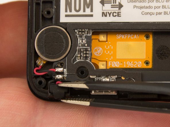

  7. How to Replace Blu Studio Selfie Microphone, Microphone: crwdns2935265:07crwdnd2935265:01crwdnd2935265:02crwdne2935265:0 How to Replace Blu Studio Selfie Microphone, Microphone: crwdns2935265:07crwdnd2935265:02crwdnd2935265:02crwdne2935265:0
    • Remove three 4 mm Phillips #000 screws holding the motherboard in place.
    • Carefully lift the motherboard from the phone, exposing the microphone soldering connections.
  8. How to Replace Blu Studio Selfie Microphone: crwdns2935265:08crwdnd2935265:01crwdnd2935265:02crwdne2935265:0 How to Replace Blu Studio Selfie Microphone: crwdns2935265:08crwdnd2935265:02crwdnd2935265:02crwdne2935265:0
    • Use a soldering iron to desolder the microphone from the phone.
    • Learn more about soldering here.
