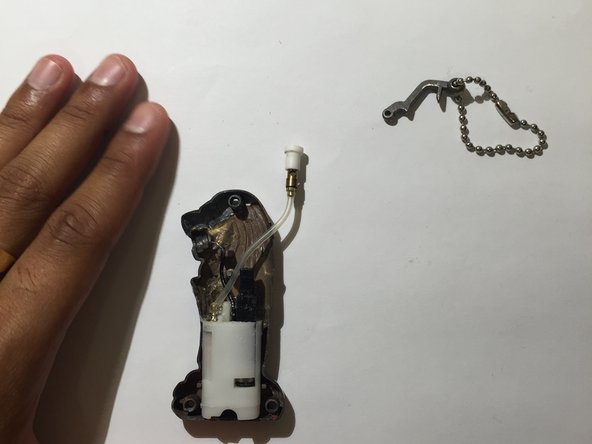

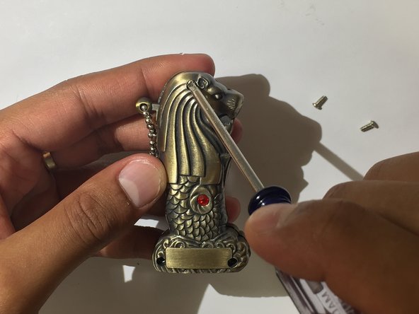

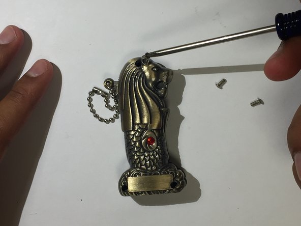

    • Use the screwdriver to remove all the 1.2 mm Phillips #1 countersunk screws from the torch.
  2. How to Repair the Sparker on a Merlion Mini Torch: crwdns2935265:02crwdnd2935265:01crwdnd2935265:02crwdne2935265:0 How to Repair the Sparker on a Merlion Mini Torch: crwdns2935265:02crwdnd2935265:02crwdnd2935265:02crwdne2935265:0

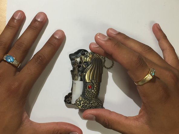

    • Open up the torch.
    • Set aside the empty side of the torch.

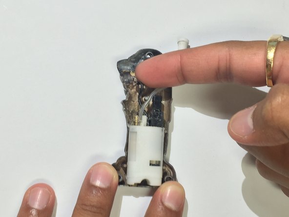

  3. How to Repair the Sparker on a Merlion Mini Torch: crwdns2935265:03crwdnd2935265:01crwdnd2935265:03crwdne2935265:0 How to Repair the Sparker on a Merlion Mini Torch: crwdns2935265:03crwdnd2935265:02crwdnd2935265:03crwdne2935265:0 How to Repair the Sparker on a Merlion Mini Torch: crwdns2935265:03crwdnd2935265:03crwdnd2935265:03crwdne2935265:0

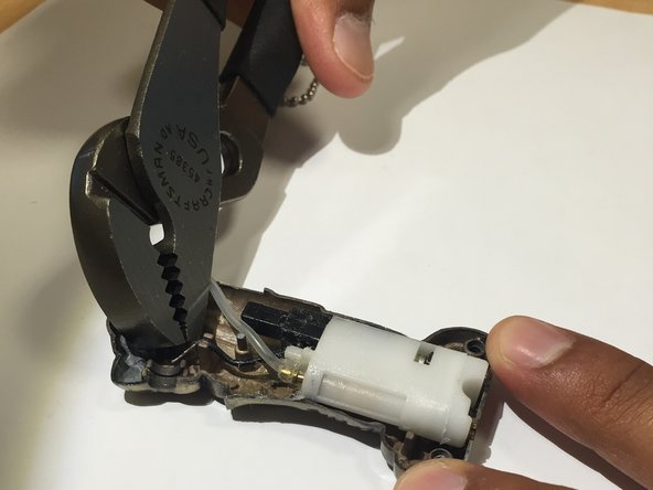

    • Pull the handle down as if you were to use the torch.
    • You will see one of the parts inside spark. This is the sparker.
    • Now gently remove the handle and set it aside.

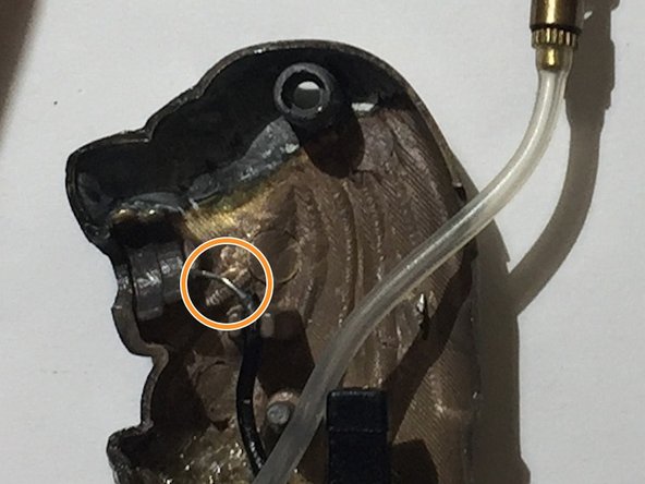

  4. How to Repair the Sparker on a Merlion Mini Torch: crwdns2935265:04crwdnd2935265:01crwdnd2935265:02crwdne2935265:0 How to Repair the Sparker on a Merlion Mini Torch: crwdns2935265:04crwdnd2935265:02crwdnd2935265:02crwdne2935265:0
    • Grab your pliers and GENTLY tug the sparker towards the Merlion head until it is extended about a centimeter.
  5. How to Repair the Sparker on a Merlion Mini Torch: crwdns2935265:05crwdnd2935265:01crwdnd2935265:02crwdne2935265:0 How to Repair the Sparker on a Merlion Mini Torch: crwdns2935265:05crwdnd2935265:02crwdnd2935265:02crwdne2935265:0
    • Gently bend the sparker until it is positioned near the opening of the Merlion's mouth.

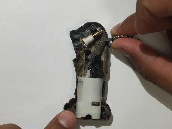

  6. How to Repair the Sparker on a Merlion Mini Torch: crwdns2935265:06crwdnd2935265:01crwdnd2935265:03crwdne2935265:0 How to Repair the Sparker on a Merlion Mini Torch: crwdns2935265:06crwdnd2935265:02crwdnd2935265:03crwdne2935265:0 How to Repair the Sparker on a Merlion Mini Torch: crwdns2935265:06crwdnd2935265:03crwdnd2935265:03crwdne2935265:0
    • Grab the tube and gently bend it so it faces the opening of the Merlion's mouth.
    • Put the handle back on the torch.

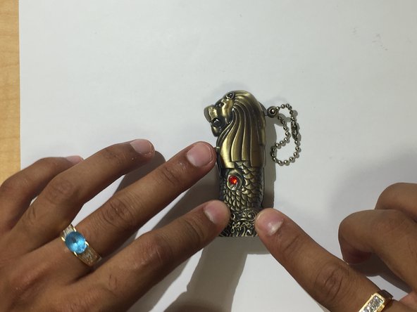

    • Take the empty half of the torch and place it over the other half.
  8. How to Repair the Sparker on a Merlion Mini Torch: crwdns2935265:08crwdnd2935265:01crwdnd2935265:03crwdne2935265:0 How to Repair the Sparker on a Merlion Mini Torch: crwdns2935265:08crwdnd2935265:02crwdnd2935265:03crwdne2935265:0 How to Repair the Sparker on a Merlion Mini Torch: crwdns2935265:08crwdnd2935265:03crwdnd2935265:03crwdne2935265:0
    • Use the screwdriver to put the screws back in the torch.
  9. How to Repair the Sparker on a Merlion Mini Torch: crwdns2935265:09crwdnd2935265:01crwdnd2935265:02crwdne2935265:0 How to Repair the Sparker on a Merlion Mini Torch: crwdns2935265:09crwdnd2935265:02crwdnd2935265:02crwdne2935265:0

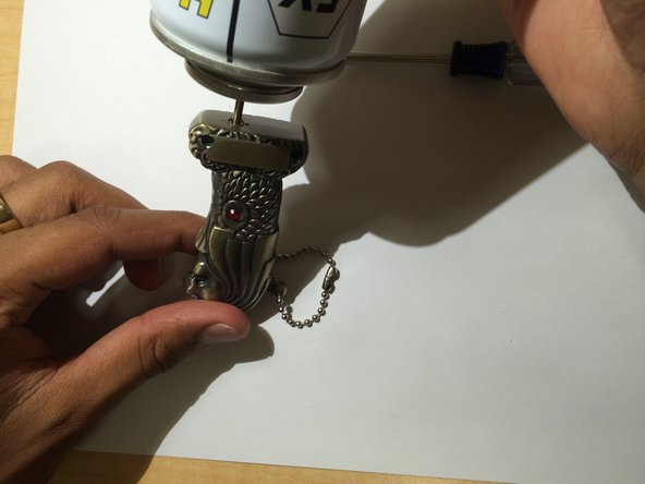

    • Hold the torch upside down and position the butane above the torch's hole.
    • Gently press down for five seconds.
Congrats! Now you can use your Merlion torch again.
