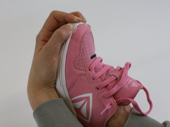

  1. How to Repair an Upper Delamination, Check the damaged area: crwdns2935265:01crwdnd2935265:01crwdnd2935265:03crwdne2935265:0 How to Repair an Upper Delamination, Check the damaged area: crwdns2935265:01crwdnd2935265:02crwdnd2935265:03crwdne2935265:0 How to Repair an Upper Delamination, Check the damaged area: crwdns2935265:01crwdnd2935265:03crwdnd2935265:03crwdne2935265:0

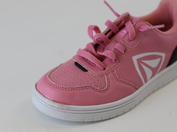

    • Identify the upper part that needs to be repaired
    • For better pressing later, remove the insole.

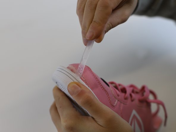

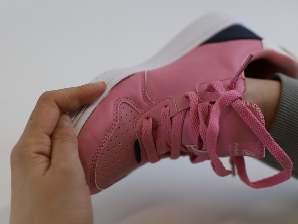

  2. How to Repair an Upper Delamination, Remove glue residue: crwdns2935265:02crwdnd2935265:01crwdnd2935265:03crwdne2935265:0 How to Repair an Upper Delamination, Remove glue residue: crwdns2935265:02crwdnd2935265:02crwdnd2935265:03crwdne2935265:0 How to Repair an Upper Delamination, Remove glue residue: crwdns2935265:02crwdnd2935265:03crwdnd2935265:03crwdne2935265:0
    • Use a rough piece of sandpaper to rub-off the remaining glue residue and to roughen the surface for enhanced glue adhesion.
    • Be careful not to damage the material above the glued sole edge.

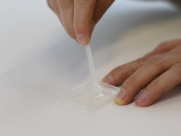

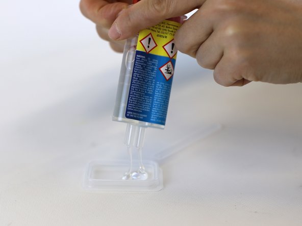

  3. How to Repair an Upper Delamination, Prepare the glue: crwdns2935265:03crwdnd2935265:01crwdnd2935265:03crwdne2935265:0 How to Repair an Upper Delamination, Prepare the glue: crwdns2935265:03crwdnd2935265:02crwdnd2935265:03crwdne2935265:0 How to Repair an Upper Delamination, Prepare the glue: crwdns2935265:03crwdnd2935265:03crwdnd2935265:03crwdne2935265:0
    • Follow the instructions of the 2-component glue.
    • Push-out both components of the glue into a small tray and mix the mass until it is equally merged.

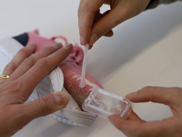

  4. How to Repair an Upper Delamination, Coat upper and sole with glue: crwdns2935265:04crwdnd2935265:01crwdnd2935265:03crwdne2935265:0 How to Repair an Upper Delamination, Coat upper and sole with glue: crwdns2935265:04crwdnd2935265:02crwdnd2935265:03crwdne2935265:0 How to Repair an Upper Delamination, Coat upper and sole with glue: crwdns2935265:04crwdnd2935265:03crwdnd2935265:03crwdne2935265:0
    • Using a small spatula, coat the prepared upper surface with the glue.
    • Note: We recommend to get support by another person to pull apart the sole from the upper.
    • Spread the glue equally onto the roughened area and the inside of the sole edge.

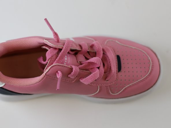

  5. How to Repair an Upper Delamination, Pressing both parts together: crwdns2935265:05crwdnd2935265:01crwdnd2935265:03crwdne2935265:0 How to Repair an Upper Delamination, Pressing both parts together: crwdns2935265:05crwdnd2935265:02crwdnd2935265:03crwdne2935265:0 How to Repair an Upper Delamination, Pressing both parts together: crwdns2935265:05crwdnd2935265:03crwdnd2935265:03crwdne2935265:0
    • Let the glue dry while putting one hand into the shoe and grasping the sole with the other one.
    • Note: Follow the instructions of the glue used to know the exact drying time. In this example we held the parts together for 3 minutes and then let it dry for 24 hours.
  6. How to Repair an Upper Delamination, Finished and ready!: crwdns2935265:06crwdnd2935265:01crwdnd2935265:03crwdne2935265:0 How to Repair an Upper Delamination, Finished and ready!: crwdns2935265:06crwdnd2935265:02crwdnd2935265:03crwdne2935265:0 How to Repair an Upper Delamination, Finished and ready!: crwdns2935265:06crwdnd2935265:03crwdnd2935265:03crwdne2935265:0
    • 🛠️🏆👏 Congratulations! The repair is complete, and you're ready to go!
