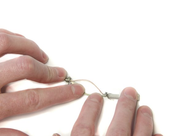

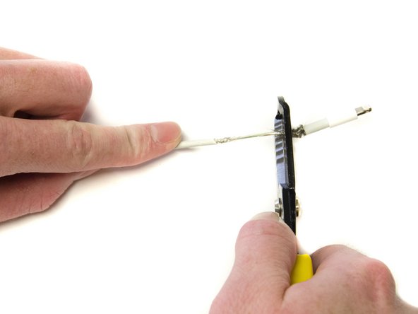

    • Locate the damaged area of your lightning cable.
    • Damage may differ from user-to-user.
    • Use the 1.6 mm gauge on the wire strippers to strip a small portion of the outer jacket.
    • Peel the outer jacket from both sides of the damaged area, exposing the underlying metal jacket.

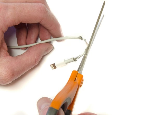

  2. How to Repair an Apple Lightning Cable: crwdns2935265:02crwdnd2935265:01crwdnd2935265:03crwdne2935265:0 How to Repair an Apple Lightning Cable: crwdns2935265:02crwdnd2935265:02crwdnd2935265:03crwdne2935265:0 How to Repair an Apple Lightning Cable: crwdns2935265:02crwdnd2935265:03crwdnd2935265:03crwdne2935265:0
    • Carefully strip the metal jacket away from the underlying wires using the 1.0 mm gauge.
    • Use the scissors to cut the metal jacket off the cable.
    • Do not cut through the wires.

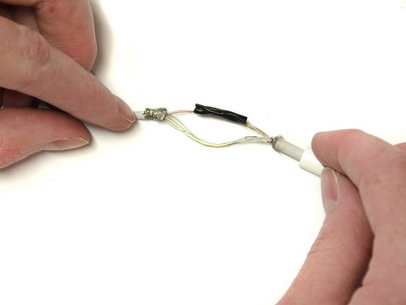

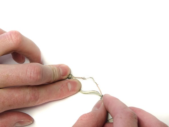

  3. How to Repair an Apple Lightning Cable: crwdns2935265:03crwdnd2935265:01crwdnd2935265:02crwdne2935265:0 How to Repair an Apple Lightning Cable: crwdns2935265:03crwdnd2935265:02crwdnd2935265:02crwdne2935265:0
    • Separate and examine the three main wires for any damage. Red (Power), White (Data), and Green (Data).
    • Separate the damaged wire from the other wires.

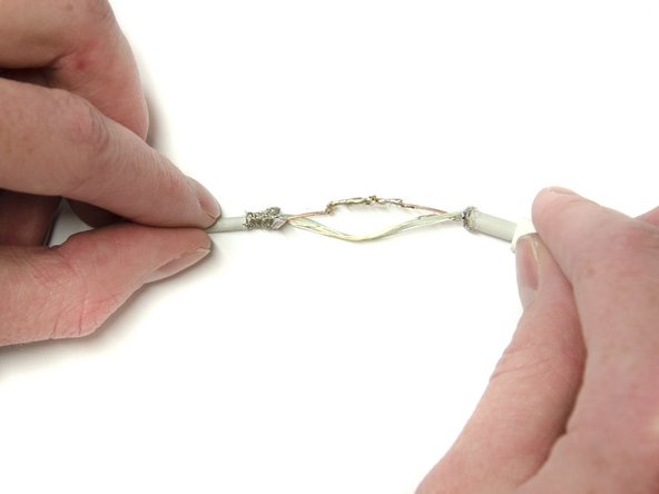

  4. How to Repair an Apple Lightning Cable: crwdns2935265:04crwdnd2935265:01crwdnd2935265:02crwdne2935265:0 How to Repair an Apple Lightning Cable: crwdns2935265:04crwdnd2935265:02crwdnd2935265:02crwdne2935265:0
    • Strip the wire around the damaged area using the 0.6 mm gauge and expose the copper wires underneath.
  5. How to Repair an Apple Lightning Cable: crwdns2935265:05crwdnd2935265:01crwdnd2935265:02crwdne2935265:0 How to Repair an Apple Lightning Cable: crwdns2935265:05crwdnd2935265:02crwdnd2935265:02crwdne2935265:0
    • Solder the exposed wires together, ensuring contact throughout the damaged area using the soldering iron.
    • Repeat for any other damaged wires.

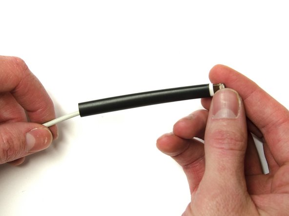

  7. How to Repair an Apple Lightning Cable: crwdns2935265:07crwdnd2935265:01crwdnd2935265:02crwdne2935265:0 How to Repair an Apple Lightning Cable: crwdns2935265:07crwdnd2935265:02crwdnd2935265:02crwdne2935265:0
    • Slide the shrink tubing over the exposed wires to cover the bare wires on both ends.

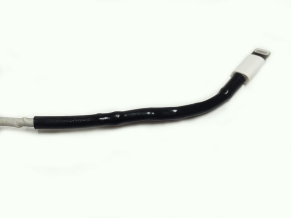

  8. How to Repair an Apple Lightning Cable: crwdns2935265:08crwdnd2935265:01crwdnd2935265:02crwdne2935265:0 How to Repair an Apple Lightning Cable: crwdns2935265:08crwdnd2935265:02crwdnd2935265:02crwdne2935265:0
    • Use the lighter to shrink the tubing around the lightning cable.
    • Straighten out the cable as you apply heat to the heat shrink tubing.
Repeat for any other damaged areas on lightning cable.
