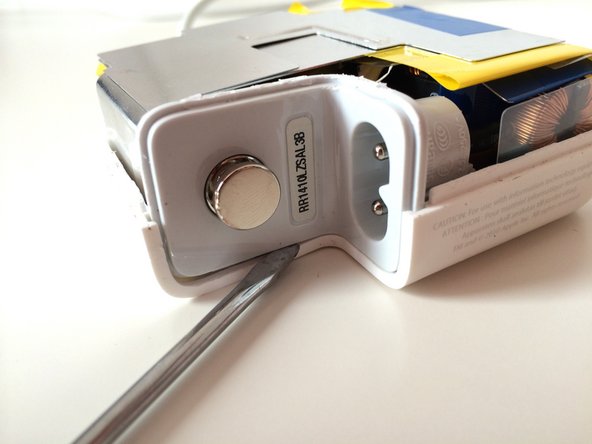

    • Lift up the 2 flaps, and SLOWLY separate the two halves of the casing with a set of pliers.
    • Be careful, as this step can potentially do the most damage to the outer casing. Take your time, and wrap the plier tips with some tape if you don't want to leave any marks.
    • After a good couple of pops, you'll be able to hold it open with your hands.
  3. How to Repair an Apple AC Adapter Broken Cable: crwdns2935265:03crwdnd2935265:01crwdnd2935265:02crwdne2935265:0 How to Repair an Apple AC Adapter Broken Cable: crwdns2935265:03crwdnd2935265:02crwdnd2935265:02crwdne2935265:0
    • Rinse and repeat: now heat the lower part of the adapter.
    • Gently pull the two halves of the case apart.
  4. How to Repair an Apple AC Adapter Broken Cable: crwdns2935265:04crwdnd2935265:01crwdnd2935265:02crwdne2935265:0 How to Repair an Apple AC Adapter Broken Cable: crwdns2935265:04crwdnd2935265:02crwdnd2935265:02crwdne2935265:0
    • Heat the lower part some more—this will loosen the AC Input Connector, which should still be stuck to one of the two sides.
    • Give it a bit of screwdriver action if it's stubborn like mine was.

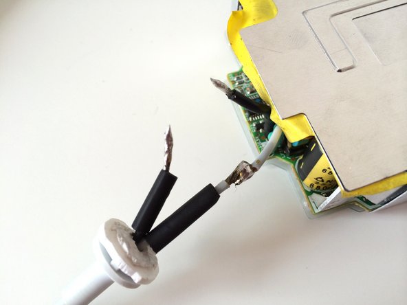

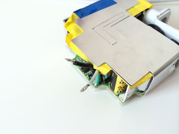

  5. How to Repair an Apple AC Adapter Broken Cable: crwdns2935265:05crwdnd2935265:01crwdnd2935265:01crwdne2935265:0
    • If all went well, you should have completely separated the 2 parts of the case from the actual power supply.
  6. How to Repair an Apple AC Adapter Broken Cable: crwdns2935265:06crwdnd2935265:01crwdnd2935265:01crwdne2935265:0
    • Cut both wires as close to the little plastic thingy as possible.
  7. How to Repair an Apple AC Adapter Broken Cable: crwdns2935265:07crwdnd2935265:01crwdnd2935265:02crwdne2935265:0 How to Repair an Apple AC Adapter Broken Cable: crwdns2935265:07crwdnd2935265:02crwdnd2935265:02crwdne2935265:0

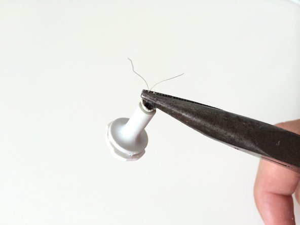

    • To reuse the plastic stopper, using whatever you want (I used a cutting plier), remove as much of the white plastic as to still leave the lip for further reattachment.
    • Using your normal pliers and/or a fine screwdriver/knife, try to jam out a little metal part that is clipping the two wires and attaching them to the white plastic.
    • Next, pull out all the wires.
  8. How to Repair an Apple AC Adapter Broken Cable: crwdns2935265:08crwdnd2935265:01crwdnd2935265:03crwdne2935265:0 How to Repair an Apple AC Adapter Broken Cable: crwdns2935265:08crwdnd2935265:02crwdnd2935265:03crwdne2935265:0 How to Repair an Apple AC Adapter Broken Cable: crwdns2935265:08crwdnd2935265:03crwdnd2935265:03crwdne2935265:0
    • The plastic mantle of the wire will still likely be attached to the plastic stopper.
    • To get it out, sprinkle the thing with some rubbing alcohol (or water).
    • Then, push it out with a bigger screwdriver head.
    • This took the most time in my case, so, be patient—it'll give up eventually.

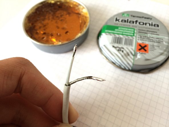

    • Using a soldering iron/gun, apply solder to all 4 ends of the wires.

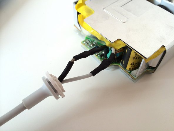

  13. How to Repair an Apple AC Adapter Broken Cable: crwdns2935265:013crwdnd2935265:01crwdnd2935265:03crwdne2935265:0 How to Repair an Apple AC Adapter Broken Cable: crwdns2935265:013crwdnd2935265:02crwdnd2935265:03crwdne2935265:0 How to Repair an Apple AC Adapter Broken Cable: crwdns2935265:013crwdnd2935265:03crwdnd2935265:03crwdne2935265:0
    • Add 2 lengths of shrink-tube on the 2 wires.
    • Now, solder the 4 wires together.
    • Make sure to connect white to white, and black to the bare metal one.
    • Make sure to do this step really quickly, as the heat-shrink tube will contract from the heat of the soldering.
    • Alternatively, you could just use duct tape—just be careful so it doesn't slide off when you're bending the wires.
    • Move the shirk-tube over the soldering spots, and heat it up. (Mine fell a bit short, so I did end up using a bit of duct tape.)
