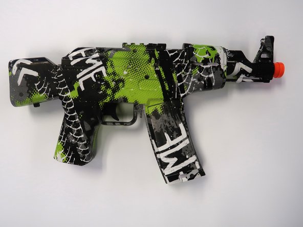

    • Set your gel blaster flat on a table.
    • Push the battery compartment release tab upwards.
    • Lift the battery cover and remove it.

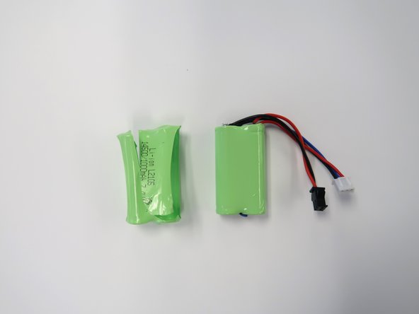

  4. How to Repair an Anstoy Electric AKM-47 Gel Blaster Battery: crwdns2935265:04crwdnd2935265:01crwdnd2935265:02crwdne2935265:0 How to Repair an Anstoy Electric AKM-47 Gel Blaster Battery: crwdns2935265:04crwdnd2935265:02crwdnd2935265:02crwdne2935265:0
    • Use utility scissors to cut the first green layer of the battery.
    • Remove the first layer to expose the connection to the wire.
    • Be careful when cutting the top layer, and do not remove the inner plastic layer.

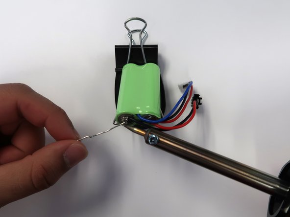

  5. How to Repair an Anstoy Electric AKM-47 Gel Blaster Battery: crwdns2935265:05crwdnd2935265:01crwdnd2935265:02crwdne2935265:0 How to Repair an Anstoy Electric AKM-47 Gel Blaster Battery: crwdns2935265:05crwdnd2935265:02crwdnd2935265:02crwdne2935265:0
    • Using the soldering iron and the lead-free solder, re-solder the wire to the battery to ensure a stable connection.
    • If there is any confusion on how to solder, please refer to the link below: How To Solder and Desolder Connections
