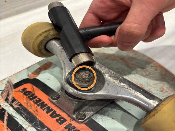

    • Lay the skateboard upside down so the wheels are facing upwards.
    • Use the skate tool to remove the screws that secure the trucks to the board.
    • Two small screws on both ends of the board
    • One big screw on both ends of the board
    • Some boards don't have the same design for screws, however the process is the same and this should help you figure out how to remove it for your own board as well.

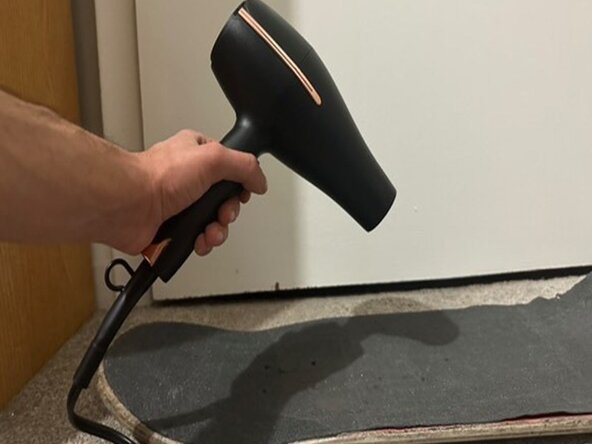

    • Dry the board with a towel.
    • Put the hair dryer on heat mode and move the hot air over the grip tape until the adhesive softens.
    • Ensure that majority of the water is dried up.

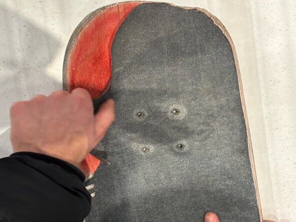

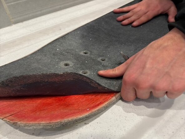

    • Use one hand to hold the board down and peel the grip tape off with your other hand.

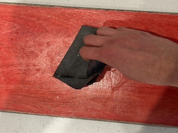

    • Use 150-grit sandpaper to remove any uneven rough spots.
    • Use the 220-grit sandpaper to lightly sand the surface until it feels even and smooth to the touch.

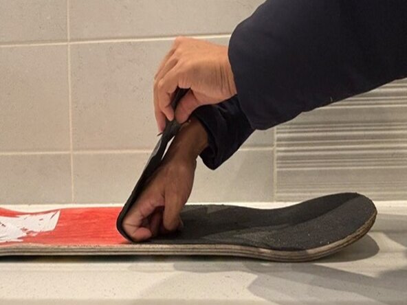

    • Line up the new grip tape and start applying it to the board.
    • Use one hand to lead the tape, and the other to press down while you move forward.
    • Carefully and evenly place new grip tape on skateboard and use your skate tool to trace the shape of the board.
    • Press down on the tape one last to ensure that it sticks properly.
