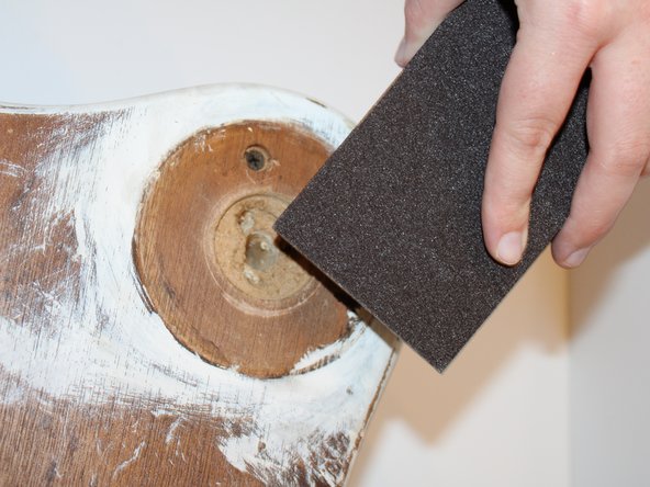

  3. How to Repair a Table Leg With Dry Rot: crwdns2935265:03crwdnd2935265:01crwdnd2935265:02crwdne2935265:0 How to Repair a Table Leg With Dry Rot: crwdns2935265:03crwdnd2935265:02crwdnd2935265:02crwdne2935265:0
    • Gently sand the socket with a sanding block or a thin piece of sandpaper.
    • Repeat this action with the table leg if needed.
    • The grit of the sandpaper is up to you, and ultimately depends on the roughness of the decaying wood.
    • Clear out the dust from the socket once you are done sanding.

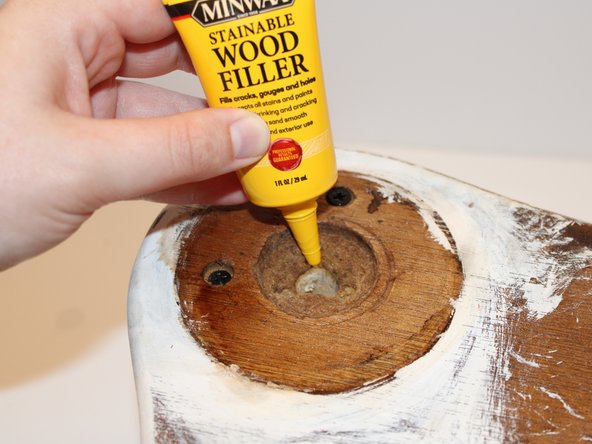

  4. How to Repair a Table Leg With Dry Rot: crwdns2935265:04crwdnd2935265:01crwdnd2935265:02crwdne2935265:0 How to Repair a Table Leg With Dry Rot: crwdns2935265:04crwdnd2935265:02crwdnd2935265:02crwdne2935265:0
    • This step is optional and should only be completed if the rot has made the socket uneven or jagged.
    • Use the wood filler to round out any uneven or jagged divots in the socket or around the screw holes.

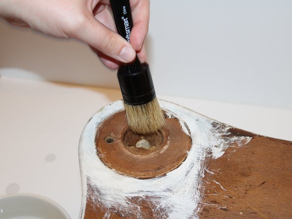

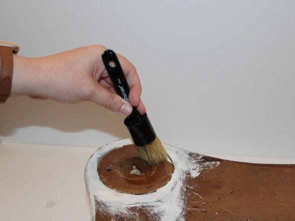

  5. How to Repair a Table Leg With Dry Rot: crwdns2935265:05crwdnd2935265:01crwdnd2935265:03crwdne2935265:0 How to Repair a Table Leg With Dry Rot: crwdns2935265:05crwdnd2935265:02crwdnd2935265:03crwdne2935265:0 How to Repair a Table Leg With Dry Rot: crwdns2935265:05crwdnd2935265:03crwdnd2935265:03crwdne2935265:0
    • Pour the wood hardener into a small jar or bowl.
    • This is a strong chemical. If you do not have a steady hand, protective gloves are recommended. If you do spill this chemical on your skin, stop what you are doing immediately and wash the point of contact with soap and water.
    • Take a small bristle brush and evenly coat the inside and outside of the socket.
    • Allow the liquid to completely soak into the wood and dry before moving on to the next step.

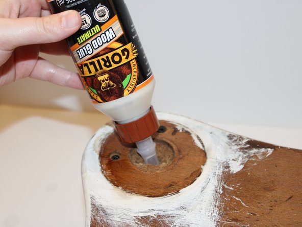

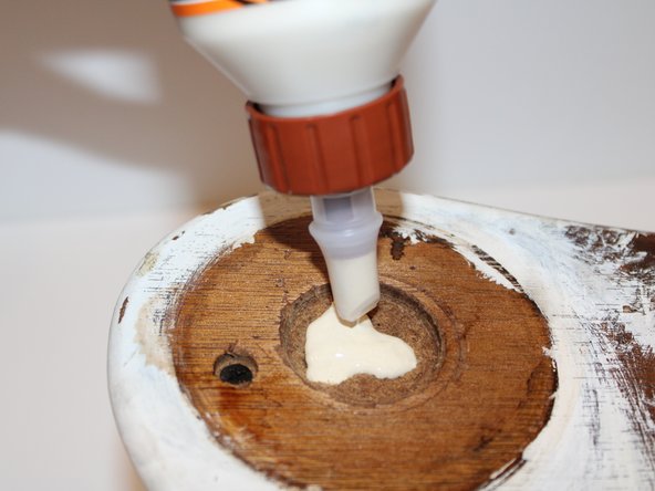

  6. How to Repair a Table Leg With Dry Rot: crwdns2935265:06crwdnd2935265:01crwdnd2935265:03crwdne2935265:0 How to Repair a Table Leg With Dry Rot: crwdns2935265:06crwdnd2935265:02crwdnd2935265:03crwdne2935265:0 How to Repair a Table Leg With Dry Rot: crwdns2935265:06crwdnd2935265:03crwdnd2935265:03crwdne2935265:0
    • Fill the socket with a generous amount of wood glue.
    • Depending on your table and how it is constructed, you may need a different kind of bonding agent for this step.

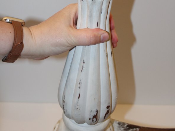

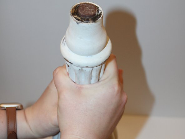

  7. How to Repair a Table Leg With Dry Rot: crwdns2935265:07crwdnd2935265:01crwdnd2935265:03crwdne2935265:0 How to Repair a Table Leg With Dry Rot: crwdns2935265:07crwdnd2935265:02crwdnd2935265:03crwdne2935265:0 How to Repair a Table Leg With Dry Rot: crwdns2935265:07crwdnd2935265:03crwdnd2935265:03crwdne2935265:0
    • Align your table leg evenly with the socket.
    • With both hands, push the leg firmly into the socket.
    • If needed, straighten the alignment of the leg before moving on to the next step. Do this before the glue becomes tacky.

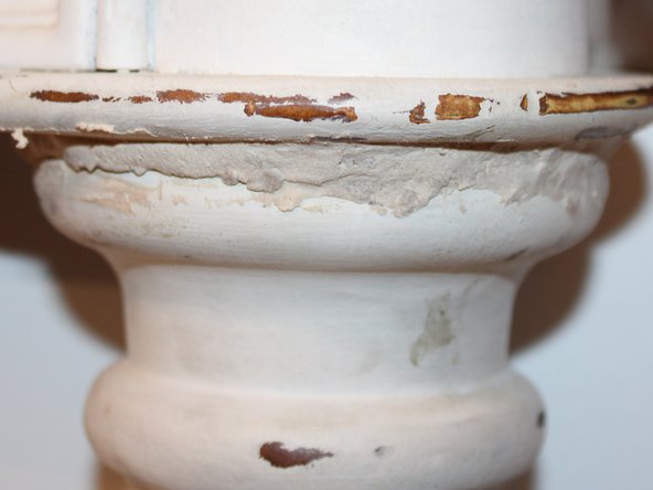

  8. How to Repair a Table Leg With Dry Rot: crwdns2935265:08crwdnd2935265:01crwdnd2935265:02crwdne2935265:0 How to Repair a Table Leg With Dry Rot: crwdns2935265:08crwdnd2935265:02crwdnd2935265:02crwdne2935265:0
    • This step is optional, but is strongly recommended.
    • Pinch off a piece of the wood epoxy putty.
    • With your finger, push the epoxy putty into any gaps between the leg and the table.
    • Make sure that the gaps are sealed with the putty before proceeding to the final step.

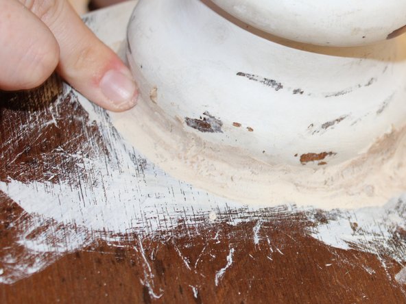

  9. How to Repair a Table Leg With Dry Rot: crwdns2935265:09crwdnd2935265:01crwdnd2935265:02crwdne2935265:0 How to Repair a Table Leg With Dry Rot: crwdns2935265:09crwdnd2935265:02crwdnd2935265:02crwdne2935265:0
    • Flip the table over with assistance and make sure it is seated firmly on all four legs.
    • Double check the alignment of the leg one last time and make sure that it is straight.
    • Allow the glue and the epoxy putty to harden and dry for at least 48 hours.
Make sure to allow all of the materials the proper time to cure and dry according to the instructions on their packaging before attempting to move the table. After that, your project is finished and yours to do with what you will!
