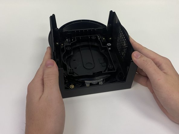

  3. How to Repair a Stuck GameCube Eject Button: crwdns2935265:03crwdnd2935265:01crwdnd2935265:02crwdne2935265:0 How to Repair a Stuck GameCube Eject Button: crwdns2935265:03crwdnd2935265:02crwdnd2935265:02crwdne2935265:0
    • Carefully lift off the top shell of the GameCube housing.
    • Flip over the top housing of the GameCube, making sure the handle is facing away from you.

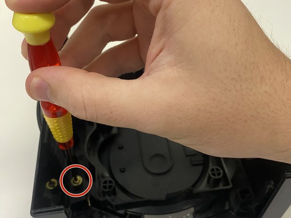

  4. How to Repair a Stuck GameCube Eject Button: crwdns2935265:04crwdnd2935265:01crwdnd2935265:02crwdne2935265:0 How to Repair a Stuck GameCube Eject Button: crwdns2935265:04crwdnd2935265:02crwdnd2935265:02crwdne2935265:0
    • Remove the two screws in the bottom left and right corners using a Phillips #00 screwdriver.
    • Have caution while removing the screws from the housing to prevent damage to any components.

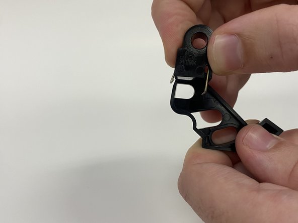

  5. How to Repair a Stuck GameCube Eject Button: crwdns2935265:05crwdnd2935265:01crwdnd2935265:02crwdne2935265:0 How to Repair a Stuck GameCube Eject Button: crwdns2935265:05crwdnd2935265:02crwdnd2935265:02crwdne2935265:0
    • Pull back on the lower section of the spring mechanism until the spring is fully compressed.
    • Lift the spring mechanism out of the GameCube's top housing and place it to the side.

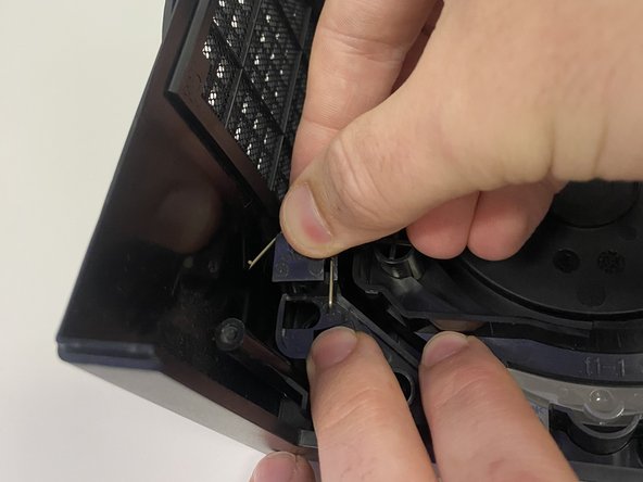

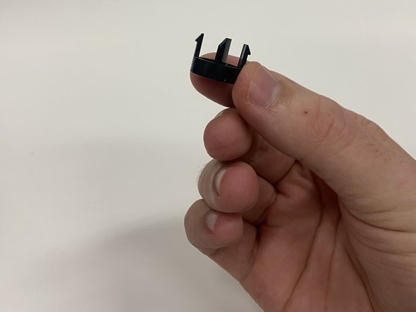

  6. How to Repair a Stuck GameCube Eject Button: crwdns2935265:06crwdnd2935265:01crwdnd2935265:03crwdne2935265:0 How to Repair a Stuck GameCube Eject Button: crwdns2935265:06crwdnd2935265:02crwdnd2935265:03crwdne2935265:0 How to Repair a Stuck GameCube Eject Button: crwdns2935265:06crwdnd2935265:03crwdnd2935265:03crwdne2935265:0
    • Pinch in the two small tabs from the eject button inside the GameCube's top housing.
    • Push the button out on the top-side of the GameCube's top housing.

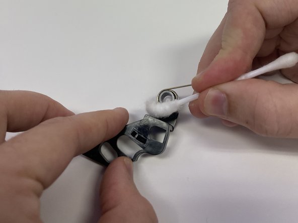

  7. How to Repair a Stuck GameCube Eject Button: crwdns2935265:07crwdnd2935265:01crwdnd2935265:02crwdne2935265:0 How to Repair a Stuck GameCube Eject Button: crwdns2935265:07crwdnd2935265:02crwdnd2935265:02crwdne2935265:0
    • Dip one end of a cotton swab in 91% isopropyl alcohol.
    • Wipe away any dust or grime from the spring mechanism with the wet cotton swab.
    • Let the spring mechanism dry for one minute.
    • Use the dry end of a cotton swab to clean up any leftover dust or isopropyl alcohol after the spring mechanism dries.

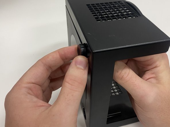

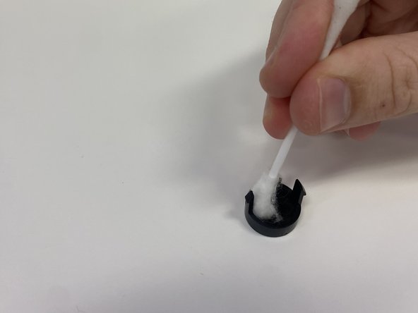

  8. How to Repair a Stuck GameCube Eject Button: crwdns2935265:08crwdnd2935265:01crwdnd2935265:02crwdne2935265:0 How to Repair a Stuck GameCube Eject Button: crwdns2935265:08crwdnd2935265:02crwdnd2935265:02crwdne2935265:0
    • Dip one end of a new cotton swab into 91% isopropyl alcohol.
    • Use the new wet cotton swab to clean away any dust or grime on the eject button.
    • Let the eject button dry for one minute.
    • Wipe away any missed dust or any remaining isopropyl alcohol with the dry end of the cotton swab.

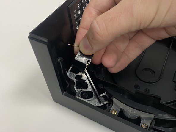

  9. How to Repair a Stuck GameCube Eject Button: crwdns2935265:09crwdnd2935265:01crwdnd2935265:03crwdne2935265:0 How to Repair a Stuck GameCube Eject Button: crwdns2935265:09crwdnd2935265:02crwdnd2935265:03crwdne2935265:0 How to Repair a Stuck GameCube Eject Button: crwdns2935265:09crwdnd2935265:03crwdnd2935265:03crwdne2935265:0
    • Push the spring section of the spring mechanism in so that it lays flat along the plastic piece.
    • Place the spring mechanism into the housing with the spring bent down and pressed against the side of the housing.
To reassemble your device, perform steps 6 through 1 in reverse.
