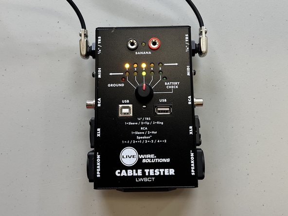

    • Verify that the cable is faulty (unresponsive yellow and green LED indicators).
    • Yellow LED indicator
    • Green LED indicator
    • If both the yellow and green LED indicators turn on, then the cable is not the source of any audio loss. Check the pedals, amp, guitar, or power supply for issues.
    • If the red LED turns on, then the cable is shorting and will also require a resolder.

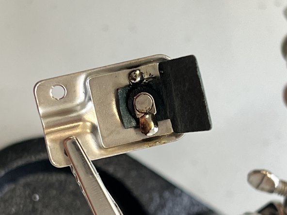

    • Desolder the existing solder connections.
    • Wick the existing solder completely off of the plug connections.
    • Do not touch the plug or the wick directly while desoldering.

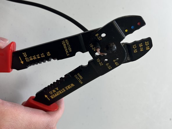

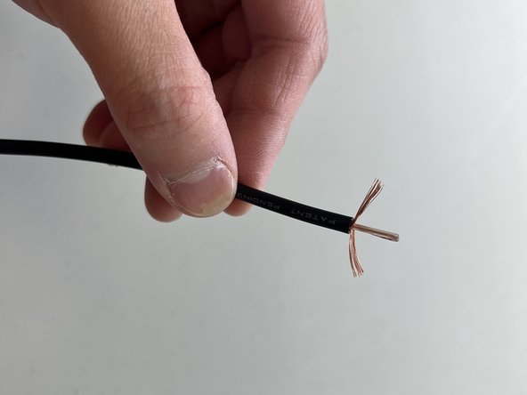

    • Cut the ends of the cable using a pair of wire cutters to expose fresh wires.
  5. How to Repair a Squareplug Patch Cable with SP400 Plugs: crwdns2935265:05crwdnd2935265:01crwdnd2935265:03crwdne2935265:0 How to Repair a Squareplug Patch Cable with SP400 Plugs: crwdns2935265:05crwdnd2935265:02crwdnd2935265:03crwdne2935265:0 How to Repair a Squareplug Patch Cable with SP400 Plugs: crwdns2935265:05crwdnd2935265:03crwdnd2935265:03crwdne2935265:0

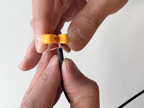

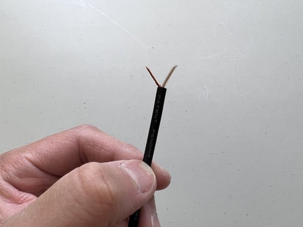

    • Strip the outer insulating jacket by ~1 cm.
    • The Eclipse UTP Stripper works especially well for this step.
    • Braid the ground wires.
  6. How to Repair a Squareplug Patch Cable with SP400 Plugs: crwdns2935265:06crwdnd2935265:01crwdnd2935265:03crwdne2935265:0 How to Repair a Squareplug Patch Cable with SP400 Plugs: crwdns2935265:06crwdnd2935265:02crwdnd2935265:03crwdne2935265:0 How to Repair a Squareplug Patch Cable with SP400 Plugs: crwdns2935265:06crwdnd2935265:03crwdnd2935265:03crwdne2935265:0

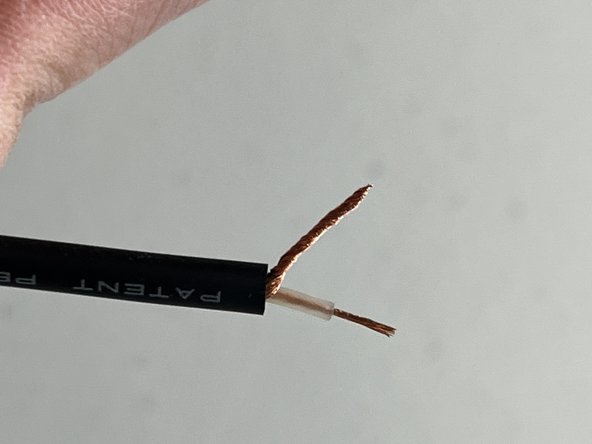

    • Strip the inner insulator by ~2mm.
    • Braid the signal wires.

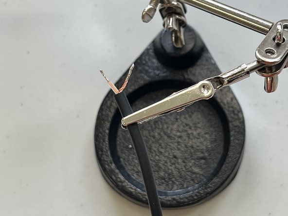

    • Tin the soldering iron tip, ground wire, signal wire, and plug connections.
    • Do not touch the plug or the solder directly while tinning.
  8. How to Repair a Squareplug Patch Cable with SP400 Plugs: crwdns2935265:08crwdnd2935265:01crwdnd2935265:02crwdne2935265:0 How to Repair a Squareplug Patch Cable with SP400 Plugs: crwdns2935265:08crwdnd2935265:02crwdnd2935265:02crwdne2935265:0

    • Verify that the cable is working (responsive yellow and green LED indicators).
