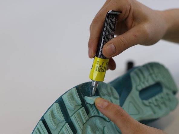

  3. How to Repair a Sole Delamination From the Midsole, Prepare the Shoe Glue: crwdns2935265:03crwdnd2935265:01crwdnd2935265:03crwdne2935265:0 How to Repair a Sole Delamination From the Midsole, Prepare the Shoe Glue: crwdns2935265:03crwdnd2935265:02crwdnd2935265:03crwdne2935265:0 How to Repair a Sole Delamination From the Midsole, Prepare the Shoe Glue: crwdns2935265:03crwdnd2935265:03crwdnd2935265:03crwdne2935265:0

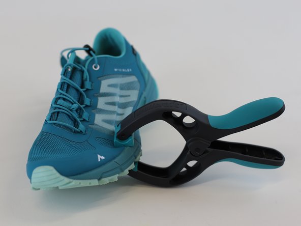

    • Apply the glue to both the sole and the separated part.
    • Apply pressure using clamps.
    • Note: Follow the instructions of the glue used to know the exact drying time. In this example we left the product to dry overnight.
  4. How to Repair a Sole Delamination From the Midsole, Finished and ready!: crwdns2935265:04crwdnd2935265:01crwdnd2935265:01crwdne2935265:0
