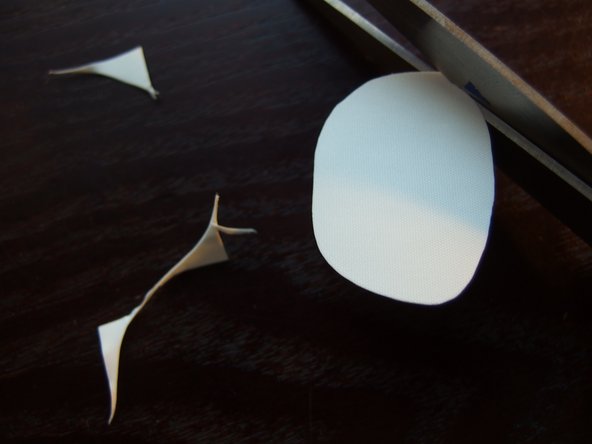

    • Trim the tape down until there is 1/2-3/4 of an inch excess on all sides of the tear.
  3. How to Repair a Small Tear in a Sail: crwdns2935265:03crwdnd2935265:01crwdnd2935265:02crwdne2935265:0 How to Repair a Small Tear in a Sail: crwdns2935265:03crwdnd2935265:02crwdnd2935265:02crwdne2935265:0
    • Round the corners of the tape.
    • Rounding the corners will prevent peeling and fraying.

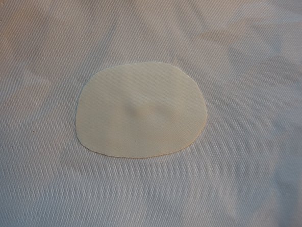

  4. How to Repair a Small Tear in a Sail: crwdns2935265:04crwdnd2935265:01crwdnd2935265:01crwdne2935265:0
    • Peel the backing off of the sail tape.
  5. How to Repair a Small Tear in a Sail: crwdns2935265:05crwdnd2935265:01crwdnd2935265:01crwdne2935265:0
    • Place the tape over the tear.
  6. How to Repair a Small Tear in a Sail: crwdns2935265:06crwdnd2935265:01crwdnd2935265:01crwdne2935265:0
    • Flip the sail over.
  7. How to Repair a Small Tear in a Sail: crwdns2935265:07crwdnd2935265:01crwdnd2935265:02crwdne2935265:0 How to Repair a Small Tear in a Sail: crwdns2935265:07crwdnd2935265:02crwdnd2935265:02crwdne2935265:0
    • Repeat steps 1-5 on the back side of the tear.
