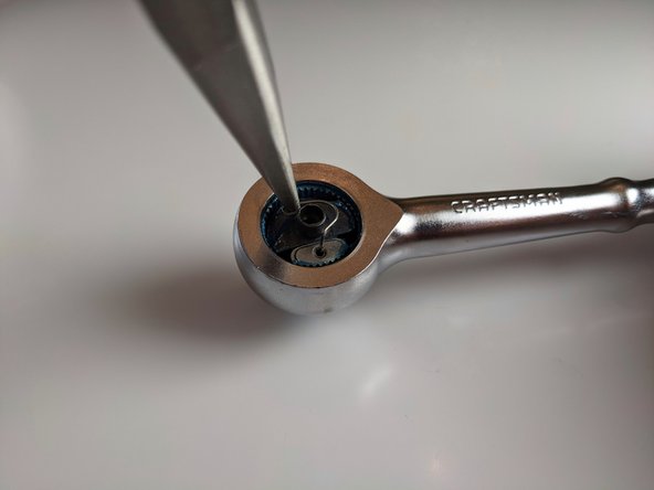

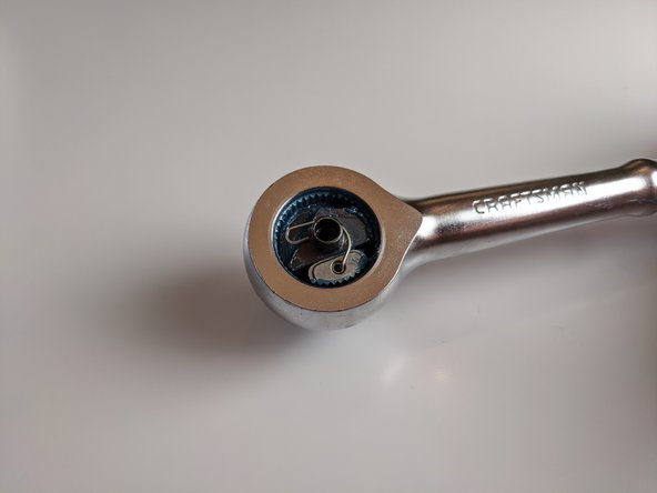

    • Remove the direction selector dial by turning it counterclockwise with a T15 screwdriver.
  2. How to Repair a Round Head Ratchet: crwdns2935265:02crwdnd2935265:01crwdnd2935265:03crwdne2935265:0 How to Repair a Round Head Ratchet: crwdns2935265:02crwdnd2935265:02crwdnd2935265:03crwdne2935265:0 How to Repair a Round Head Ratchet: crwdns2935265:02crwdnd2935265:03crwdnd2935265:03crwdne2935265:0

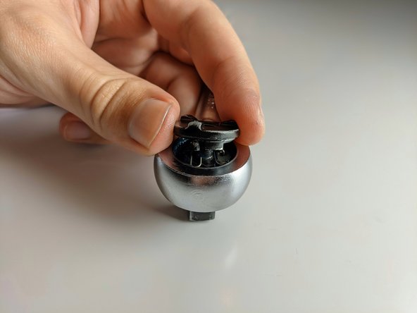

    • Lift up on the direction selector dial to remove it.
    • Be careful to keep the heart spring in place during removal.

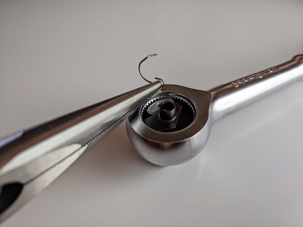

  3. How to Repair a Round Head Ratchet: crwdns2935265:03crwdnd2935265:01crwdnd2935265:03crwdne2935265:0 How to Repair a Round Head Ratchet: crwdns2935265:03crwdnd2935265:02crwdnd2935265:03crwdne2935265:0 How to Repair a Round Head Ratchet: crwdns2935265:03crwdnd2935265:03crwdnd2935265:03crwdne2935265:0

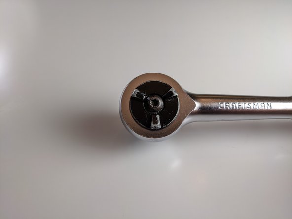

    • Lift up on the heart spring to remove it.

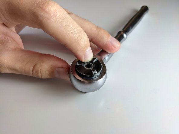

  4. How to Repair a Round Head Ratchet: crwdns2935265:04crwdnd2935265:01crwdnd2935265:03crwdne2935265:0 How to Repair a Round Head Ratchet: crwdns2935265:04crwdnd2935265:02crwdnd2935265:03crwdne2935265:0 How to Repair a Round Head Ratchet: crwdns2935265:04crwdnd2935265:03crwdnd2935265:03crwdne2935265:0

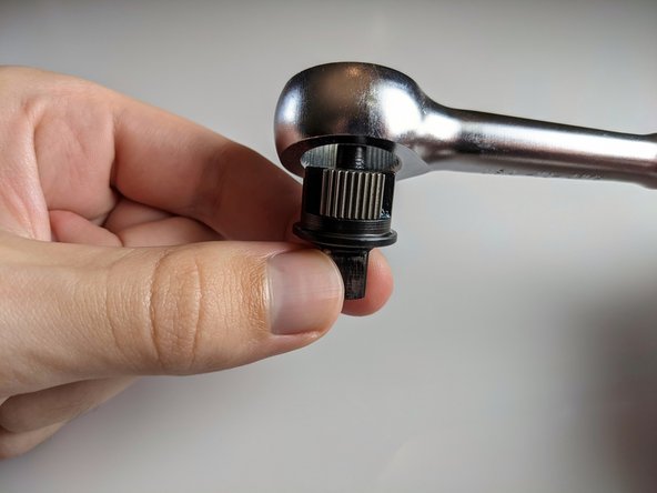

    • Remove the pawl and anvil by sliding them out of the ratchet handle.

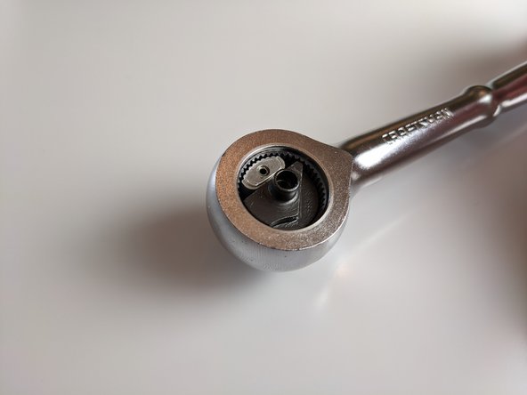

    • Clean all the old grease and dirt off the parts with a rag.

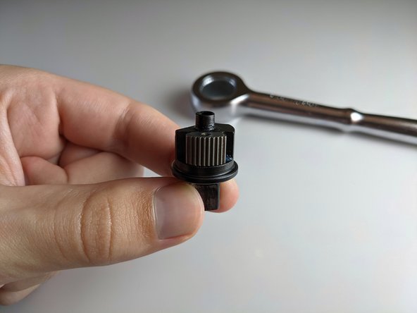

    • Lubricate the pawl and the teeth in the head of the ratchet handle with a light coat of multi-purpose grease.
