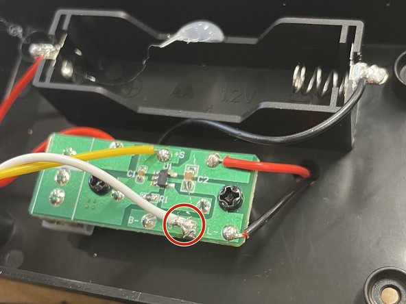

    • Check the circuit board for detached, or loosely connected wires.

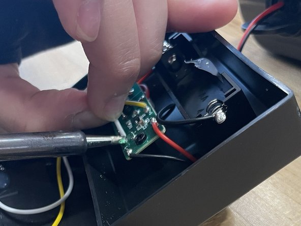

  5. How to Repair a Patio Solar Light: crwdns2935265:05crwdnd2935265:01crwdnd2935265:03crwdne2935265:0 How to Repair a Patio Solar Light: crwdns2935265:05crwdnd2935265:02crwdnd2935265:03crwdne2935265:0 How to Repair a Patio Solar Light: crwdns2935265:05crwdnd2935265:03crwdnd2935265:03crwdne2935265:0
    • Use a soldering iron at 400 Celsius to melt your soldering wire. Gather a droplet on the tip of the soldering iron, and use the drop to reattach the disconnected wire back onto the circuit board.
    • CAUTION: Don't handle metal parts of the soldering iron without proper gloves and protection.
