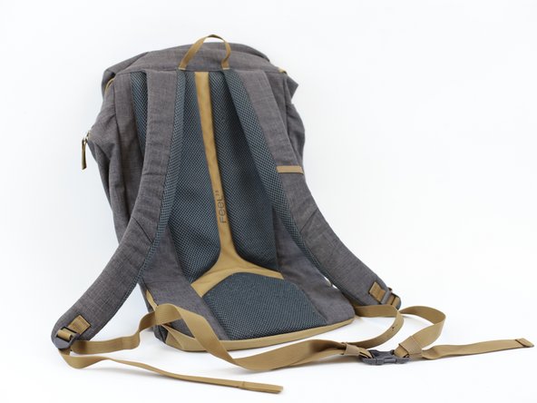

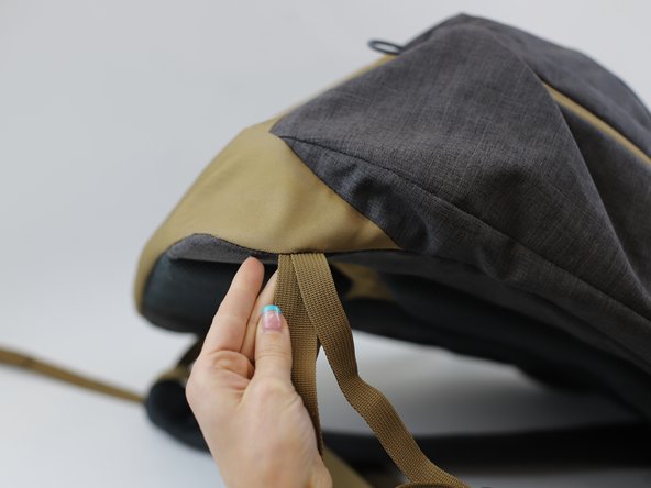

    • Identify the defective area and assess how large the damage is.

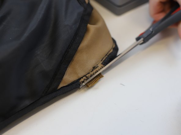

  2. How to Repair a Loose Webbing Strap in a Backpack, Prepare the straps: crwdns2935265:02crwdnd2935265:01crwdnd2935265:03crwdne2935265:0 How to Repair a Loose Webbing Strap in a Backpack, Prepare the straps: crwdns2935265:02crwdnd2935265:02crwdnd2935265:03crwdne2935265:0 How to Repair a Loose Webbing Strap in a Backpack, Prepare the straps: crwdns2935265:02crwdnd2935265:03crwdnd2935265:03crwdne2935265:0
    • Cut away the tips of the straps to create a clean surface to repair.
    • Note: In this example, we cut 2 cm away from the tip.
    • Pin the two straps together and set aside.

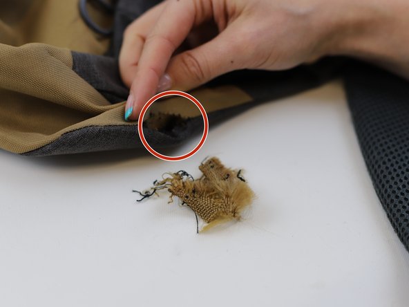

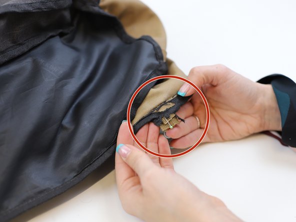

  3. How to Repair a Loose Webbing Strap in a Backpack, Clean the area: crwdns2935265:03crwdnd2935265:01crwdnd2935265:03crwdne2935265:0 How to Repair a Loose Webbing Strap in a Backpack, Clean the area: crwdns2935265:03crwdnd2935265:02crwdnd2935265:03crwdne2935265:0 How to Repair a Loose Webbing Strap in a Backpack, Clean the area: crwdns2935265:03crwdnd2935265:03crwdnd2935265:03crwdne2935265:0
    • Use a "seam ripper" tool to unstitch the remaining piece of strap.
    • Note: This will leave a hole in the border of the backpack (red circle), that will be useful in the next step.

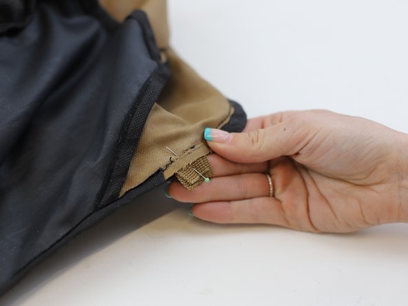

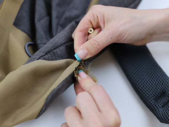

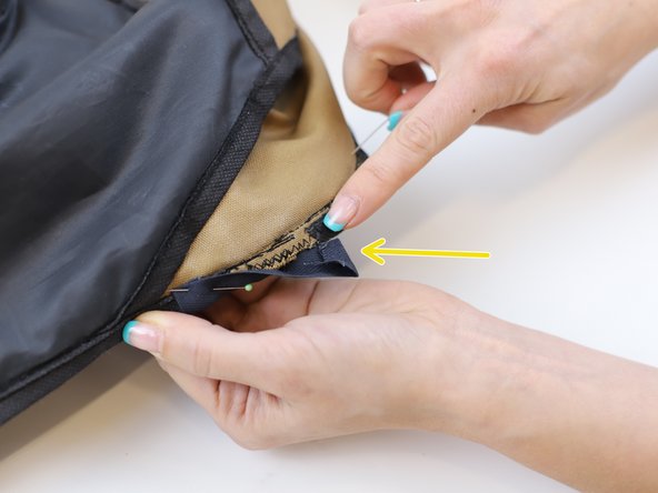

  4. How to Repair a Loose Webbing Strap in a Backpack, Hold the straps: crwdns2935265:04crwdnd2935265:01crwdnd2935265:03crwdne2935265:0 How to Repair a Loose Webbing Strap in a Backpack, Hold the straps: crwdns2935265:04crwdnd2935265:02crwdnd2935265:03crwdne2935265:0 How to Repair a Loose Webbing Strap in a Backpack, Hold the straps: crwdns2935265:04crwdnd2935265:03crwdnd2935265:03crwdne2935265:0
    • Insert the pinned straps inside the hole and use a safety pin to hold the pieces together.

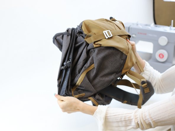

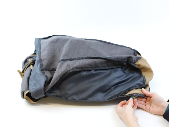

  5. How to Repair a Loose Webbing Strap in a Backpack, Turn the backpack inside-out: crwdns2935265:05crwdnd2935265:01crwdnd2935265:03crwdne2935265:0 How to Repair a Loose Webbing Strap in a Backpack, Turn the backpack inside-out: crwdns2935265:05crwdnd2935265:02crwdnd2935265:03crwdne2935265:0 How to Repair a Loose Webbing Strap in a Backpack, Turn the backpack inside-out: crwdns2935265:05crwdnd2935265:03crwdnd2935265:03crwdne2935265:0
    • Locate the straps that were inserted in the previous step (red circle).

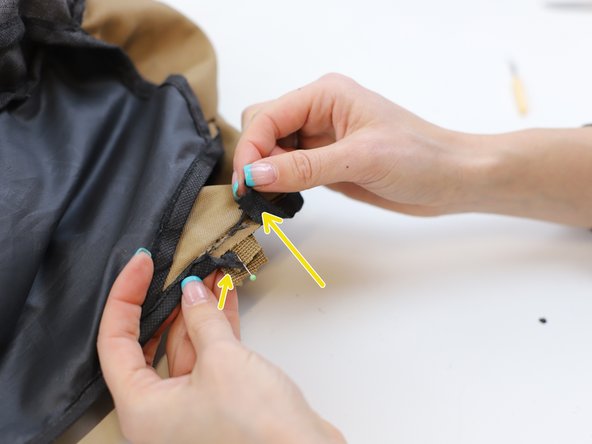

  6. How to Repair a Loose Webbing Strap in a Backpack, Clean the area before stitching: crwdns2935265:06crwdnd2935265:01crwdnd2935265:03crwdne2935265:0 How to Repair a Loose Webbing Strap in a Backpack, Clean the area before stitching: crwdns2935265:06crwdnd2935265:02crwdnd2935265:03crwdne2935265:0 How to Repair a Loose Webbing Strap in a Backpack, Clean the area before stitching: crwdns2935265:06crwdnd2935265:03crwdnd2935265:03crwdne2935265:0
    • Cut away the remaining pieces of the binding material that were present before (yellow arrows).

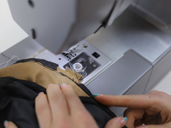

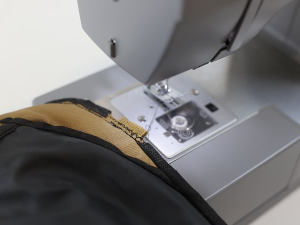

  7. How to Repair a Loose Webbing Strap in a Backpack, Stitch the strap: crwdns2935265:07crwdnd2935265:01crwdnd2935265:02crwdne2935265:0 How to Repair a Loose Webbing Strap in a Backpack, Stitch the strap: crwdns2935265:07crwdnd2935265:02crwdnd2935265:02crwdne2935265:0
    • Use a straight stitch to fix the strap in the right position.
    • Tip: For tips on setting up the machine take a look at this iFixit guide.

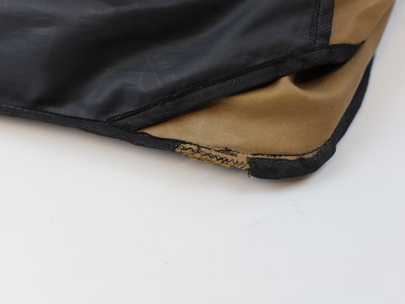

  8. How to Repair a Loose Webbing Strap in a Backpack, Reenforce the seam: crwdns2935265:08crwdnd2935265:01crwdnd2935265:03crwdne2935265:0 How to Repair a Loose Webbing Strap in a Backpack, Reenforce the seam: crwdns2935265:08crwdnd2935265:02crwdnd2935265:03crwdne2935265:0 How to Repair a Loose Webbing Strap in a Backpack, Reenforce the seam: crwdns2935265:08crwdnd2935265:03crwdnd2935265:03crwdne2935265:0
    • Change the settings in the sewing machine and switch from a "straight" to a "zigzag" stich.
    • Sew along the same line of the previous step.

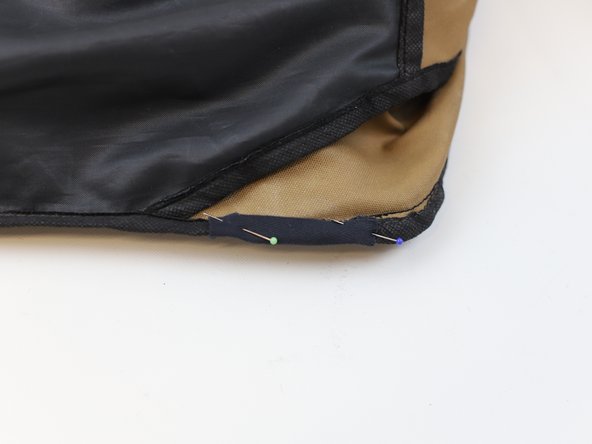

  10. How to Repair a Loose Webbing Strap in a Backpack, Pin the "binding" strap: crwdns2935265:010crwdnd2935265:01crwdnd2935265:03crwdne2935265:0 How to Repair a Loose Webbing Strap in a Backpack, Pin the "binding" strap: crwdns2935265:010crwdnd2935265:02crwdnd2935265:03crwdne2935265:0 How to Repair a Loose Webbing Strap in a Backpack, Pin the "binding" strap: crwdns2935265:010crwdnd2935265:03crwdnd2935265:03crwdne2935265:0
    • Select a "binding" material, it can be a strap or any spare textile you have at home.
    • Make sure it is the same length as the area you are trying to repair (red line).
    • Fold the side of binding strap inwards (yellow arrow) and fix the position using with pins.

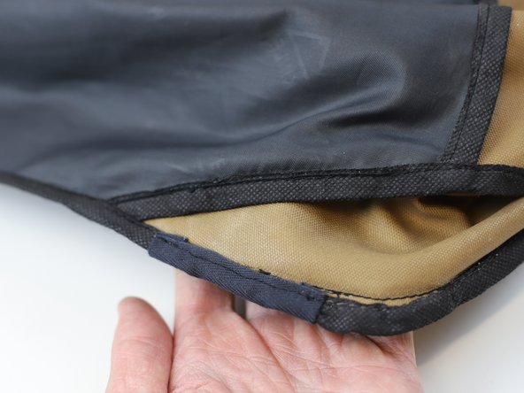

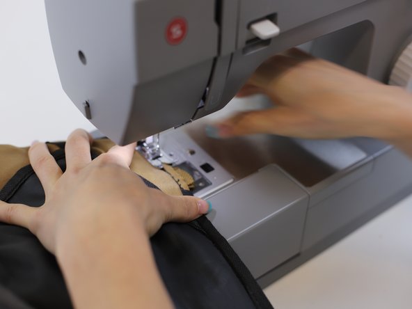

  11. How to Repair a Loose Webbing Strap in a Backpack, Sew the "binding" strap to the inner part: crwdns2935265:011crwdnd2935265:01crwdnd2935265:03crwdne2935265:0 How to Repair a Loose Webbing Strap in a Backpack, Sew the "binding" strap to the inner part: crwdns2935265:011crwdnd2935265:02crwdnd2935265:03crwdne2935265:0 How to Repair a Loose Webbing Strap in a Backpack, Sew the "binding" strap to the inner part: crwdns2935265:011crwdnd2935265:03crwdnd2935265:03crwdne2935265:0
    • Change the settings in the sewing machine and switch back to a "straight" stich.
    • Start sewing and remove any pins in the way of the sewing route.
    • Turn the backpack inside-out to return to the original position.
  12. How to Repair a Loose Webbing Strap in a Backpack, Finished and ready!: crwdns2935265:012crwdnd2935265:01crwdnd2935265:03crwdne2935265:0 How to Repair a Loose Webbing Strap in a Backpack, Finished and ready!: crwdns2935265:012crwdnd2935265:02crwdnd2935265:03crwdne2935265:0 How to Repair a Loose Webbing Strap in a Backpack, Finished and ready!: crwdns2935265:012crwdnd2935265:03crwdnd2935265:03crwdne2935265:0
    • 🛠️🏆👏 Congratulations! The repair is complete, and you're ready to go!
