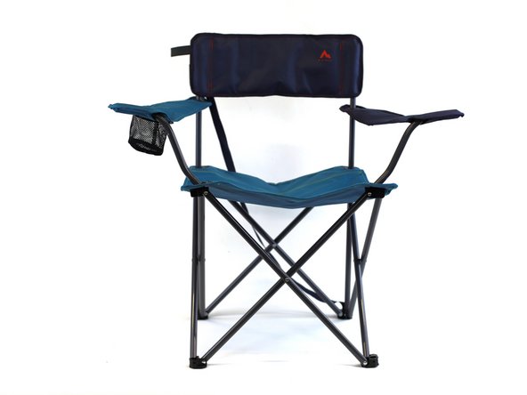

How to Repair a Loose Armrest in a Camping Chair
  1. How to Repair a Loose Armrest in a Camping Chair, Identify the repair area: crwdns2935265:01crwdnd2935265:01crwdnd2935265:03crwdne2935265:0 How to Repair a Loose Armrest in a Camping Chair, Identify the repair area: crwdns2935265:01crwdnd2935265:02crwdnd2935265:03crwdne2935265:0 How to Repair a Loose Armrest in a Camping Chair, Identify the repair area: crwdns2935265:01crwdnd2935265:03crwdnd2935265:03crwdne2935265:0
    • Locate the joint mechanism that connects the arm to the rest of the chair.
    • In this example, the arm of the chair used to be connected by a screw that has gone missing and now there are two holes left (red circles).

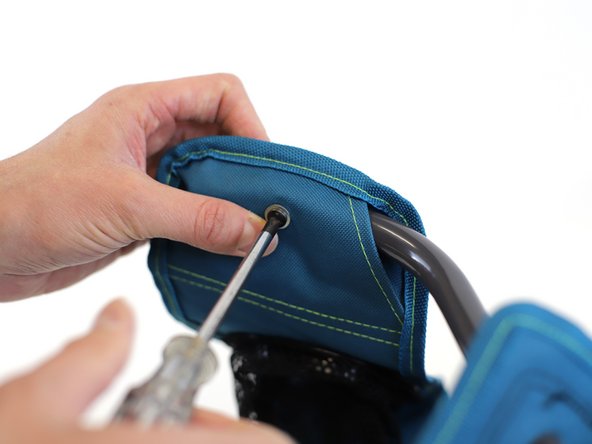

  2. How to Repair a Loose Armrest in a Camping Chair, Find a replacement screw: crwdns2935265:02crwdnd2935265:01crwdnd2935265:03crwdne2935265:0 How to Repair a Loose Armrest in a Camping Chair, Find a replacement screw: crwdns2935265:02crwdnd2935265:02crwdnd2935265:03crwdne2935265:0 How to Repair a Loose Armrest in a Camping Chair, Find a replacement screw: crwdns2935265:02crwdnd2935265:03crwdnd2935265:03crwdne2935265:0
    • Use the other chair arm as an example to find the right screw size (yellow circle).
    • Using a screwdriver, remove the screw from the chair arm.
    • Set this screw aside to check the replacement part.

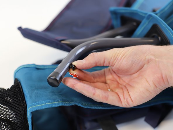

  3. How to Repair a Loose Armrest in a Camping Chair, Select and test the replacement: crwdns2935265:03crwdnd2935265:01crwdnd2935265:03crwdne2935265:0 How to Repair a Loose Armrest in a Camping Chair, Select and test the replacement: crwdns2935265:03crwdnd2935265:02crwdnd2935265:03crwdne2935265:0 How to Repair a Loose Armrest in a Camping Chair, Select and test the replacement: crwdns2935265:03crwdnd2935265:03crwdnd2935265:03crwdne2935265:0
    • Compare the example screw with the spare parts and choose the piece that resembles it the most.
    • Once you have selected the replacement, test it to see if it fits in the right size.
    • For the testing, introduce the screw and then try pushing it outwards (red arrow).
    • Note: The right replacement should stay in place.

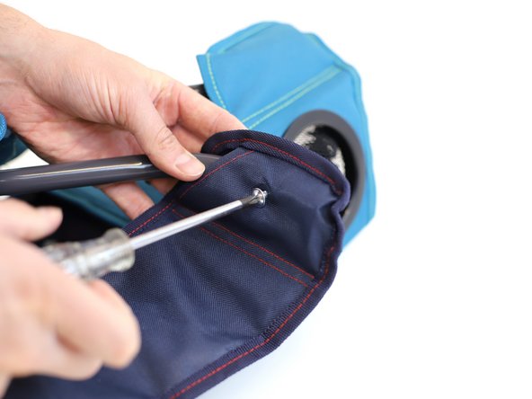

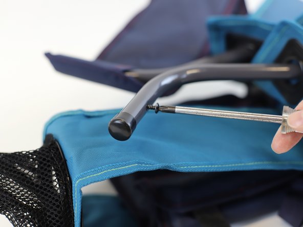

  4. How to Repair a Loose Armrest in a Camping Chair, Screw on the replacement: crwdns2935265:04crwdnd2935265:01crwdnd2935265:03crwdne2935265:0 How to Repair a Loose Armrest in a Camping Chair, Screw on the replacement: crwdns2935265:04crwdnd2935265:02crwdnd2935265:03crwdne2935265:0 How to Repair a Loose Armrest in a Camping Chair, Screw on the replacement: crwdns2935265:04crwdnd2935265:03crwdnd2935265:03crwdne2935265:0
    • Once you have the right replacement, you should screw the piece in the right place.
    • Tip: Make sure the the screw is passing through the cloth part and metal structure of the chair.
    • After securing the new replacement, you can reassemble the other chair arm that was used as an example.
  5. How to Repair a Loose Armrest in a Camping Chair, Finished and ready!: crwdns2935265:05crwdnd2935265:01crwdnd2935265:02crwdne2935265:0 How to Repair a Loose Armrest in a Camping Chair, Finished and ready!: crwdns2935265:05crwdnd2935265:02crwdnd2935265:02crwdne2935265:0
    • 🛠️🏆👏 Congratulations! The repair is complete, and you're ready to go!
