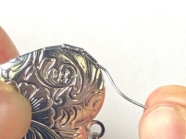

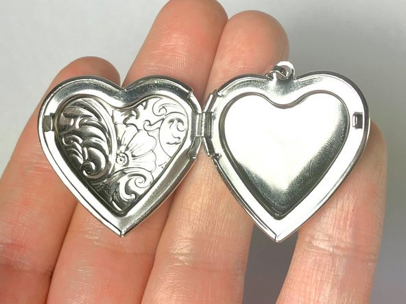

    • Use pliers to carefully bend the damaged hinge back into place.
    • You want the hinge to be rounded and hollow, like a straw.
    • Test the hinge with some wire. If you can easily thread the wire through, then you can move on to Step 2. If not, keep bending.

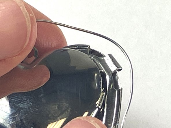

  2. How to Repair a Locket Hinge: crwdns2935265:02crwdnd2935265:01crwdnd2935265:03crwdne2935265:0 How to Repair a Locket Hinge: crwdns2935265:02crwdnd2935265:02crwdnd2935265:03crwdne2935265:0 How to Repair a Locket Hinge: crwdns2935265:02crwdnd2935265:03crwdnd2935265:03crwdne2935265:0
    • Hold both ends of the wire.
    • Place the middle of the wire against a hard edge. Hold the wire so that it is perpendicular to the edge.
    • Straighten the wire by pulling it against the edge.

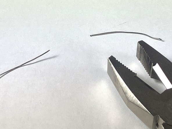

  4. How to Repair a Locket Hinge: crwdns2935265:04crwdnd2935265:01crwdnd2935265:02crwdne2935265:0 How to Repair a Locket Hinge: crwdns2935265:04crwdnd2935265:02crwdnd2935265:02crwdne2935265:0
    • Cut the wire to a manageable length. We suggest the length of the hinges plus some excess.

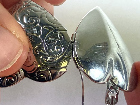

  5. How to Repair a Locket Hinge: crwdns2935265:05crwdnd2935265:01crwdnd2935265:03crwdne2935265:0 How to Repair a Locket Hinge: crwdns2935265:05crwdnd2935265:02crwdnd2935265:03crwdne2935265:0 How to Repair a Locket Hinge: crwdns2935265:05crwdnd2935265:03crwdnd2935265:03crwdne2935265:0

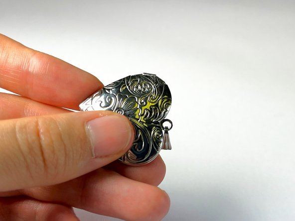

    • Match and align the front and back of the locket.
    • The holes of the hinge must be aligned, making a tunnel for the wire.
    • Line up the curved wire to match the locket shape.
    • Feed the wire through the hole of the hinge.

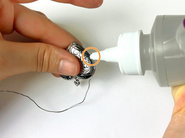

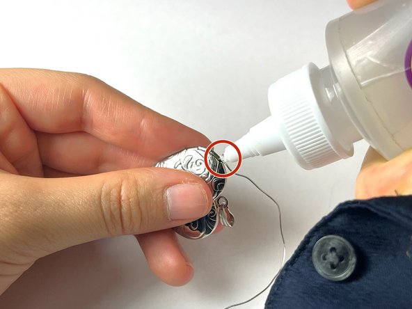

  6. How to Repair a Locket Hinge: crwdns2935265:06crwdnd2935265:01crwdnd2935265:03crwdne2935265:0 How to Repair a Locket Hinge: crwdns2935265:06crwdnd2935265:02crwdnd2935265:03crwdne2935265:0 How to Repair a Locket Hinge: crwdns2935265:06crwdnd2935265:03crwdnd2935265:03crwdne2935265:0
    • Hold the locket closed.
    • Glue the top of the hinge.
    • Glue the bottom of the hinge.
    • Do not glue the center of the hinge.

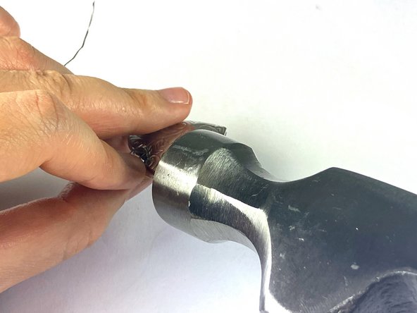

    • Hold the locket closed and hammer the side with the hinge and wire.
    • Tap firmly along the hinge and wire to secure.
