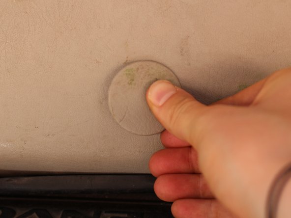

    • Use the flat head screwdriver to pry off the small round access panel on the interior of the tailgate.

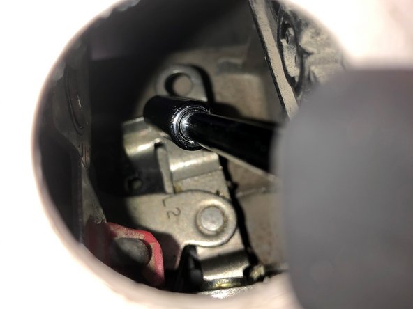

  2. How to Repair a Jammed 2007 GMC Envoy Tailgate: crwdns2935265:02crwdnd2935265:01crwdnd2935265:02crwdne2935265:0 How to Repair a Jammed 2007 GMC Envoy Tailgate: crwdns2935265:02crwdnd2935265:02crwdnd2935265:02crwdne2935265:0
    • Look through the opening and stick your flat head screwdriver underneath this metal arm.
    • Force the arm up. It should stay raised when you pull the screwdriver out.
    • DO NOT USE YOUR FINGER, there is risk of pinching and injury if you do not use the specified tools.

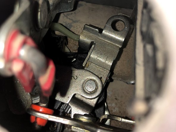

  3. How to Repair a Jammed 2007 GMC Envoy Tailgate: crwdns2935265:03crwdnd2935265:01crwdnd2935265:03crwdne2935265:0 How to Repair a Jammed 2007 GMC Envoy Tailgate: crwdns2935265:03crwdnd2935265:02crwdnd2935265:03crwdne2935265:0 How to Repair a Jammed 2007 GMC Envoy Tailgate: crwdns2935265:03crwdnd2935265:03crwdnd2935265:03crwdne2935265:0
    • Use the flat head screwdriver to push this second lever to the right as far as it will go or until it clicks.
  4. How to Repair a Jammed 2007 GMC Envoy Tailgate: crwdns2935265:04crwdnd2935265:01crwdnd2935265:02crwdne2935265:0 How to Repair a Jammed 2007 GMC Envoy Tailgate: crwdns2935265:04crwdnd2935265:02crwdnd2935265:02crwdne2935265:0
    • The tailgate is now unlatched. Open it from the outside.
    • Replace the access panel.
    • If the tailgate will still not open, you most likely did not push the second lever over far enough. Repeat Step 3.

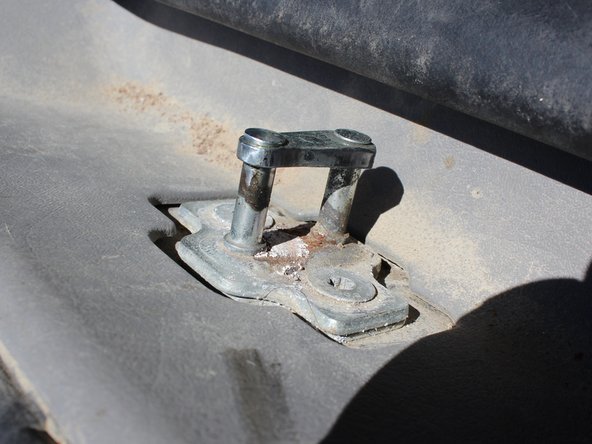

  5. How to Repair a Jammed 2007 GMC Envoy Tailgate: crwdns2935265:05crwdnd2935265:01crwdnd2935265:02crwdne2935265:0 How to Repair a Jammed 2007 GMC Envoy Tailgate: crwdns2935265:05crwdnd2935265:02crwdnd2935265:02crwdne2935265:0
    • Inspect the latch bracket's horizontal and vertical bars for dents, warping, and corrosion.
    • If there are no physical defects visible, clean any rust and corrosion and test the tailgate. If it still jams, repeat Steps 1-4 and move on to Step 6.
