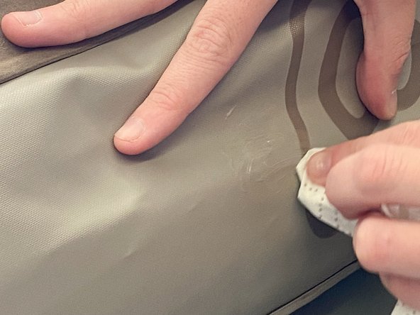

  3. How to Repair a Hole in an Air Mattress: crwdns2935265:03crwdnd2935265:01crwdnd2935265:01crwdne2935265:0
    • Clean around the hole where you plan to put the patch.
    • Use water and allow to air dry.
    • This will ensure a clean surface to attach the adhesive.
  4. How to Repair a Hole in an Air Mattress: crwdns2935265:04crwdnd2935265:01crwdnd2935265:02crwdne2935265:0 How to Repair a Hole in an Air Mattress: crwdns2935265:04crwdnd2935265:02crwdnd2935265:02crwdne2935265:0
    • Apply flexible adhesive made for vinyl where the patch is intended.
    • Use a brush or towel to spread adhesive to form an even layer.

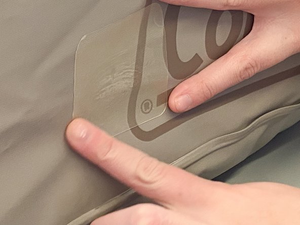

  5. How to Repair a Hole in an Air Mattress: crwdns2935265:05crwdnd2935265:01crwdnd2935265:02crwdne2935265:0 How to Repair a Hole in an Air Mattress: crwdns2935265:05crwdnd2935265:02crwdnd2935265:02crwdne2935265:0
    • Apply a piece of vinyl patch on top of the adhesive to cover the hole.
    • Smooth out patches to ensure there are no bumps or bubbles.
    • You can smooth out bubbles with your fingers or use a plastic card.
  6. How to Repair a Hole in an Air Mattress: crwdns2935265:06crwdnd2935265:01crwdnd2935265:01crwdne2935265:0
    • Allow the adhesive to fully dry per adhesive instructions before using the air mattress.
    • Enjoy your fixed air mattress!
