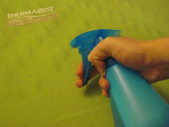

    • Spray soapy water on the section of the pad where you think the hole is located.
  4. How to Repair a Hole in a Therm-a-Rest Sleeping Pad: crwdns2935265:04crwdnd2935265:01crwdnd2935265:02crwdne2935265:0 How to Repair a Hole in a Therm-a-Rest Sleeping Pad: crwdns2935265:04crwdnd2935265:02crwdnd2935265:02crwdne2935265:0

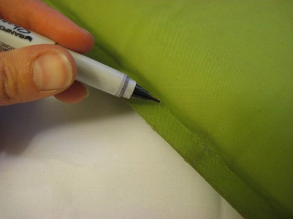

    • Look for small bubbles forming on the pad indicating the location of the hole.
    • Mark the hole with a marker.
    • If you cannot locate the hole with the soapy water, fill a bathtub with water, and submerge your pad. Look for small air bubbles escaping from the pad into the water indicating the location of the hole.

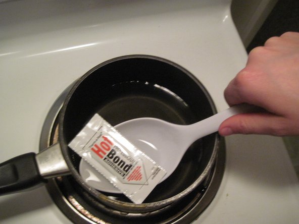

    • Obtain a Therm-a-Rest repair kit including a packet of HotBond Adhesive, patch, and wood stick or similar.
  6. How to Repair a Hole in a Therm-a-Rest Sleeping Pad: crwdns2935265:06crwdnd2935265:01crwdnd2935265:02crwdne2935265:0 How to Repair a Hole in a Therm-a-Rest Sleeping Pad: crwdns2935265:06crwdnd2935265:02crwdnd2935265:02crwdne2935265:0
    • Boil water in a flat bottomed pan.
    • Heat the HotBond Adhesive packet in the boiling water for three minutes.
    • Carefully remove the HotBond Adhesive from the water with a spoon.

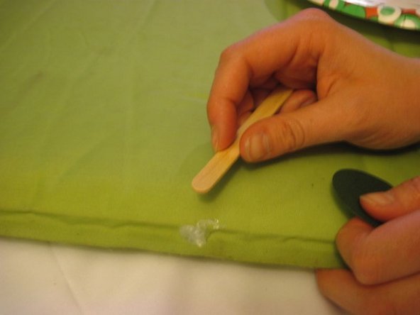

    • Tear off the end of the HotBond Adhesive packet.
    • Squeeze the adhesive out of the packet onto the hole in the pad.
    • Spread the adhesive with the wood stick until the adhesive is spread in an even circular layer approximately the size of a dime.

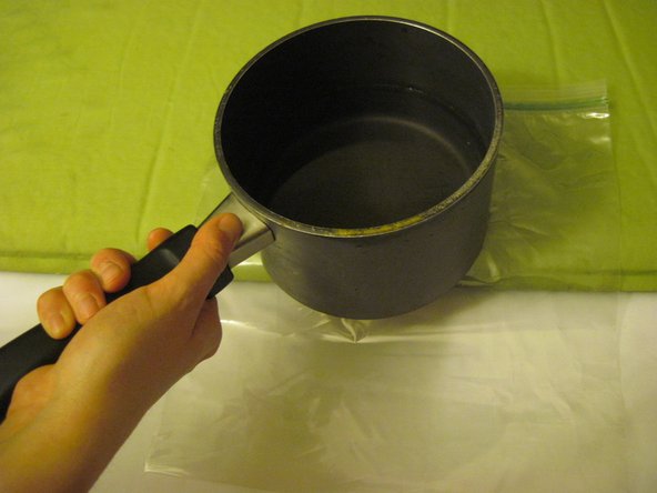

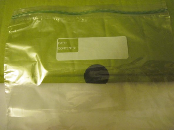

    • Firmly press the patch, shiny side down, onto the HotBond Adhesive on the mattress.
    • Place a layer of plastic, such as a plastic bag, over the patch.
    • Open the intake valve by turning the valve counter-clockwise.
    • Place the pan of hot water on top of the plastic layer and patch for one minute.
  9. How to Repair a Hole in a Therm-a-Rest Sleeping Pad: crwdns2935265:09crwdnd2935265:01crwdnd2935265:02crwdne2935265:0 How to Repair a Hole in a Therm-a-Rest Sleeping Pad: crwdns2935265:09crwdnd2935265:02crwdnd2935265:02crwdne2935265:0
    • Remove the pan of water, and using a hard cylindrical object, such as a cup, roll over the patch a few times.
    • Allow the patch to set for 10 minutes before use.
