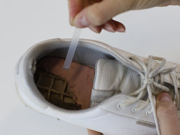

    • We will repair the hole in the outsole from the inside of the shoe by filling the grid structure with foam rubber pieces.
    • Remove the insole.
    • Note: In our case, the lasting board (pink) and the insole were glued together. Parts of the lasting board are ripped off now.

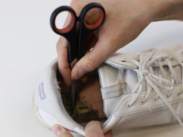

    • Use a scissor to remove the remaining parts of the lasting board around the outsole hole.
    • Estimate or measure the size of the single grids, which need to be filled.

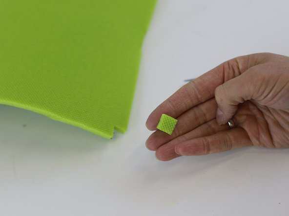

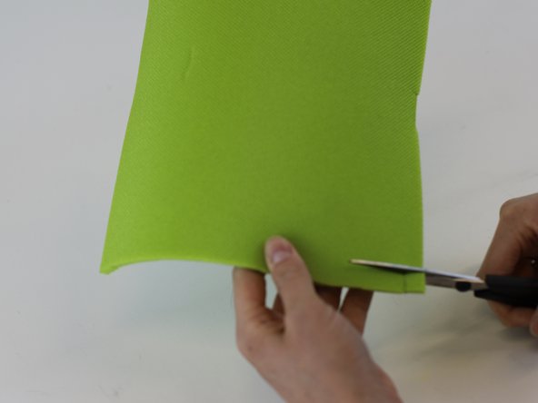

    • Prepare the piece of foam rubber, the scissors and the small utility knife.
    • Cut out the rectangular filling piece.

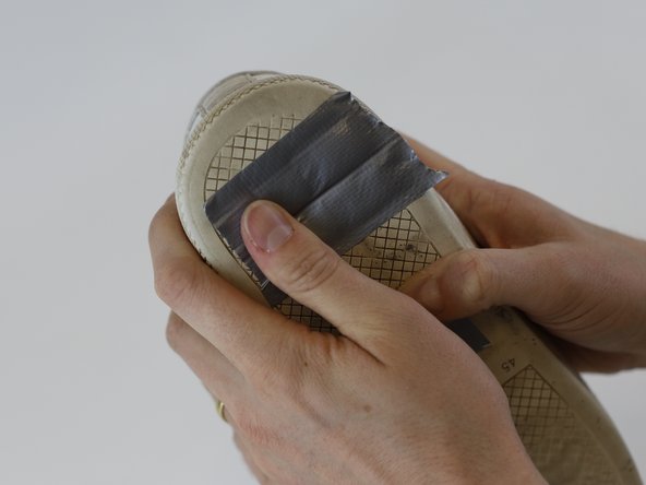

  5. How to Repair a Hole in a Shoe Sole, Temporarily seal the outsole hole: crwdns2935265:05crwdnd2935265:01crwdnd2935265:03crwdne2935265:0 How to Repair a Hole in a Shoe Sole, Temporarily seal the outsole hole: crwdns2935265:05crwdnd2935265:02crwdnd2935265:03crwdne2935265:0 How to Repair a Hole in a Shoe Sole, Temporarily seal the outsole hole: crwdns2935265:05crwdnd2935265:03crwdnd2935265:03crwdne2935265:0

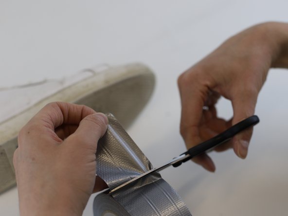

    • Cut a big enough part from the gaffa tape.
    • Cover the hole with the tape to avoid glue being squeezed out.

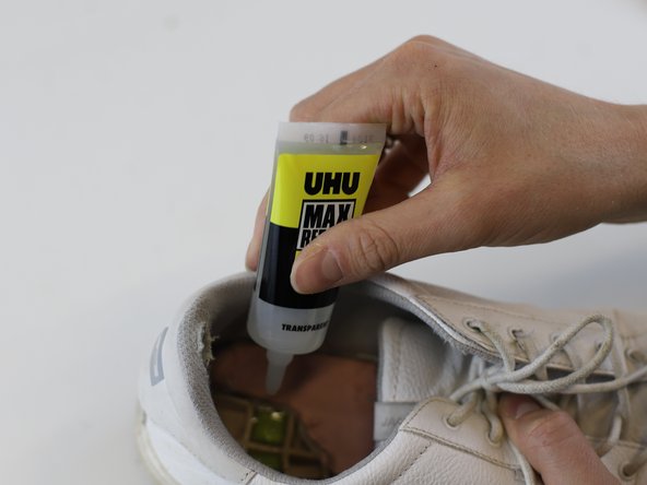

  6. How to Repair a Hole in a Shoe Sole, Prepare the grid with glue: crwdns2935265:06crwdnd2935265:01crwdnd2935265:03crwdne2935265:0 How to Repair a Hole in a Shoe Sole, Prepare the grid with glue: crwdns2935265:06crwdnd2935265:02crwdnd2935265:03crwdne2935265:0 How to Repair a Hole in a Shoe Sole, Prepare the grid with glue: crwdns2935265:06crwdnd2935265:03crwdnd2935265:03crwdne2935265:0

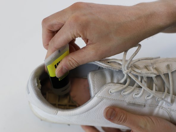

    • Use super glue for the grid hole and only apply it on the parts that need to be covered.
    • Use a small spatula to spread the glue evenly and let it dry.
    • Note: Follow the instructions of the glue used to know the exact drying time. In this example we left it a few minutes
