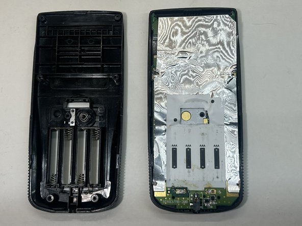

  5. How to Repair a Glitchy TI-83 Plus Screen: crwdns2935265:05crwdnd2935265:01crwdnd2935265:02crwdne2935265:0 How to Repair a Glitchy TI-83 Plus Screen: crwdns2935265:05crwdnd2935265:02crwdnd2935265:02crwdne2935265:0
    • Pry back shell off by Inserting the plastic opening tool in the track where the protective cover slides into and pry the halves of the shell apart.
  6. How to Repair a Glitchy TI-83 Plus Screen: crwdns2935265:06crwdnd2935265:01crwdnd2935265:02crwdne2935265:0 How to Repair a Glitchy TI-83 Plus Screen: crwdns2935265:06crwdnd2935265:02crwdnd2935265:02crwdne2935265:0
    • Remove the protective sheet from the mother board by unscrewing the two 1 mm Phillips #00 screws.

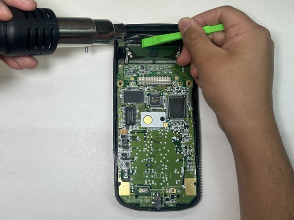

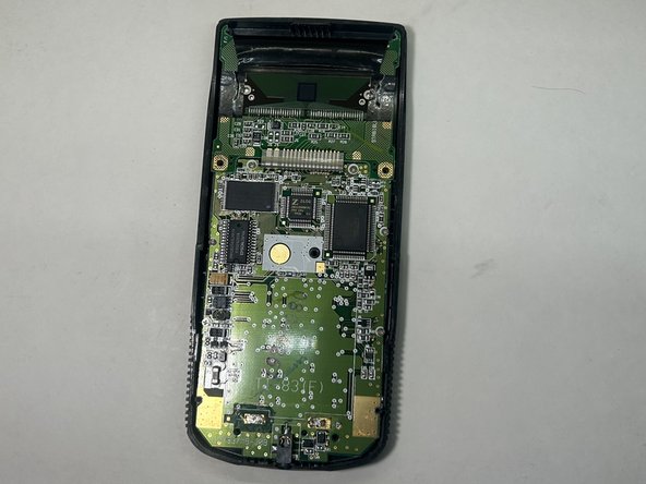

  7. How to Repair a Glitchy TI-83 Plus Screen: crwdns2935265:07crwdnd2935265:01crwdnd2935265:03crwdne2935265:0 How to Repair a Glitchy TI-83 Plus Screen: crwdns2935265:07crwdnd2935265:02crwdnd2935265:03crwdne2935265:0 How to Repair a Glitchy TI-83 Plus Screen: crwdns2935265:07crwdnd2935265:03crwdnd2935265:03crwdne2935265:0
    • Set your heat gun to the lowest setting(around 150 degrees)
    • If you are missing lines on the screen, aim at the top ribbon cables and heat the cable evenly for about 5 seconds.

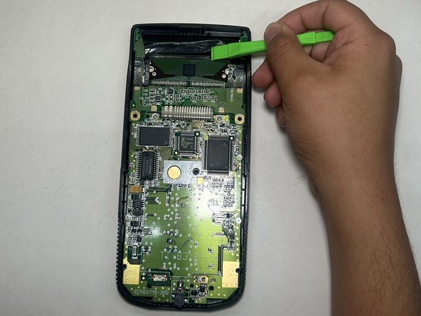

    • Then heat and apply pressure using the plastic opening tool for about 5-10 seconds, applying pressure to different sections of the ribbon cable within that timeframe.
    • Continue to apply pressure throughout the ribbons.
    • If the screen is Glitchy, do the same for the bottom ribbon cable.
