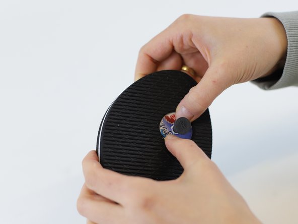

    • Re-insert the strap through the sole, as it should be for normal wearing. Then, pull the strap a bit further through from the bottom to give space for installing the washer.
    • Slide the washer between the outsole and the strap ending.
    • Pull the strap upwards to secure the washer.

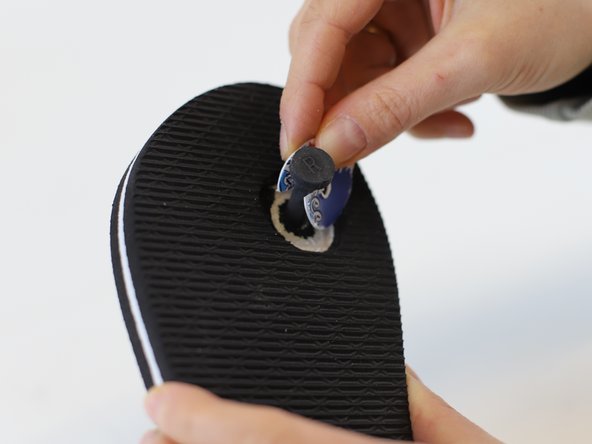

  10. How to Repair a Flipflop Strap, Glue the washer in place: crwdns2935265:010crwdnd2935265:01crwdnd2935265:03crwdne2935265:0 How to Repair a Flipflop Strap, Glue the washer in place: crwdns2935265:010crwdnd2935265:02crwdnd2935265:03crwdne2935265:0 How to Repair a Flipflop Strap, Glue the washer in place: crwdns2935265:010crwdnd2935265:03crwdnd2935265:03crwdne2935265:0
    • Important: choose a general-purpose glue which is fast setting, and suitable for plastic and foam.
    • Apply a thin layer of glue around the inside of the hole in the bottom of the flipflop
    • Bend the plastic washer to clip around the strap
    • Push the plastic washer down onto the glue with medium pressure.

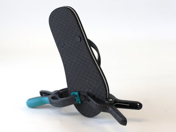

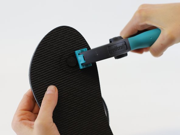

  12. How to Repair a Flipflop Strap, Leave the glue to dry: crwdns2935265:012crwdnd2935265:01crwdnd2935265:03crwdne2935265:0 How to Repair a Flipflop Strap, Leave the glue to dry: crwdns2935265:012crwdnd2935265:02crwdnd2935265:03crwdne2935265:0 How to Repair a Flipflop Strap, Leave the glue to dry: crwdns2935265:012crwdnd2935265:03crwdnd2935265:03crwdne2935265:0
    • The glue now needs to dry. First, pull the strap in the direction of the red arrow, to make sure the disc and washer are pulled tightly in place.
    • Next, we suggest using some simple craft clips to hold the repair in place while it dries
    • Leave for the time shown on the glue packet before removing the clips
