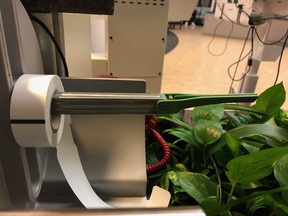

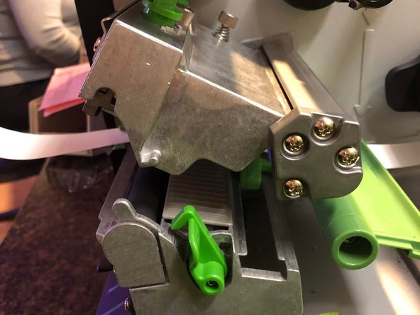

    • Open the machine by lifting the right side up.

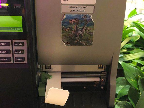

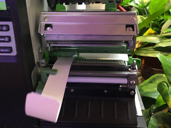

    • Assess where the problem is within the machine. Press the green button that says "push" to release the end of the armband that is clamped in the machine.
  3. How to Repair a Fastmark by AMT Datasouth Wristband Printer: crwdns2935265:03crwdnd2935265:01crwdnd2935265:03crwdne2935265:0 How to Repair a Fastmark by AMT Datasouth Wristband Printer: crwdns2935265:03crwdnd2935265:02crwdnd2935265:03crwdne2935265:0 How to Repair a Fastmark by AMT Datasouth Wristband Printer: crwdns2935265:03crwdnd2935265:03crwdnd2935265:03crwdne2935265:0

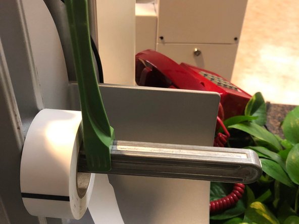

    • Slide the green bar to the right then pull it down to remove the roll of armbands.
  4. How to Repair a Fastmark by AMT Datasouth Wristband Printer: crwdns2935265:04crwdnd2935265:01crwdnd2935265:01crwdne2935265:0

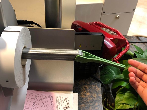

    • Remove the armband strip from under the press.
  5. How to Repair a Fastmark by AMT Datasouth Wristband Printer: crwdns2935265:05crwdnd2935265:01crwdnd2935265:03crwdne2935265:0 How to Repair a Fastmark by AMT Datasouth Wristband Printer: crwdns2935265:05crwdnd2935265:02crwdnd2935265:03crwdne2935265:0 How to Repair a Fastmark by AMT Datasouth Wristband Printer: crwdns2935265:05crwdnd2935265:03crwdnd2935265:03crwdne2935265:0

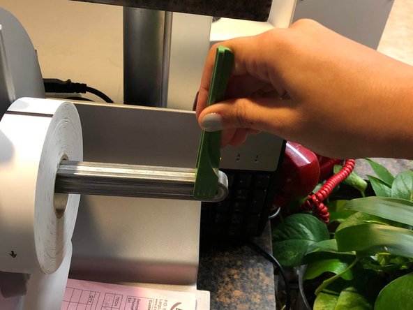

    • Replace the previous armband roll if it's damaged and insert a new roll by sliding it onto the device and pushing the green bar back into place.
  6. How to Repair a Fastmark by AMT Datasouth Wristband Printer: crwdns2935265:06crwdnd2935265:01crwdnd2935265:03crwdne2935265:0 How to Repair a Fastmark by AMT Datasouth Wristband Printer: crwdns2935265:06crwdnd2935265:02crwdnd2935265:03crwdne2935265:0 How to Repair a Fastmark by AMT Datasouth Wristband Printer: crwdns2935265:06crwdnd2935265:03crwdnd2935265:03crwdne2935265:0
    • Weave the new armband strip under the back and green cylinder and through the press. Close the press by pushing it down firmly.

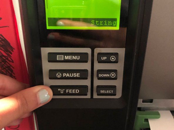

  7. How to Repair a Fastmark by AMT Datasouth Wristband Printer: crwdns2935265:07crwdnd2935265:01crwdnd2935265:03crwdne2935265:0 How to Repair a Fastmark by AMT Datasouth Wristband Printer: crwdns2935265:07crwdnd2935265:02crwdnd2935265:03crwdne2935265:0 How to Repair a Fastmark by AMT Datasouth Wristband Printer: crwdns2935265:07crwdnd2935265:03crwdnd2935265:03crwdne2935265:0
    • Close the top of the armband machine and then press the feed button on the outside to make sure it is working correctly.
Repeat these steps if the text is not lined up in the correct place on the armband.
