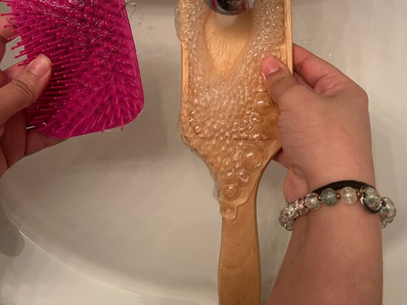

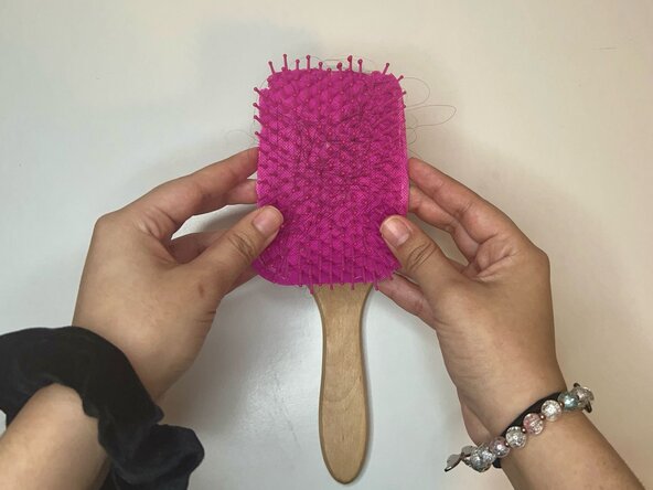

    • Remove the bristle pad completely from the hairbrush.

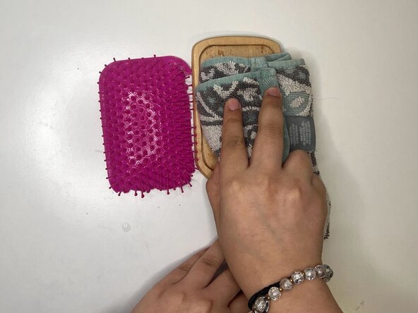

  3. How to Repair a Detached Hairbrush Bristle Pad: crwdns2935265:03crwdnd2935265:01crwdnd2935265:02crwdne2935265:0 How to Repair a Detached Hairbrush Bristle Pad: crwdns2935265:03crwdnd2935265:02crwdnd2935265:02crwdne2935265:0
    • Pat the brush dry using a cloth or a paper towel.
    • Wait until the bristle pad and brush are completely dry before moving on.

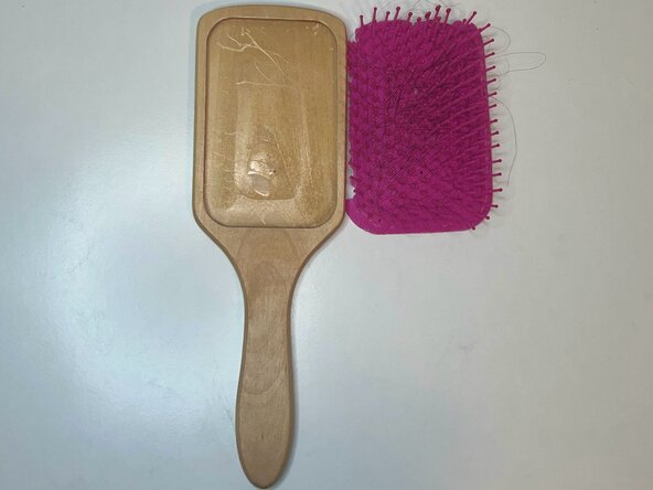

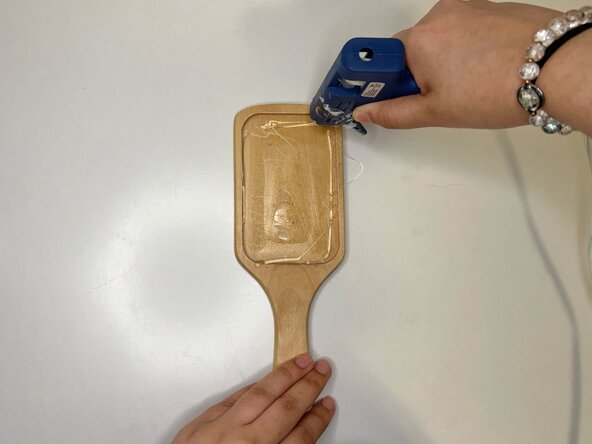

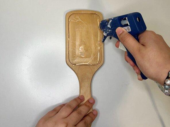

  4. How to Repair a Detached Hairbrush Bristle Pad: crwdns2935265:04crwdnd2935265:01crwdnd2935265:03crwdne2935265:0 How to Repair a Detached Hairbrush Bristle Pad: crwdns2935265:04crwdnd2935265:02crwdnd2935265:03crwdne2935265:0 How to Repair a Detached Hairbrush Bristle Pad: crwdns2935265:04crwdnd2935265:03crwdnd2935265:03crwdne2935265:0
    • Use a hot glue gun or superglue to apply a thin, even layer around the edges of the brush base where the pad originally sat.

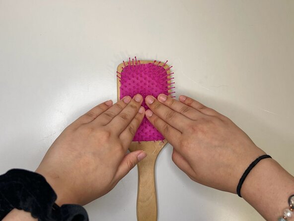

  5. How to Repair a Detached Hairbrush Bristle Pad: crwdns2935265:05crwdnd2935265:01crwdnd2935265:02crwdne2935265:0 How to Repair a Detached Hairbrush Bristle Pad: crwdns2935265:05crwdnd2935265:02crwdnd2935265:02crwdne2935265:0
    • Carefully align the bristle pad with the brush base, and firmly press it down, ensuring the glue spreads evenly and bonds the pad to the base.
  6. How to Repair a Detached Hairbrush Bristle Pad: crwdns2935265:06crwdnd2935265:01crwdnd2935265:01crwdne2935265:0
    • Wipe away any excess glue.

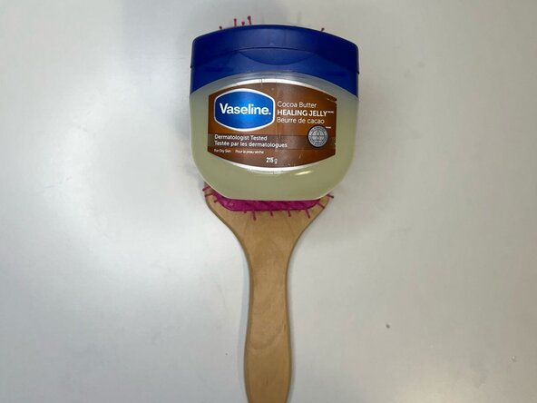

  7. How to Repair a Detached Hairbrush Bristle Pad: crwdns2935265:07crwdnd2935265:01crwdnd2935265:02crwdne2935265:0 How to Repair a Detached Hairbrush Bristle Pad: crwdns2935265:07crwdnd2935265:02crwdnd2935265:02crwdne2935265:0
    • Leave a weight on top of the bristle side of the hairbrush to allow a good seal while the glue dries. Ensure the weight is light enough that it does not bend the bristles out of shape.
    • Leave the weight on as long as it takes for the glue to dry.
    • Allow the glue to dry completely before using your brush again. Drying times can vary between glue products. While hot glue dries relatively quickly, it can still take 24-48 hours to fully cure.
