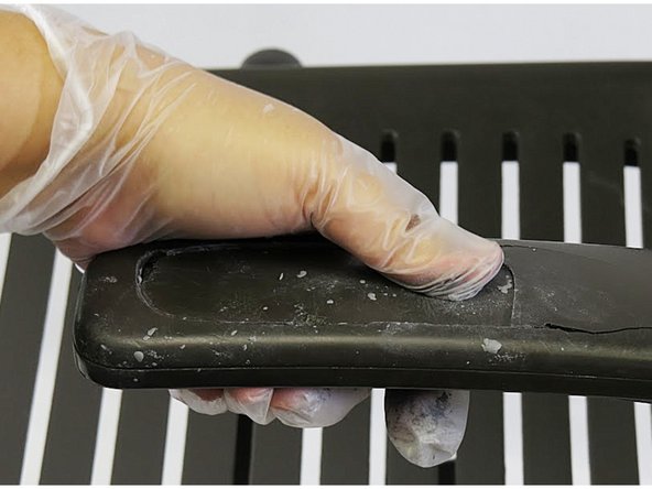

  2. How to Repair a Damaged Steelcase Cachet Chair Armrest: crwdns2935265:02crwdnd2935265:01crwdnd2935265:02crwdne2935265:0 How to Repair a Damaged Steelcase Cachet Chair Armrest: crwdns2935265:02crwdnd2935265:02crwdnd2935265:02crwdne2935265:0
    • Use sandpaper to lightly sand the edges of the broken piece of arm rest.
    • Remove any remaining debris from the armrest.

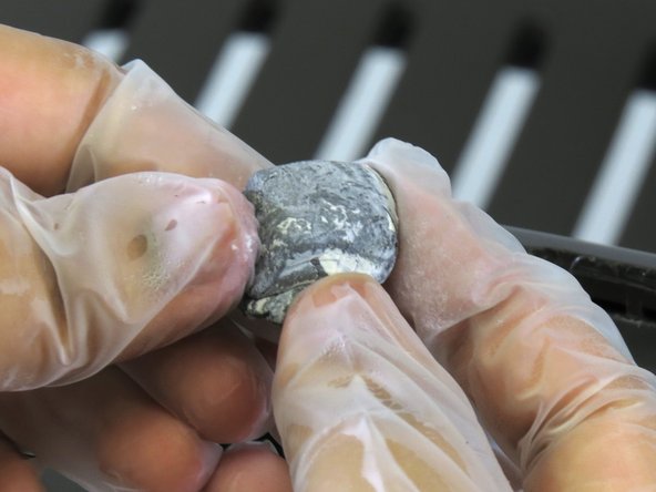

  3. How to Repair a Damaged Steelcase Cachet Chair Armrest: crwdns2935265:03crwdnd2935265:01crwdnd2935265:02crwdne2935265:0 How to Repair a Damaged Steelcase Cachet Chair Armrest: crwdns2935265:03crwdnd2935265:02crwdnd2935265:02crwdne2935265:0
    • Wear gloves! The putty is toxic!
    • Cut or pull off a small section of putty.
    • Knead the putty in your hands for 30-60 seconds until it is a uniform color.

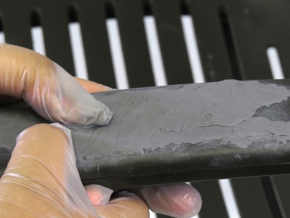

  8. How to Repair a Damaged Steelcase Cachet Chair Armrest: crwdns2935265:08crwdnd2935265:01crwdnd2935265:02crwdne2935265:0 How to Repair a Damaged Steelcase Cachet Chair Armrest: crwdns2935265:08crwdnd2935265:02crwdnd2935265:02crwdne2935265:0
    • Sand down the putty covering to make the surface smooth and level with the armrest.
    • Paint-match the color of the chair and paint over the putty for a cosmetically seamless result.
