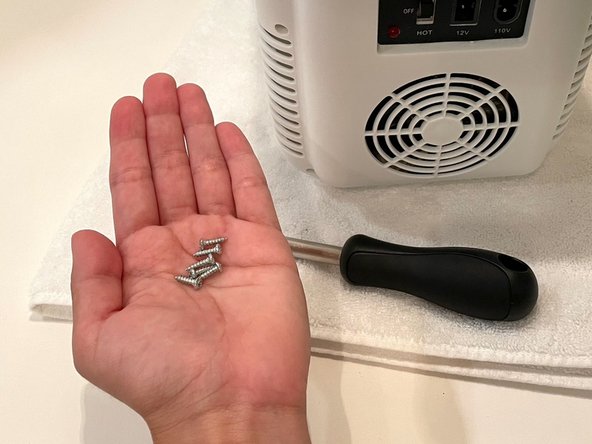

    • Use a Phillips #000 screwdriver to remove the six 4 mm screws from the plastic back cover of the refrigerator.
    • Gently move the cover away from the back of the refrigerator once all of the screws are removed.

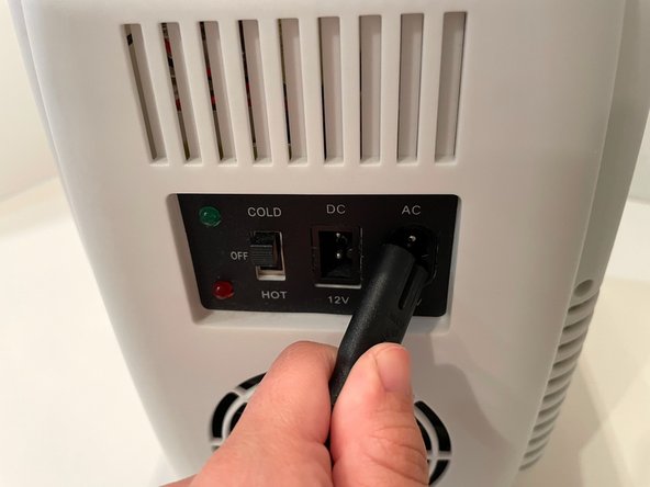

    • Put the removable tray and basket back into the refrigerator.
    • Plug your refrigerator into an external power source.
    • Place your products back into the refrigerator.
