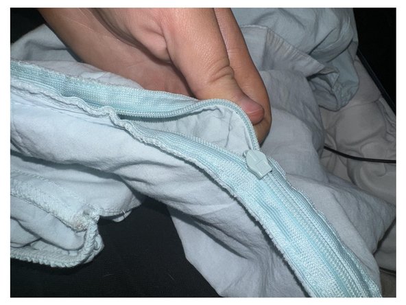

    • Look at the zipper to check if the fabric is stuck in the track or if the zipper is the problem before you begin the fix.
  2. How to Repair a Broken Zipper With Soap: crwdns2935265:02crwdnd2935265:01crwdnd2935265:01crwdne2935265:0
    • Try to zip the zipper.
    • The fabric may block the zipper but it's worth a try. Sometimes, a final attempt will fix the issue.
    • Once you confirm it does not zip, proceed to the next step.
  3. How to Repair a Broken Zipper With Soap: crwdns2935265:03crwdnd2935265:01crwdnd2935265:02crwdne2935265:0 How to Repair a Broken Zipper With Soap: crwdns2935265:03crwdnd2935265:02crwdnd2935265:02crwdne2935265:0
    • Slide the zipper down to its base or the starting point of the zipper track.
    • Avoid forcing the zipper past the point where it's stuck, as this may make restoring full functionality more challenging.
    • Pull both sides of the fabric sides away from the zipper track.
    • This will ensure no fabric is near the track. Pulling the fabric away may restore functionality if it has gotten stuck in the track. You may need a friend for this so you can work on the zipper in the next step.
  4. How to Repair a Broken Zipper With Soap: crwdns2935265:04crwdnd2935265:01crwdnd2935265:01crwdne2935265:0
    • Hold the sides of the fabric to pull it away from the midline of the zipper track and try to zip the zipper again.
  5. How to Repair a Broken Zipper With Soap: crwdns2935265:05crwdnd2935265:01crwdnd2935265:01crwdne2935265:0
    • Here is where our mission splits into two.
    • If you know the zipper is getting caught, keep working it until it doesn't get stuck.
    • If the side fabric is fine after you move it, then the issue is with the zipper.
    • Check the track and nearby areas for any flaws. Look for scuffs and skewed zippers.
    • This may show the problem with the zipper track.
  6. How to Repair a Broken Zipper With Soap: crwdns2935265:06crwdnd2935265:01crwdnd2935265:01crwdne2935265:0
    • Return the zipper pull to its starting point without jamming further.
    • Rub the bar of soap on the zipper track that is stuck.
    • You should see quite a bit of soap, but not so much that you can't see the zipper.
  7. How to Repair a Broken Zipper With Soap: crwdns2935265:07crwdnd2935265:01crwdnd2935265:01crwdne2935265:0
    • Begin unzipping and zipping as far as you can.
    • Repeat steps 1-7 if the first time did not work or you have more of the zipper to cover.
    • Once the zipper is moving smoothly up and down the track, clean the zipper if too much soap has accumulated.
