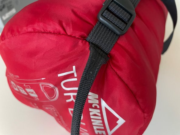

  1. How to Repair a Broken Webbing in a Sleeping Bag, Identify the repair area: crwdns2935265:01crwdnd2935265:01crwdnd2935265:03crwdne2935265:0 How to Repair a Broken Webbing in a Sleeping Bag, Identify the repair area: crwdns2935265:01crwdnd2935265:02crwdnd2935265:03crwdne2935265:0 How to Repair a Broken Webbing in a Sleeping Bag, Identify the repair area: crwdns2935265:01crwdnd2935265:03crwdnd2935265:03crwdne2935265:0
    • Find the location of the tear on your product. In best case, only the seam stitching should be broken, and no additional tears or damage to the webbing of fabric.

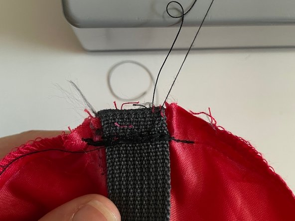

  2. How to Repair a Broken Webbing in a Sleeping Bag, Turn the bag inside-out: crwdns2935265:02crwdnd2935265:01crwdnd2935265:03crwdne2935265:0 How to Repair a Broken Webbing in a Sleeping Bag, Turn the bag inside-out: crwdns2935265:02crwdnd2935265:02crwdnd2935265:03crwdne2935265:0 How to Repair a Broken Webbing in a Sleeping Bag, Turn the bag inside-out: crwdns2935265:02crwdnd2935265:03crwdnd2935265:03crwdne2935265:0
    • Unpack the sleeping bag and set it aside. Turn the carry bag inside-out and inspect the damage from inside. The seam should be clearly visible and there should be no fraying on the fabric or the webbing - if there is, you should carefully trim off frayed edges so long as enough fabric remains to run through the sewing machine later.

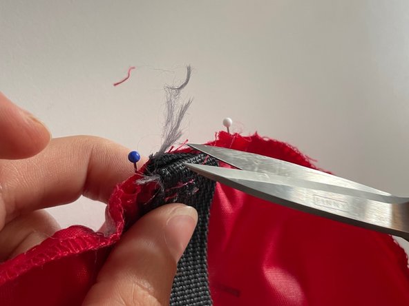

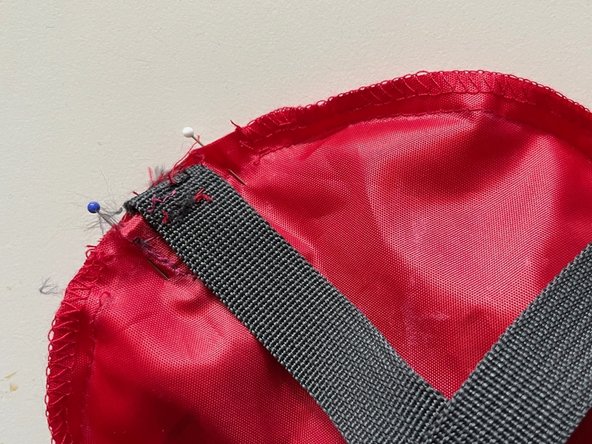

  3. How to Repair a Broken Webbing in a Sleeping Bag, Prepare the seam: crwdns2935265:03crwdnd2935265:01crwdnd2935265:03crwdne2935265:0 How to Repair a Broken Webbing in a Sleeping Bag, Prepare the seam: crwdns2935265:03crwdnd2935265:02crwdnd2935265:03crwdne2935265:0 How to Repair a Broken Webbing in a Sleeping Bag, Prepare the seam: crwdns2935265:03crwdnd2935265:03crwdnd2935265:03crwdne2935265:0
    • Use pins to secure the webbing back into the correct place.
    • Check the other (unbroken) webbing seams for the correct positioning on top or between the seam fabrics. This is unique to each product, so take care to match what you have and not copying the example shown.
    • Trim away any lose threads or fraying.

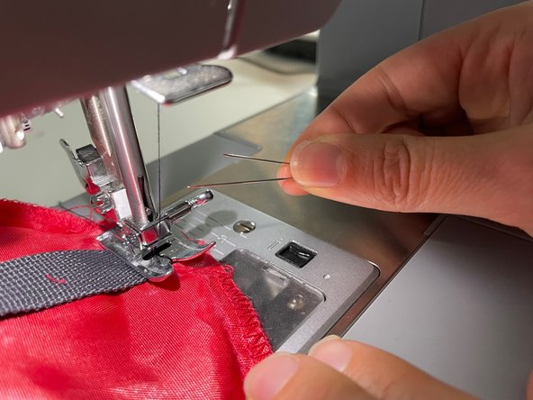

  4. How to Repair a Broken Webbing in a Sleeping Bag, Sewing the Seam: crwdns2935265:04crwdnd2935265:01crwdnd2935265:03crwdne2935265:0 How to Repair a Broken Webbing in a Sleeping Bag, Sewing the Seam: crwdns2935265:04crwdnd2935265:02crwdnd2935265:03crwdne2935265:0 How to Repair a Broken Webbing in a Sleeping Bag, Sewing the Seam: crwdns2935265:04crwdnd2935265:03crwdnd2935265:03crwdne2935265:0
    • Prepare your sewing machine and the area around it. Position the broken seam underneath the foot and pull the foot down.
    • Tip: Remember to remove the pins before starting!
    • Start at one end of the seam and end at the other. Turn the bag around 180 degrees and repeat the process back the other way. Continue to do this until the repair looks to be a similar (or stronger) strength to the original.
    • Lock the repair at both ends with a lock stitch or back stitch. Check the repair and finally cut the thread.

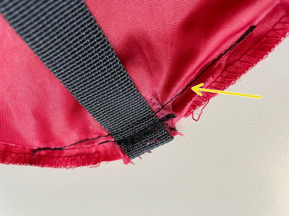

  5. How to Repair a Broken Webbing in a Sleeping Bag, Check the strength of the bag: crwdns2935265:05crwdnd2935265:01crwdnd2935265:02crwdne2935265:0 How to Repair a Broken Webbing in a Sleeping Bag, Check the strength of the bag: crwdns2935265:05crwdnd2935265:02crwdnd2935265:02crwdne2935265:0
    • Check the repair strength by pulling an unbroken strap gently, and then pulling the repaired strap in the same way.
    • When pulling the repaired strap, if it looks weak or strained, repeat step 4 again and add some additional stitching on the sewing machine (yellow arrow).
    • Turn the bag back the correct way, and stuff the sleeping bag back in. If it looks unstrained and strong, you're ready to go!
    • Note: it is normal for the repaired strap to be 5-10mm shorter after the repair, and this may be noticeable when the bag is packed.
