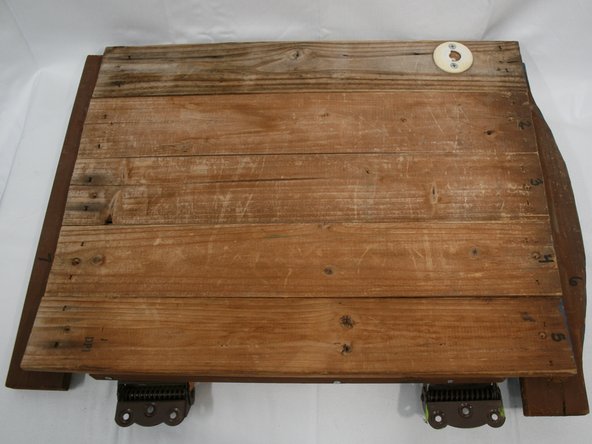

    • Label each piece of wood with a number.
    • The door in this guide has seven panels, so I'll be labeling them 1 through 7.

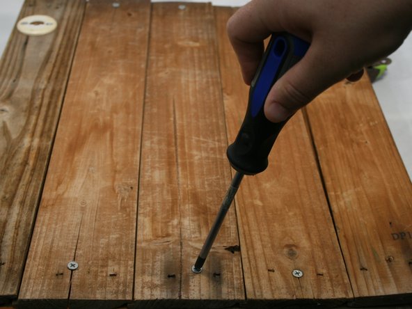

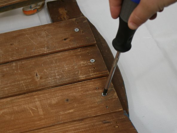

    • Use a Phillips screwdriver to remove all the screws so that each wood panel is separated.

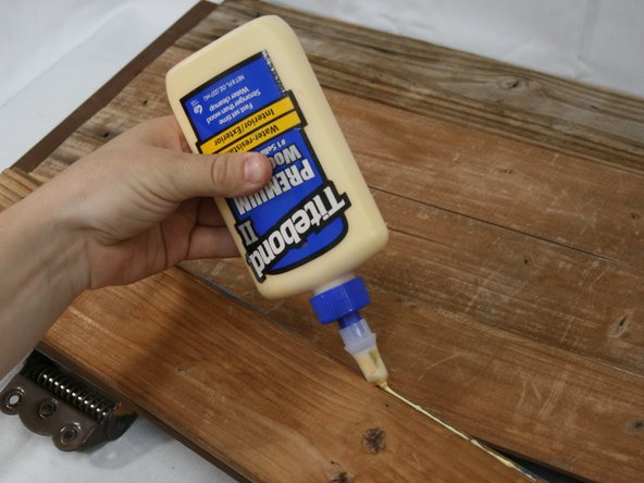

    • Apply wood glue to each panel of wood where it intersects with another piece.
    • You may want to keep a towel or napkin nearby to wipe off any excess glue.

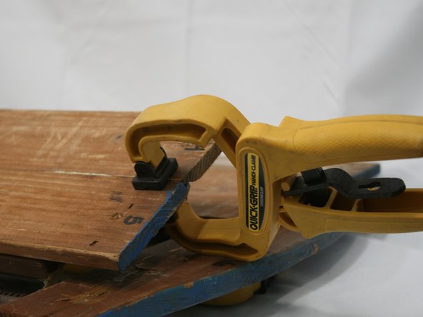

    • Attach clamps to the wood panels where the glue was applied. Place one clamp on each end.
    • It might be easiest to glue and clamp two wood panels together at a time and then attach all the pieces together once the glue dries.
    • Keep the clamps on the wood panels until the glue is completely dry. It takes about 24 hours for the glue to fully cure.
