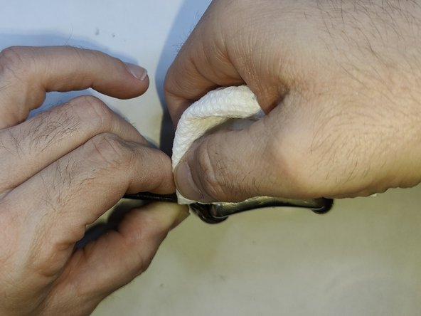

    • CAUTION: Use leather cleaner in a well-ventilated area to avoid breathing in harmful vapors.
    • Use a leather cleaner and a clean cloth to clean surfaces to be joined together.
    • For this step I used a mixture of 1 ounce of vinegar and 1 ounce of water mixed in a bowl for my leather cleaner, but you can use whatever leather cleaner you have available.

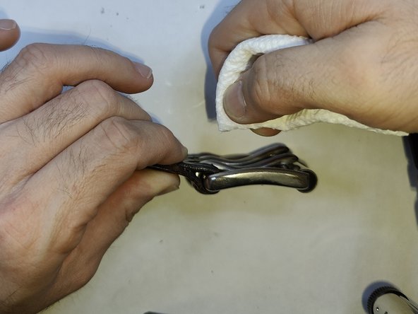

    • Insert prong(s) into pre-cut holes on the main belt strap.
  4. How to Repair a Broken Leather Belt Using Adhesives: crwdns2935265:04crwdnd2935265:01crwdnd2935265:03crwdne2935265:0 How to Repair a Broken Leather Belt Using Adhesives: crwdns2935265:04crwdnd2935265:02crwdnd2935265:03crwdne2935265:0 How to Repair a Broken Leather Belt Using Adhesives: crwdns2935265:04crwdnd2935265:03crwdnd2935265:03crwdne2935265:0
    • Insert the end of the leather belt into the buckle and fold over the bar holding the prong(s) in place.

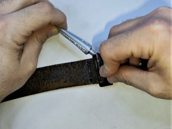

    • WARNING: FLAMMABLE! Do not use adhesives near open flames or other heat sources including sparks as a fire could start.
    • CAUTION: Use adhesives in a well-ventilated area to avoid breathing in harmful vapors.
    • Apply a small amount of your leather adhesive to the leather belt on both sides of the pre-cut holes for the buckle prong(s).
  6. How to Repair a Broken Leather Belt Using Adhesives: crwdns2935265:06crwdnd2935265:01crwdnd2935265:03crwdne2935265:0 How to Repair a Broken Leather Belt Using Adhesives: crwdns2935265:06crwdnd2935265:02crwdnd2935265:03crwdne2935265:0 How to Repair a Broken Leather Belt Using Adhesives: crwdns2935265:06crwdnd2935265:03crwdnd2935265:03crwdne2935265:0
    • Join the main belt strap and the end of the belt strap together where the leather adhesive was applied.
    • Apply light to medium pressure and hold in place for about two (2) minutes.
    • Using a clean cloth, paper towel, or cotton swab, remove any excess adhesive (squeeze-out) from the sides of the joined surfaces.

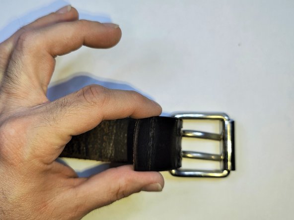

    • Apply a small amount of leather adhesive to both surfaces to be joined on the other side of the keeper loop.
  9. How to Repair a Broken Leather Belt Using Adhesives: crwdns2935265:09crwdnd2935265:01crwdnd2935265:01crwdne2935265:0
    • Join both surfaces together where the leather adhesive was applied.
  10. How to Repair a Broken Leather Belt Using Adhesives: crwdns2935265:010crwdnd2935265:01crwdnd2935265:01crwdne2935265:0
    • Allow leather adhesive to dry (cure) as stated in the directions on the original leather adhesive packaging.
    • For the E6000 adhesive used in this Fast Fix guide, the dry (cure) time is 24 to 72 hours depending on material and air temperature of the work area.
