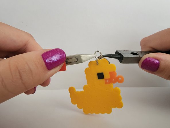

    • Firmly grasp the broken jump ring using one set of small needle-nose pliers.
    • Make sure that the ring's opening is not blocked by the pliers.
  2. How to Repair a Broken Jump Ring: crwdns2935265:02crwdnd2935265:01crwdnd2935265:01crwdne2935265:0
    • Grasp the opposite side of the jump ring with your other pair of small needle noise pliers.
  3. How to Repair a Broken Jump Ring: crwdns2935265:03crwdnd2935265:01crwdnd2935265:01crwdne2935265:0
    • Gently twist the pliers in opposite directions until the gap is wide enough to reattach the jump ring to the ear wire.
  4. How to Repair a Broken Jump Ring: crwdns2935265:04crwdnd2935265:01crwdnd2935265:02crwdne2935265:0 How to Repair a Broken Jump Ring: crwdns2935265:04crwdnd2935265:02crwdnd2935265:02crwdne2935265:0
    • Grasp the ear wire (if applicable) and insert its loop into the opening of the jump ring.
  5. How to Repair a Broken Jump Ring: crwdns2935265:05crwdnd2935265:01crwdnd2935265:02crwdne2935265:0 How to Repair a Broken Jump Ring: crwdns2935265:05crwdnd2935265:02crwdnd2935265:02crwdne2935265:0
    • Insert your earring into the opening of the jump ring.
  6. How to Repair a Broken Jump Ring: crwdns2935265:06crwdnd2935265:01crwdnd2935265:02crwdne2935265:0 How to Repair a Broken Jump Ring: crwdns2935265:06crwdnd2935265:02crwdnd2935265:02crwdne2935265:0
    • Grasp the jump ring between your two pairs of pliers and push/twist the two ends of the ring toward each other, until the two ends meet and the gap is closed.
    • Make sure that the gap is closed tight!
Your earrings are ready to be worn again!
